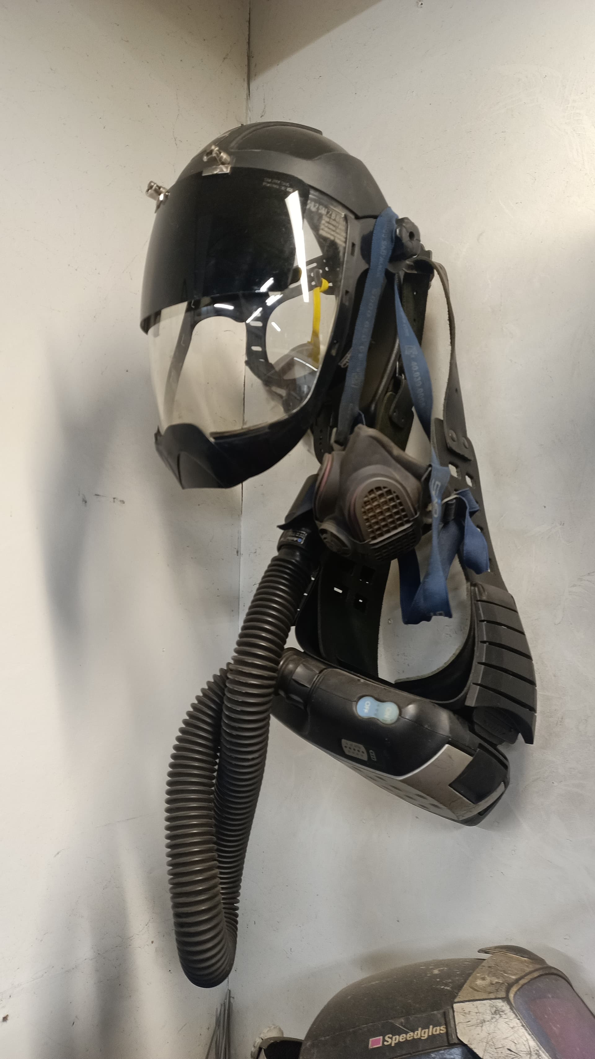

I have a plymovement exhaust fan. I do want to get a teefor it and put in a arm for the welding area. For PPE I normally wear a GVS half mask and then I have a selstrom face shield which I converted in ad flow to dump fresh air into when I’m cutting.

Is this like a PAPR setup? I know that’s the gold standard for really hostile conditions. I can do that if I need to, but was hoping to avoid the need as it would mean I’m essentially nuking the shop for however many hours after I do something nasty. I’d rather not have to wear that while running the VMC or lathe waiting for the air the clear out.

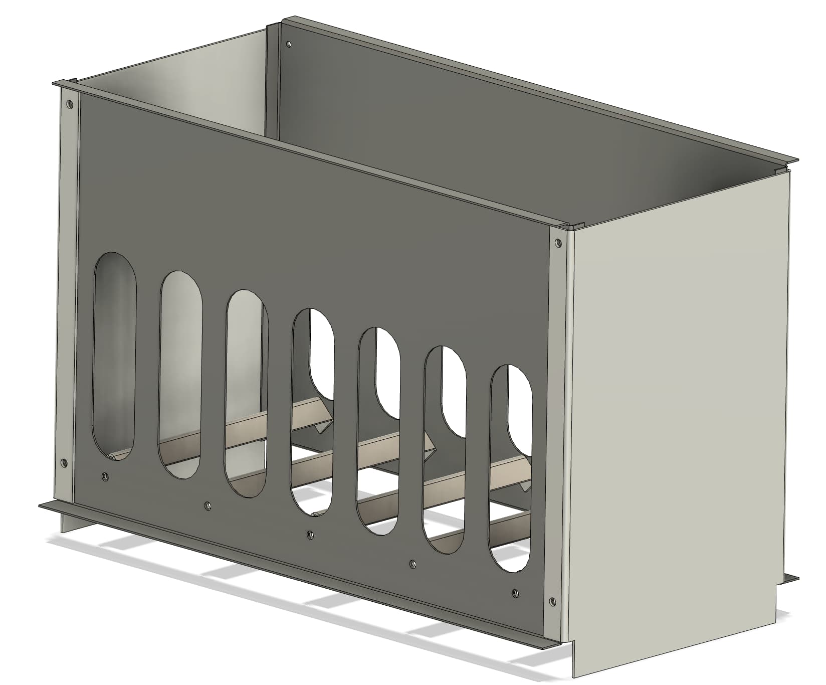

I went and ran the numbers again and I see I got a little confused so my numbers weren’t quite right. This is a project I’m working on right now which I thought would be a good test case. It’s basically a firebox for a barbecue, about 8x17x12" and made out of a mix of 14 and 18 gauge 304. I could probably get away with thinner but it will get beat on so didn’t want to start out too stingy.
Pricing this through SCS I ended up almost exactly $150 shipped. That is just for lasering out the parts. Bends cost about $2.50 each, so if I have them do those the final bill is $215. I went to Metal Supermarket, and to buy two 304 sheets cut roughly to size to make these parts comes out to $142 + S&H.
Now, you are right that there is a cut-size premium in there that is quite large. A 48x96" sheet of each size comes out to $760, and would probably make 10-11 of these, for the cost of five from SCS. So there is leverage in there, but only if you’re buying full sheets. $600 of material (probably $750 in 30 days :face_vomiting:) I don’t need is a decent amount of $ to tie up on the stock shelf unless you know you’re going to use it relatively soon.
What is interesting is how much cost bending adds for SCS. Like many here I’ve been eyeing the 25T since I saw the announcement, and this shopping has me taking a second look at that.
