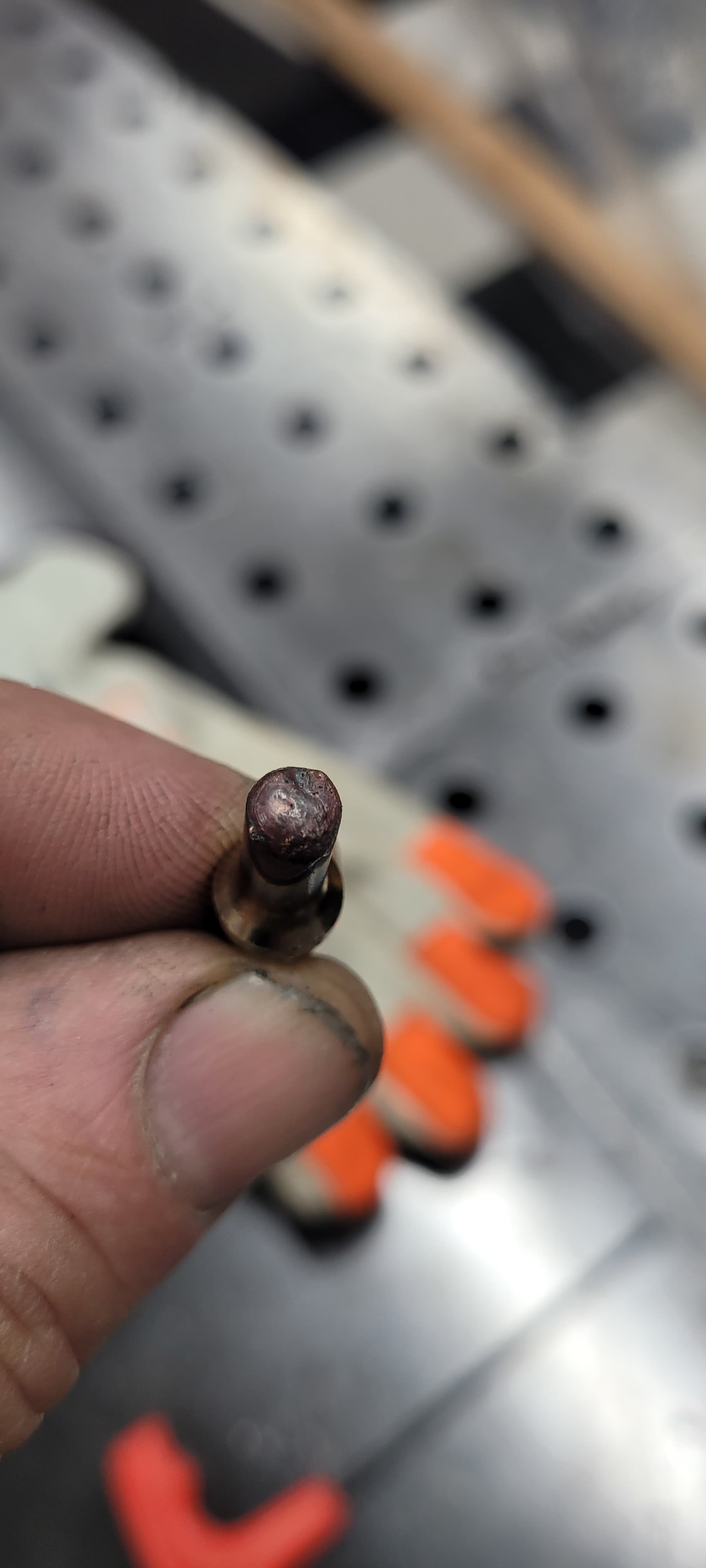

Update: i remived the cover and can hear the relay activating. I unplugged all connections are reconnected. I am able to get the torch to fire now. Something is still wrong, it is eating consumables. I have a piece of 1/4 plate on table, ground for good ground connection, 45 amps on machine with 70psi air. My air is dry. From the 60gal compressor it goes to a moisture seperator then to a refrigerated dryer then about 40ft of pex to an air drop. From the drop it goes to a motorguard filter before entering machine. I removed the motorguard filter and it is dry. In firecontrol i selected straight cut at 3" length, 40ipm, .5 pd. Torch fires but does not go thru material. Only leaves a slight mark on surface of plate. Consumable is welded closed. Live voltage said 30. Any ideas where to troubleshoot next?

,5 seconds is not long enough to pierce 1/4" material. It probably destroyed the electrode and nozzle because of all of the molten metal blowing back into it. 40 IPM is also pretty ambitious for a Razorweld at 45 amps on 1/4" material.
Try that test again with a 1 second pierce delay and 20 IPM.

How does the nozzle look can you take a picture of your nozzle and post it?

Update: Big shout out to George for helping me today. Everything is back to working as it should. I wish i was able to identify the problem but i am u sure of what it was. He had me disconnect and ohm meter the torch fire wires and cnc port connector. Removed the torch consumables and reinstalled. Disconnected the torch to the plasma and reconnected. Somewhere in this was the fix.
