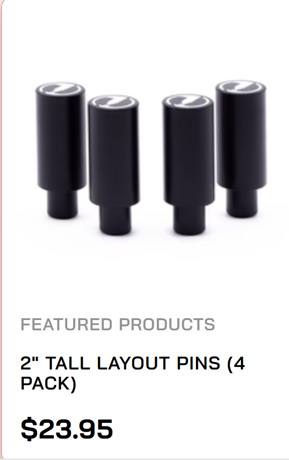

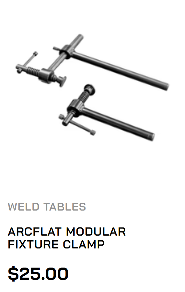

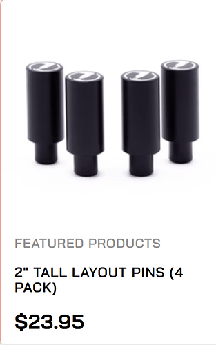

I am planning on ordering a ArcFlat table and a few of the clamps and accessories. I have never used a fixture table before so not exactly sure what all I need. I have a good idea of what I want but there are a couple things I’m not sure about.
What is this item?
Here are some things I have in my cart.
Two of these

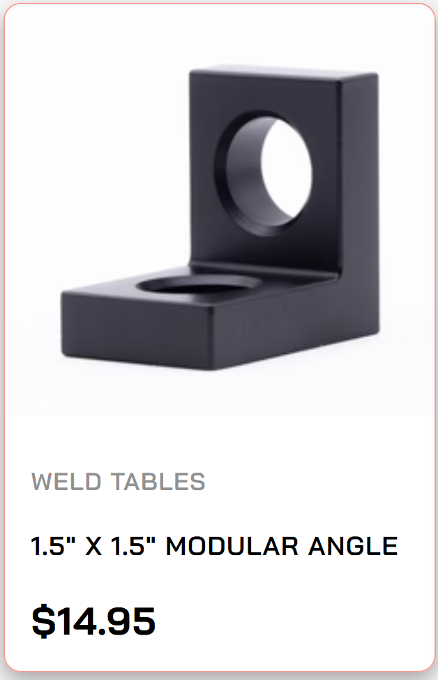

I’m debating on two of these, thinking I might order 4 of the 1.5" x 1.5" units.

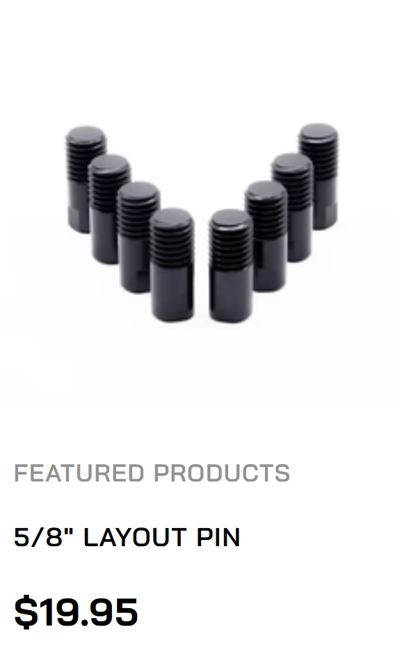

I have one pack each of the 1" and the 2" tall layout pins.
Four of the standard clamps

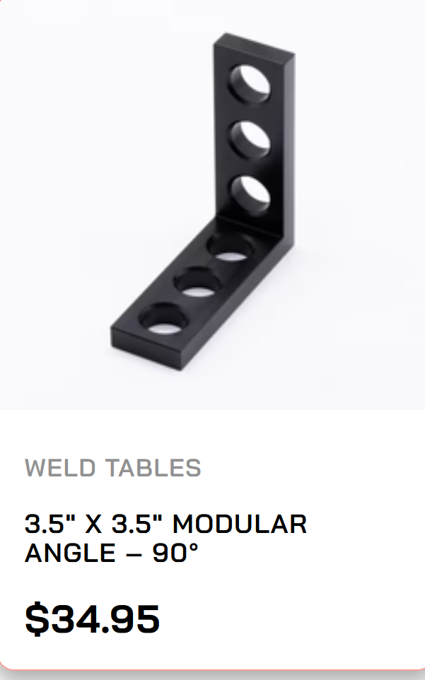

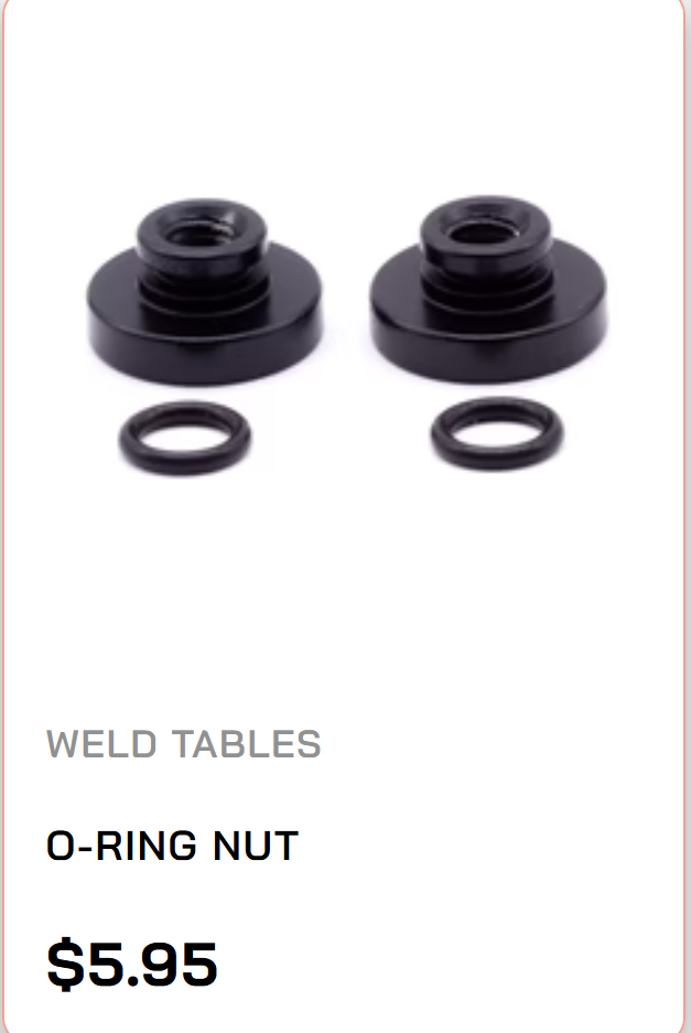

And the way I understand it to use the 90° angle bracket things I needs these two items.
So, what do you think? That a good start don’t ya think?

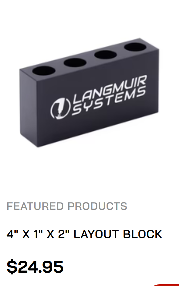

Really the only thing I’m not sure about is the first item I posted, the Layout Block. I currently have two of them in my cart but since I don’t know there use and I never will without having one in my hand. Can someone shed some light on them?

I would go here and watch videos and see how you use some of that stuff.
Here is another one
I will try and get you some pictures of what I use most. But it really depends and what your trying to fixture.
I have stuff I bought and thought I would use at some point and have never used it.
If you are doing this as a hobby, you can do a lot with the just the basics.
If you have pictures of what you make, post them that way people can make suggestions

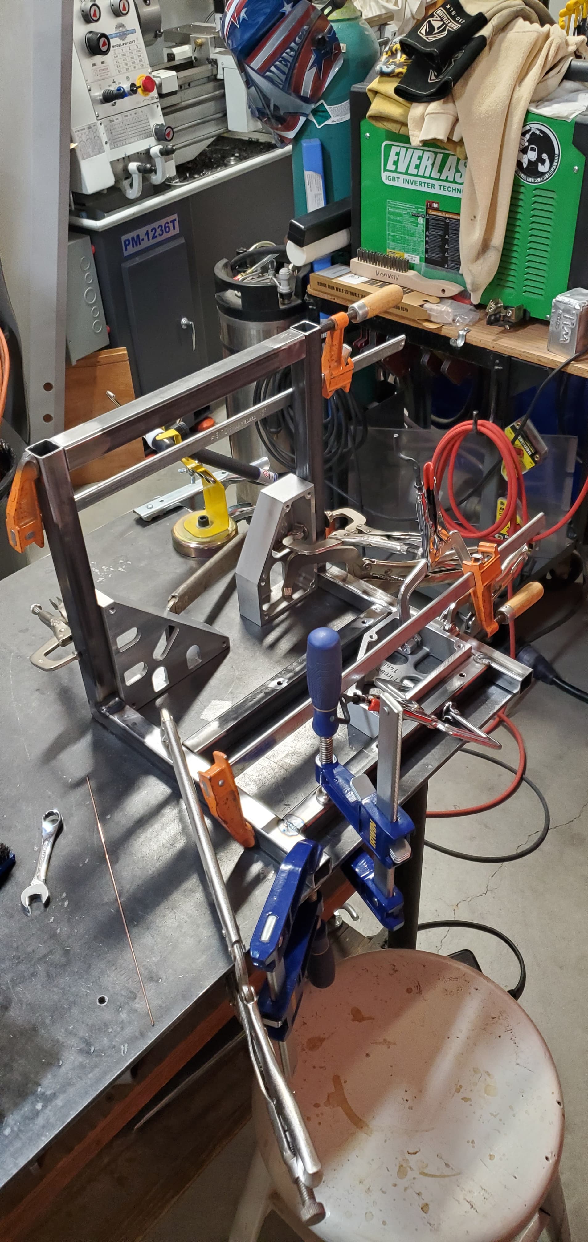

I’m welding a frame for my belt grinder. I have it tacked together now and so far so good. I have so many clamps on it you can’t hardly see the frame, LOL.
Thanks again for the links, they are going to help tremendously. Our internet is down right now so I have watched a couple of them on my phone, not the best. I must not be the only one as the last video I was watching stopped working.
Tacks before welds, and then small (inch or less) welds opposing each other, careful not to be dumping too much heat into the work with each. Heat is your enemy, ironically. Getting things securely clamped will help, but you will still warp the p**s out of stuff if you are too aggressive with the welds and not strategically placing them.
