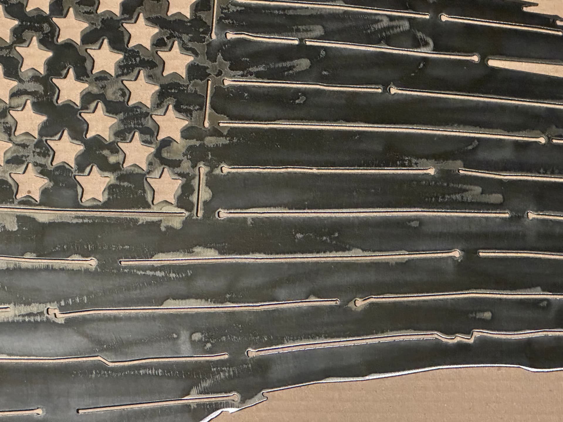

Hey guys! I have to preface this by saying that 99% of the time, I don’t have this issue but today I cut out one of these American Flags from the FireShare page and the pierce hole is like double the size of the line I’m cutting. Any idea how to fix this for the future?

I’m using the Crossfire XR with Razerweld cut 45 cnc set at approx 35amps, air is filtered, New machine torch consumables.
Every cut has an oversized Pierce hole

More information to the above post concerning Pierce hole to big
The “Kerf width” measured on the straight cut is 0.55, same as the tool setting.
The Pierce hole measured at the beginning of the straight cut is 0.126
It’s interesting that you’re also getting a big hole at the end when the torch extinguishes.
try a straight line cut within fire control to see if you get the same results. no thc.
I can’t see anything apparently wrong with the G code that you linked.
I’m wondering if this is a machine issue. When the machine is told to shut off it should just snap off not dwell and create that other mark at the exit. Lazy solenoid? I’m just spitballing
The picture is of a “Straight” cut with Firecontrol. Cut speed > 160, Pierce delay > .5, No THC
The large open hole at top of pic is at the end of the cut
I think this is going to be an issue with the plasma cutter itself. Solenoid ,air regulator. Something that’s not instantly snapping the machine off when the torch is called to shut off

I noticed that after the straight cut, the torch continues to blow air for around 8 seconds. Not sure that it means anything.

One thing that comes to mind would be to check the 2T/4T button on the plasma cutter and see if it’s on 4T.
Set the pierce delay to .3, will give you smaller pierce hole at start.

Overroad my cut settings via firecontrol to:
  • pierce delay to .03 - from .5
  • changed IPM to 70
  • Machine amps to around 40 - from 45
  • verified 2T setting on machine - was set to 2T
Measure the kerf width = .55
These settings got rid of the Pierce hole at the end of the cut!
I’d like to reduce the pierce at the beginning of a cut. I will look into Lead in/out to eliminate the pierce hole.
What’s your pierce height? Maybe it needs to be brought down a bit. The higher the torch is when the pierce occurs the wider the plume will be.
  • Pierce Height = .15
  • Cut Height = .063
Did you verify these settings with a feeler gauge?

I don’t see any lead in on the shapes. A single line will always have a pierce hole.
