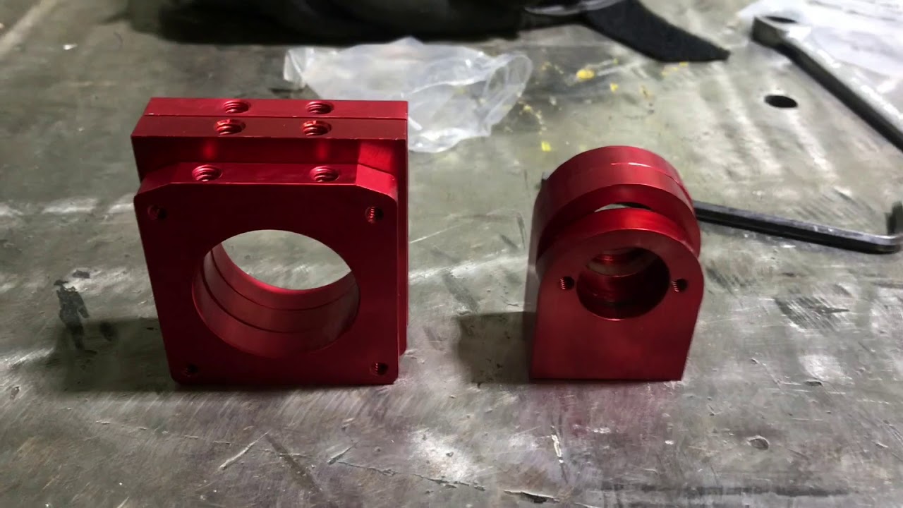

Went back through the adjustment sequence for the side bearing guides. Initially, I had loosened the end plates (stanchions) and the 4 cap screws on each sub-assembly… then loosened the cap scews on the bearing blocks themselves (and loosened the set screws). From that baseline, I would wiggle the assembly up-and-down to observe and hear the clicking of the bearing clearance between the bearings and the rail… slowly tightening the set screw as I moved the assembly until I could just feel the bearings touch on both sides of the rail (and the clicking stopped)… then backed-off the set screws by about 1/4 turn and gently firmed up the cap screws on the bearing holder. Did this for each of the horizontal and vertical blocks.
My objective was to make sure that at least one bearing in each block would roll when the rail was moved along the side tracks, and this technique seemed to work pretty well for that… I didn’t have any “floating bearing blocks” where neither bearing was touching at all, and that seemed to be the objective based on the Languir instructions.
Now, the overall effort to move the Y-axis rail along the two X-axis rails now seems a bit stiff. It DEFINITELY does not just coast along easily… and also can not be moved gently with a finger or two of pressure. It takes a steady hand pressure to get it moving and will come to a stop immediately when force is removed. It doesn’t feel “stuck”… but it doesn’t feel buttery-smooth and effortless either.
Is there any rule-of-thumb for how much drag is acceptable? I realize that the idea is to strike a balance between leaving backlash in the bearings (which can lead to cutting errors) and making it so stiff that the motors are really struggling to move the rail foward and back.
Any tips on this part?
Thanks!
-TM
You want it to move freely, the motors will bind up and stall if there is too much resistance. You probably noticed that the bearing blocks get tighter when you tighten down the bolts. You have to leave the set screw a bit looser than you want, because the bearing block will tighten up when you tighten down the Red block.

I appreciate the suggestions and it seems to be working better now… but I need to go back and re-do the bearing adjustments because it appears that I have them WAAAY too tight currently.

There was enough adjustment in the brackets to move them over as everyone suggested. It worked fine after that. I also went back and loosened up my adjustments on the gantry bearing blocks which were set too tightly… everything has smooth movement and complete travel now.
