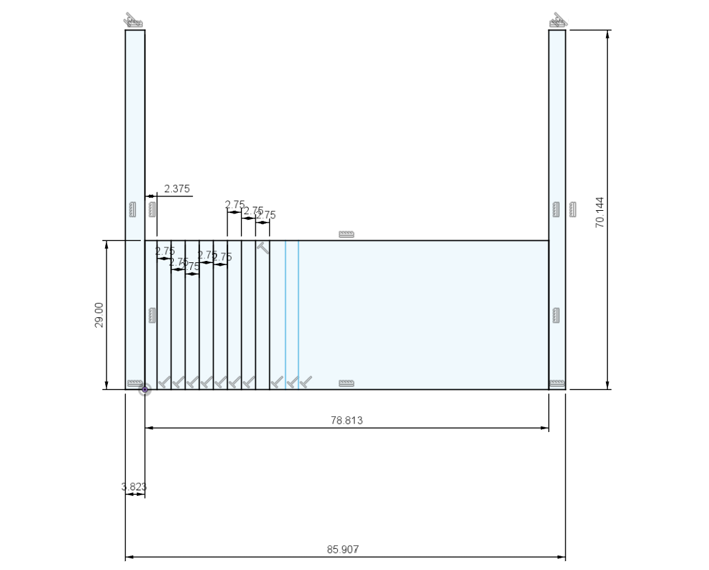

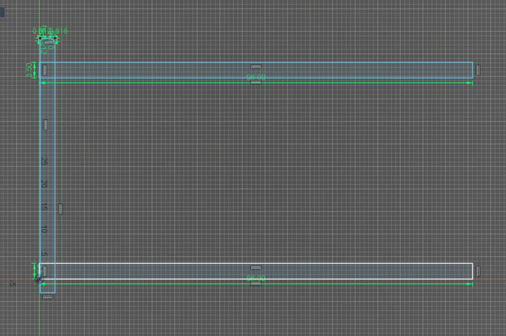

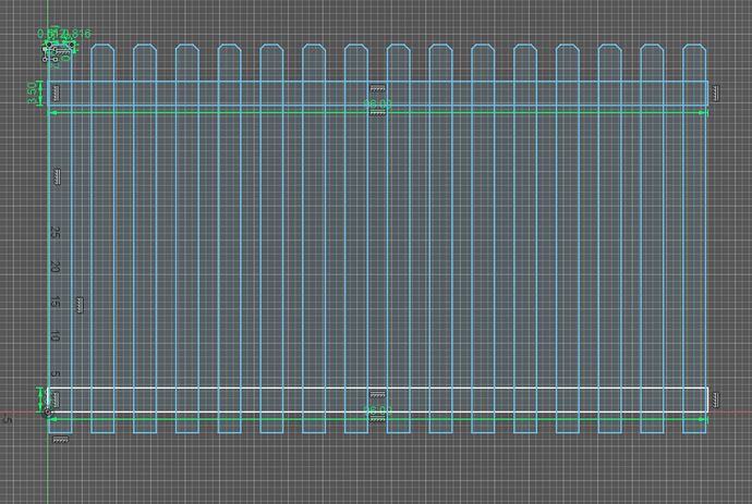

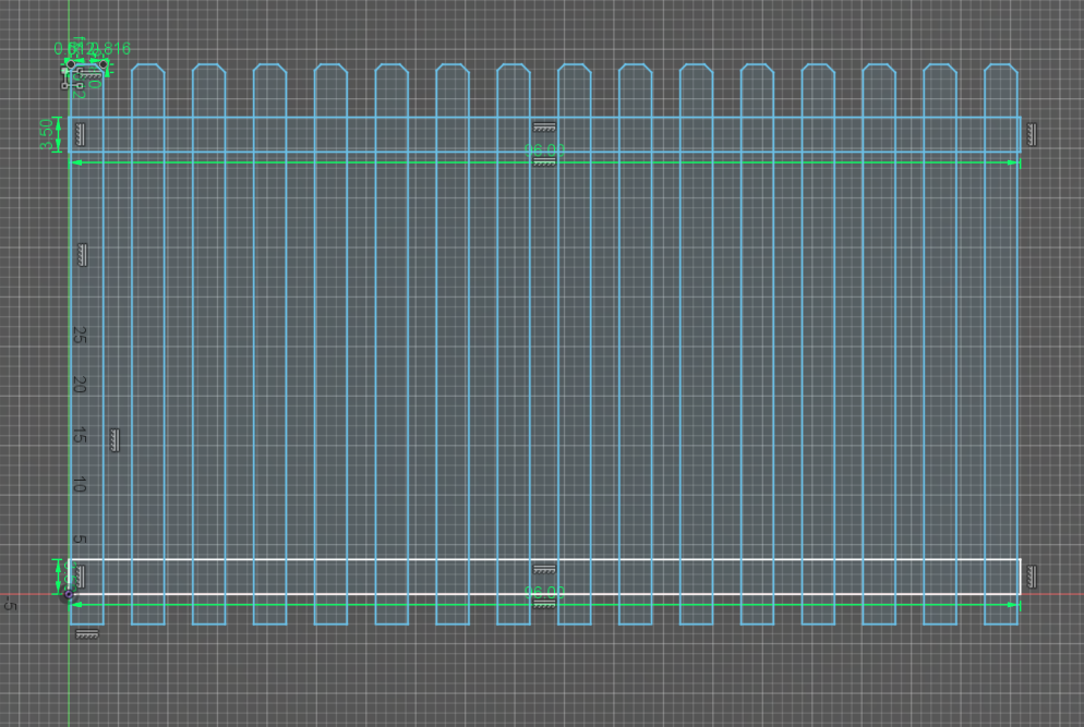

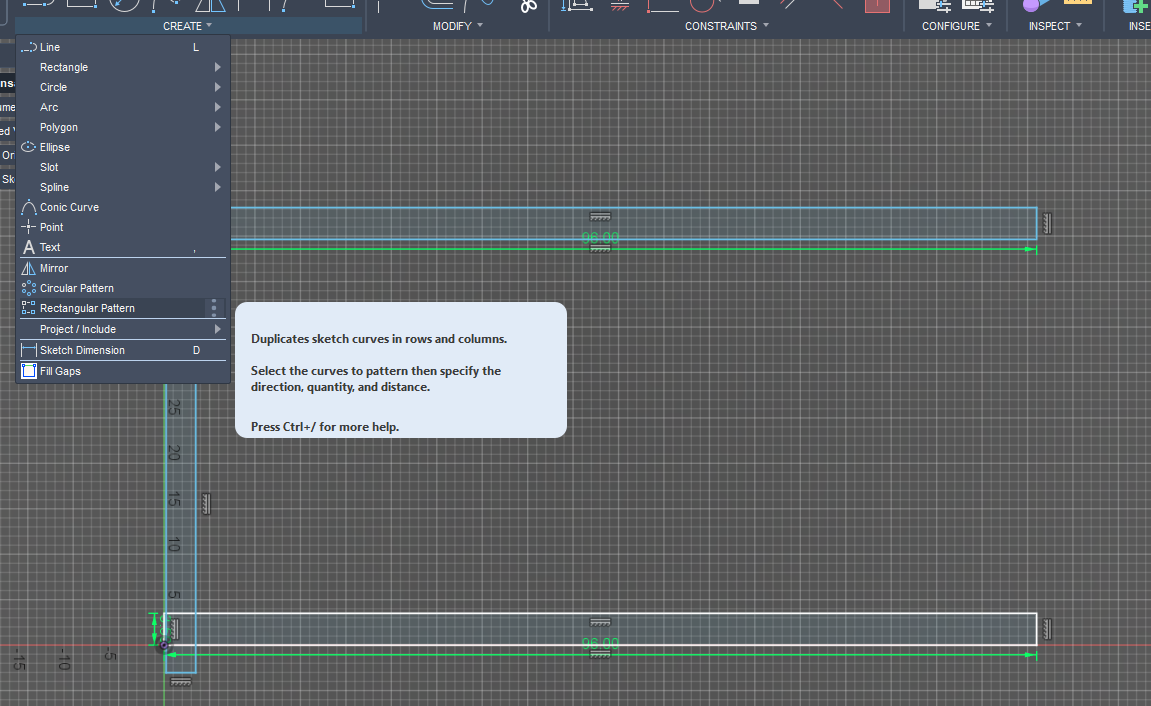

Does anyone have a quick way to lay out pickets in fusion 360? I like to create 3d models of my jobs for shop drawings. I have not found an efficient way to set pickets spacing quickly. Currently I am manually dimensioning each picket which is very slow. Sometimes I will set a center point and mirror them but its not always super quick. I also sometimes pattern on path after its all extruded but that seems wonky sometimes too. Any help is greaty appreciated!

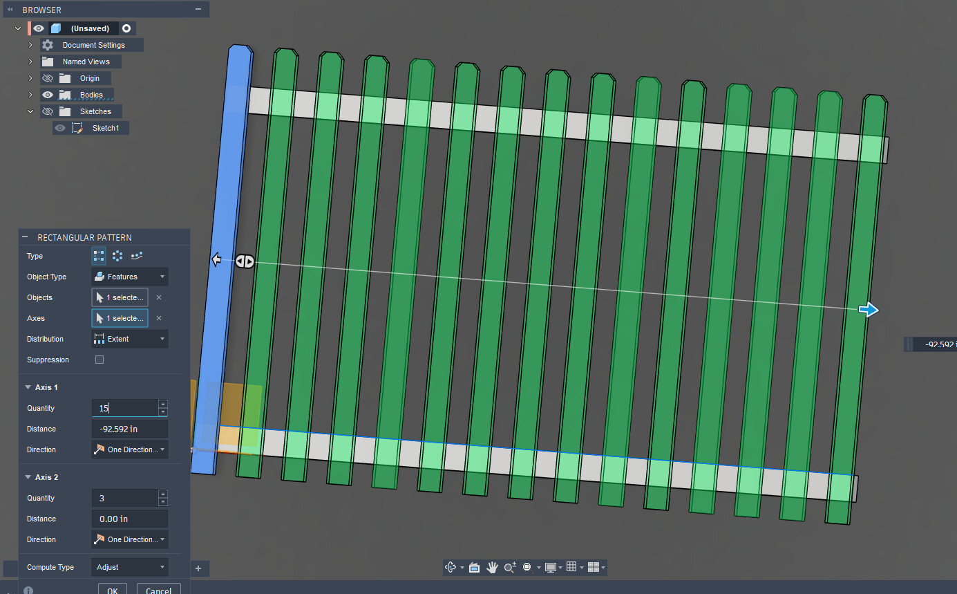

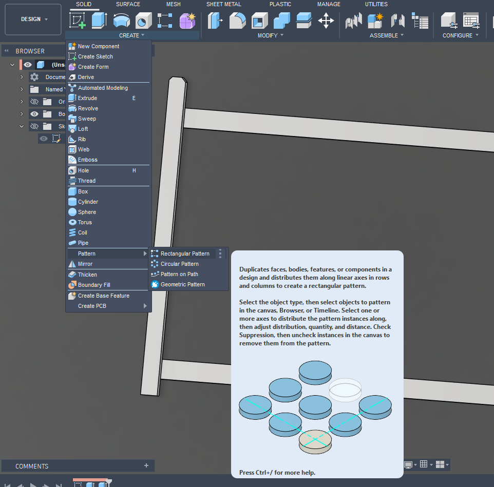

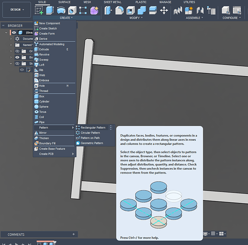

Use “Rectangular Pattern”

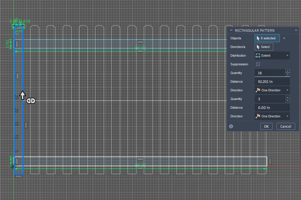

Pick “Rectangular Pattern”. Double click or hold down shift while selecting multiple items:

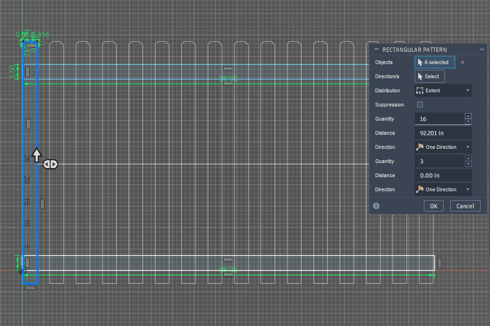

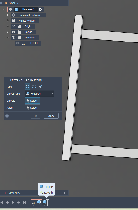

Now stretch out the pattern or determine the spacing, increase the number of instances:
Hit [Enter]

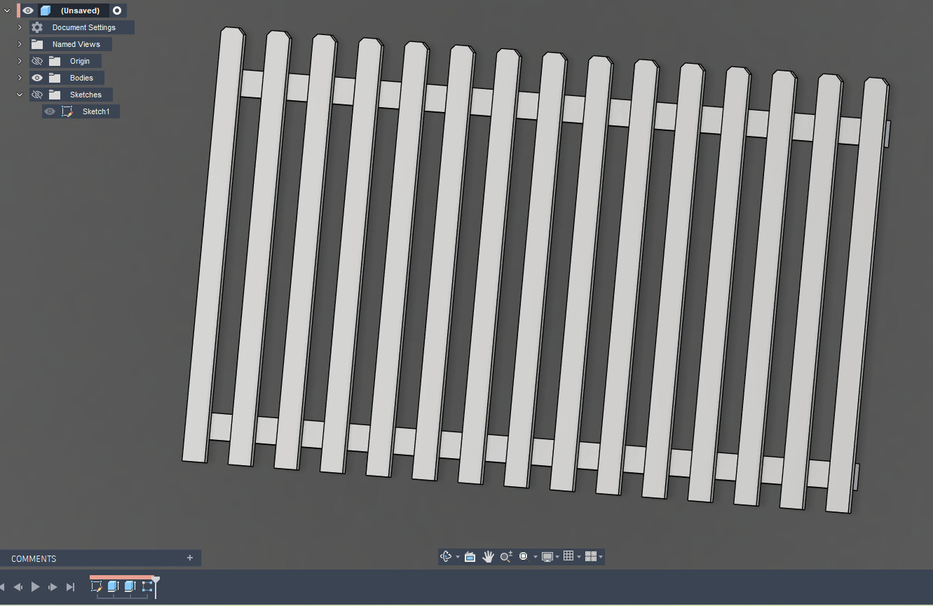

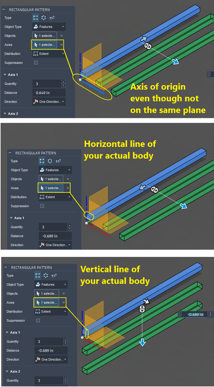

But an even better way is to extrude your first pieces, then copy with the rectangular pattern a feature from the timeline or a body:
That was extremely helpful. thank you!
Keep in mind that in both examples I used, they will ask for your axes. This is where Fusion is very tolerant. It will allow you to pick any straight line in you sketch or on the body or any of the axes lines of the origin even when your sketch or body does not lie in the one of the planes of the origin. Fusion will even allow you to pick construction lines.

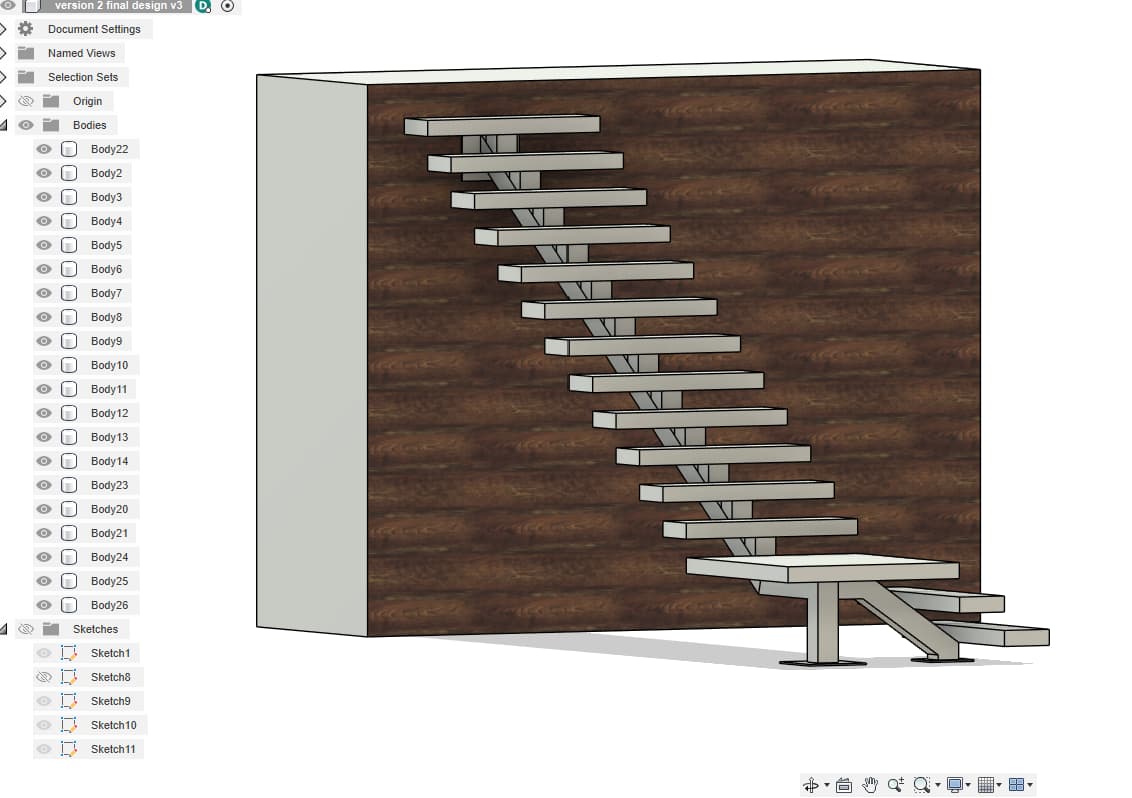

Very cool rendering with the stairs!
I just so happened to have a customer stop in last night to pay me and he told me the constraints were screwing my drawings up. He a wizard with Solidworks and mentioned the coincidece is why i cant snap lines from drawing to drawing. Its all just the hiccups in being self taught. I use trim all the time. That is really good to know. It seems like the program is full of gremlins but its just my lack of knowledge. Thank you I think they are looking pretty cool. now time to add handrail and bid the damn thing lol. Its for my shop landlord and he likes nice stuff! Lucky to have great customers like that.
