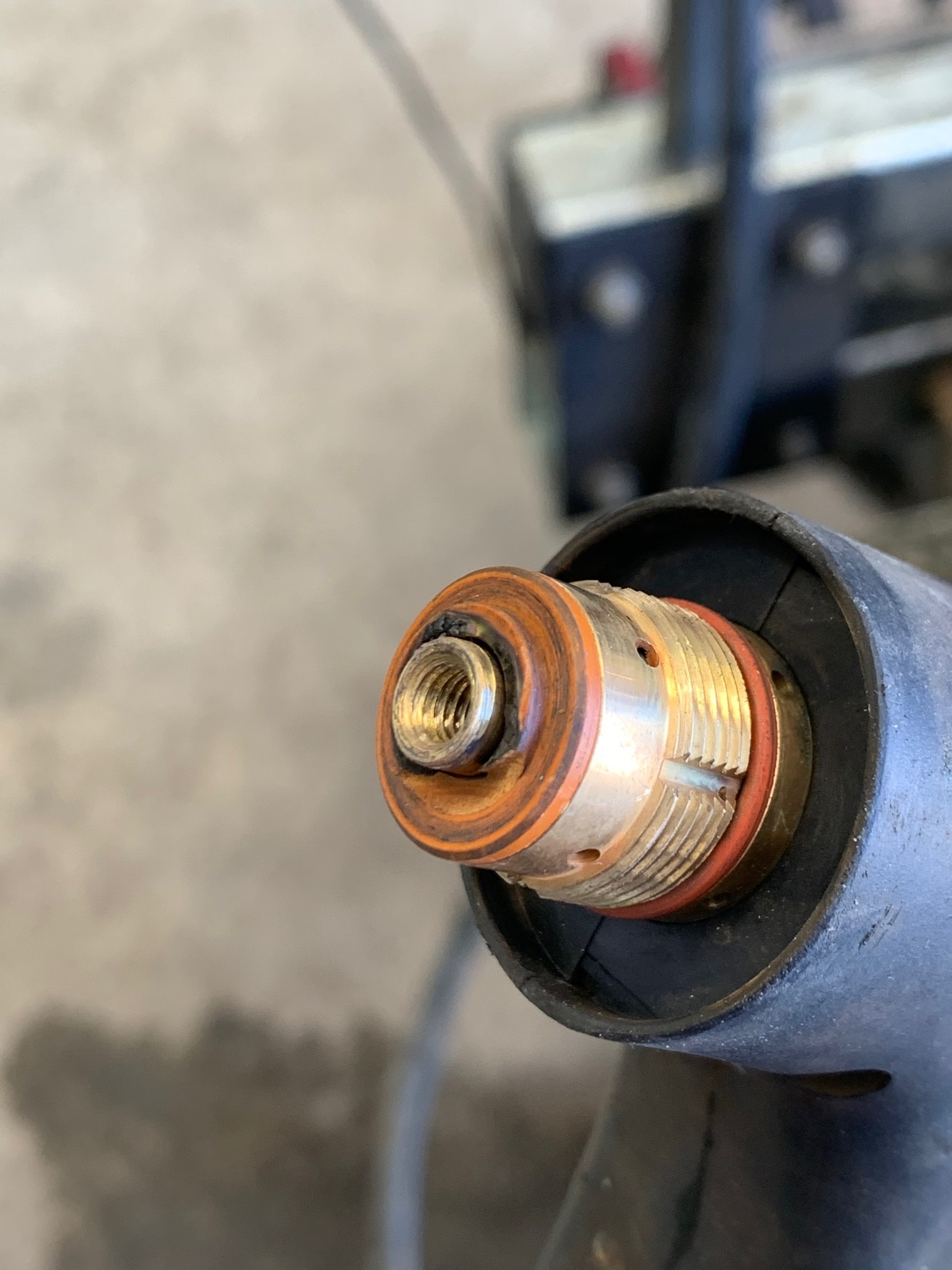

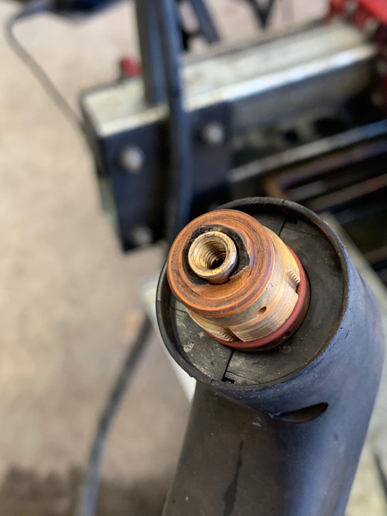

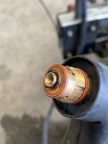

Well the good news I found the reason for the terrible bevel on my cuts lately. When equipment breaks on the ranch, I pull out some diagram and order parts. For the life of me I can’t find a diagram for this torch. Anyone know where to find the plastic piece broken in these photos? Also, where might I find the machine torch to fit my Razorweld 45? I see Langmuir sells the machine torch mount but not the torch. Might be time for that upgrade as well.

First its not a S45 torch. It is a IPT40 torch. You can not repair that, it will need a new torch head.

Thanks for the reply, is it junk or something you can rebuild? Also, do you sell the machine torch for my Razorweld 45?
You can get a new torch head for it.
