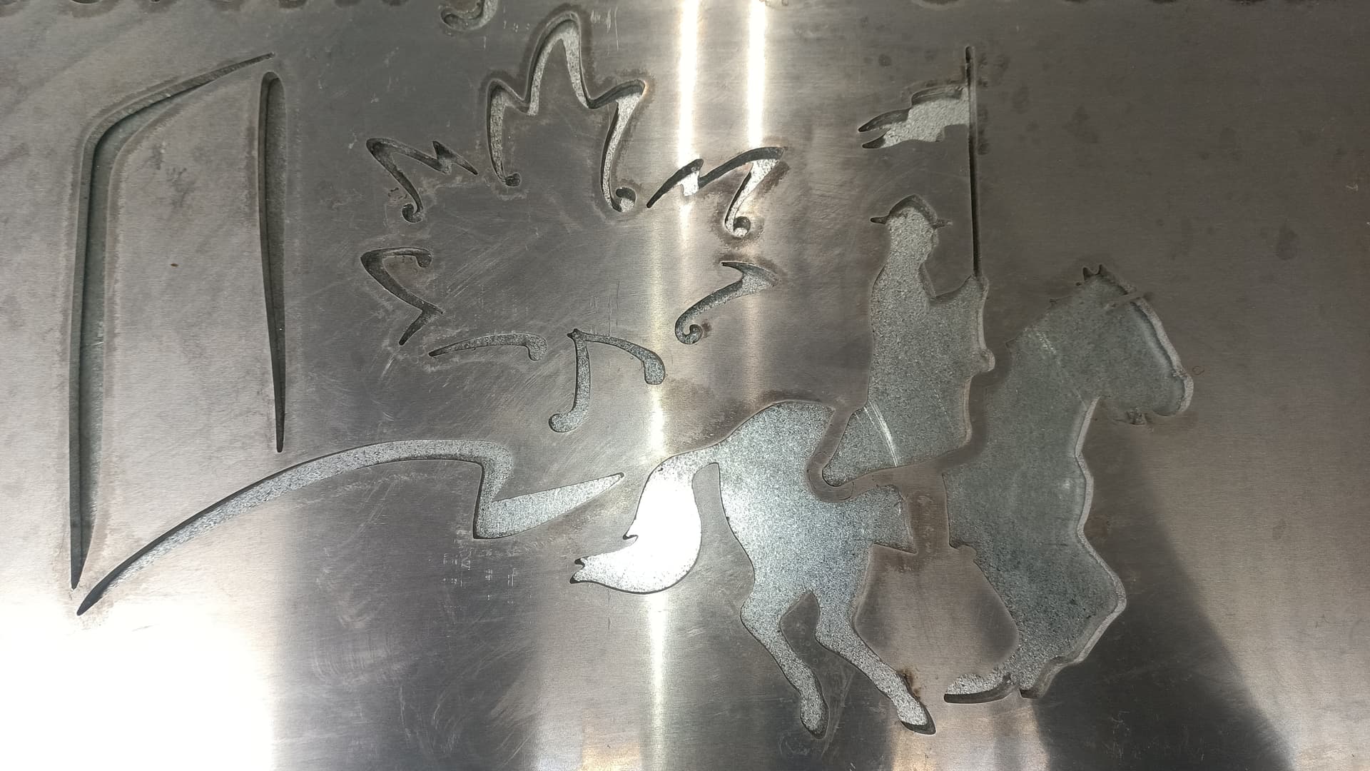

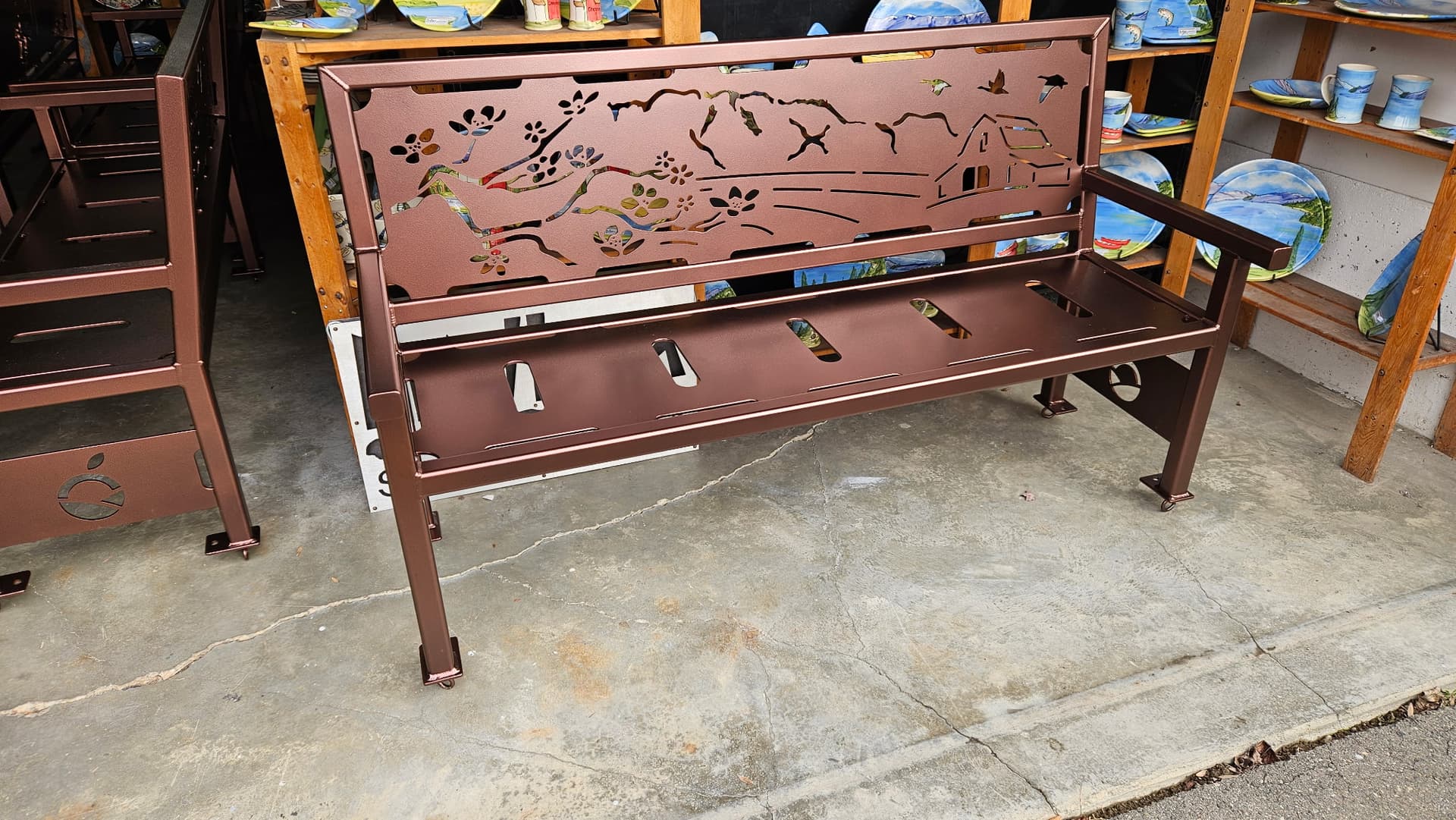

That is a great-looking bench—high-dollar aluminum? Haha, is there a high pucker factor in cutting that backrest scene?
Probably the highest pucker factor you can get to on a langmuir plasma table.

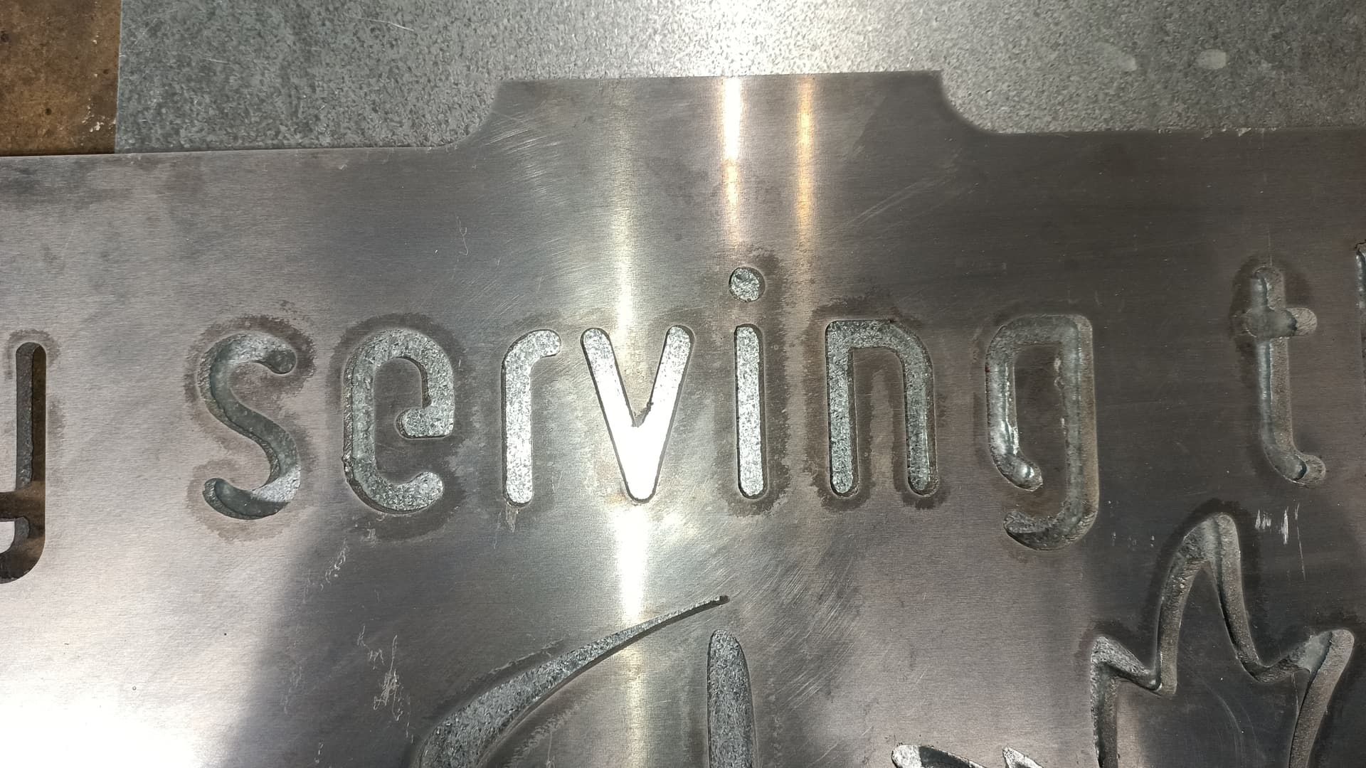

That one panel with the crane was over an hour of cut time with 150 pierces. You had to watch and listen like a hawk because aluminum can foul that consumable so quick. I think I checked the consumable condition 15 times or more during that cut. That one panel to set up cut sand and clean up is just over 3 hours of work. Lol. This project’s coming out a lot better than I expected but I also am going to be happy when it’s done. I’ve cut a lot of quarter inch aluminum before on the XR but these panel cuts gave me an entirely new appreciation.
I know you use a Hypertherm machine, but since I switched to shielded consumables from George for my Everlast, my aluminum cutting has greatly improved. I also use nitrogen for aluminum cutting instead of air.

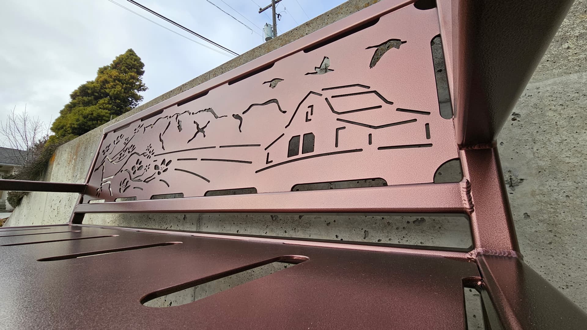

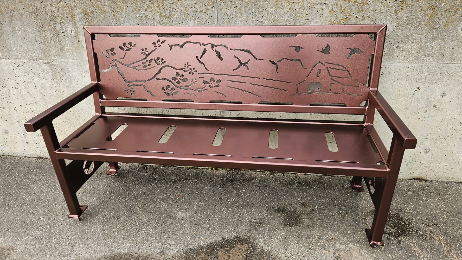

Finally cut the last panels for this bench project.

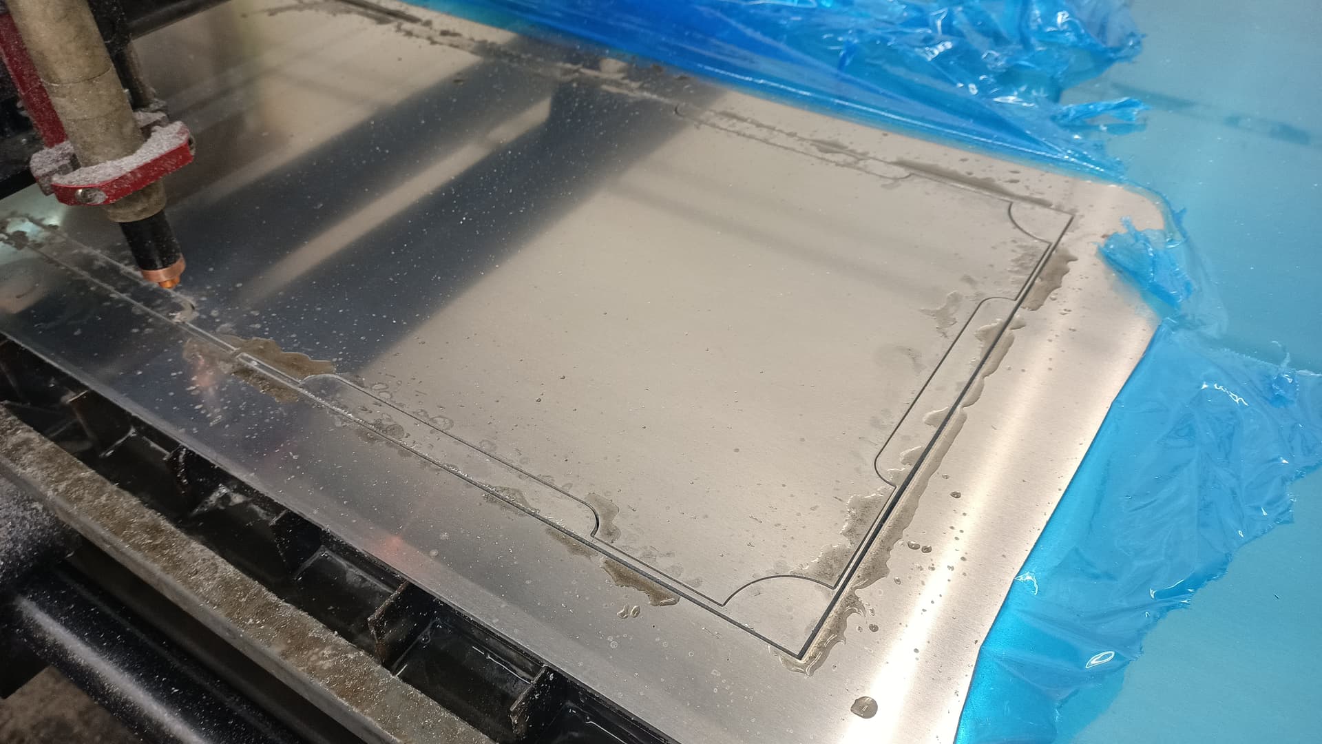

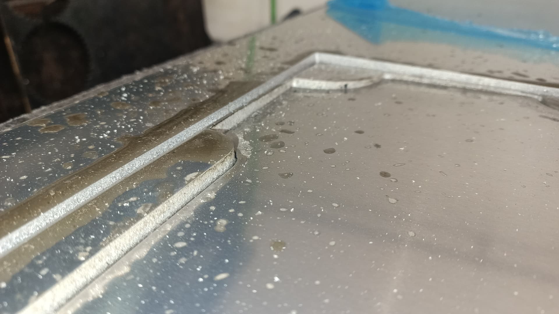

Sure slow go. The one panel with the kayak for example has just under an hour of torch on time, 140 pierces then I timed it as just about an hour and a half total time because you have to stop and wipe the sheet and check and change the consumables quite often with the quarter inch of aluminum.

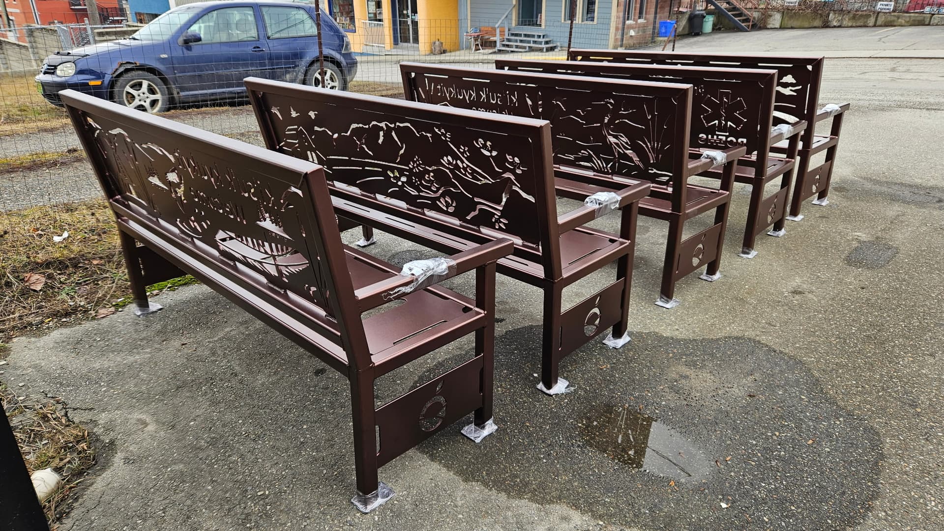

Five benches all gettingdelivered for powder coating today. I’ll try to get some better pics of them together as we’re moving them. We normally powder coat in House but we don’t have an oven to fit these.

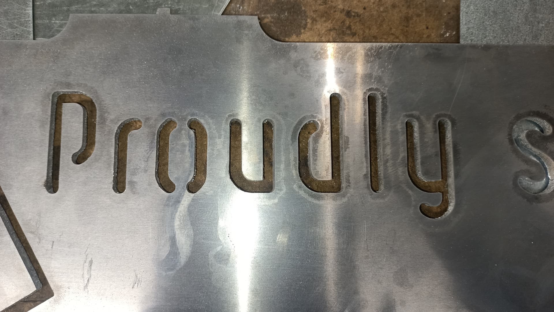

These pictures are before clean up.
You can also see in the picture why I cut a perimeter cut to relieve the tension on the sheet before cutting the internals.
I am looking forward to taking a break from quarter inch aluminum for a week or so. Cutting steel this week is going to feel like being on vacation.

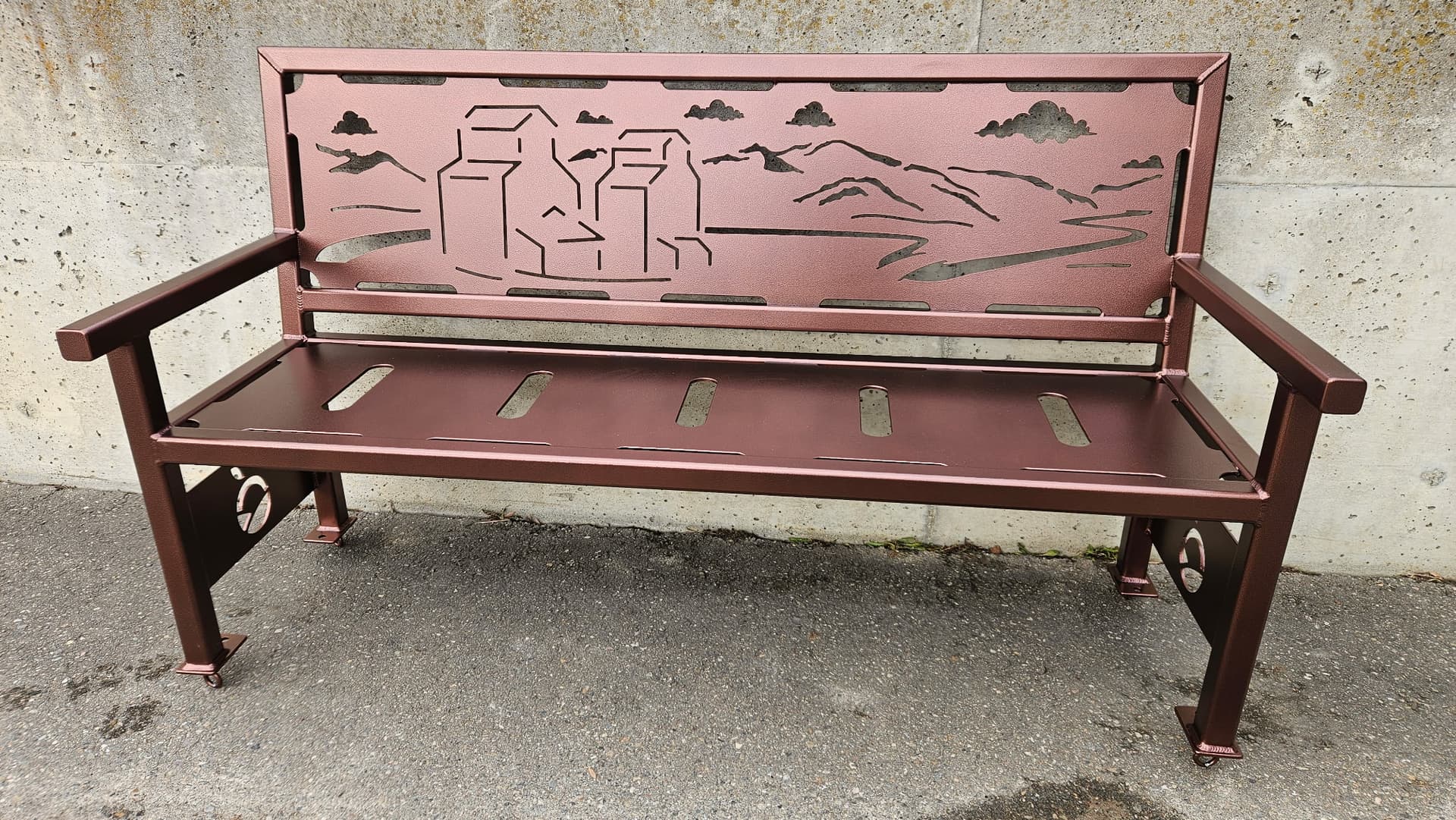

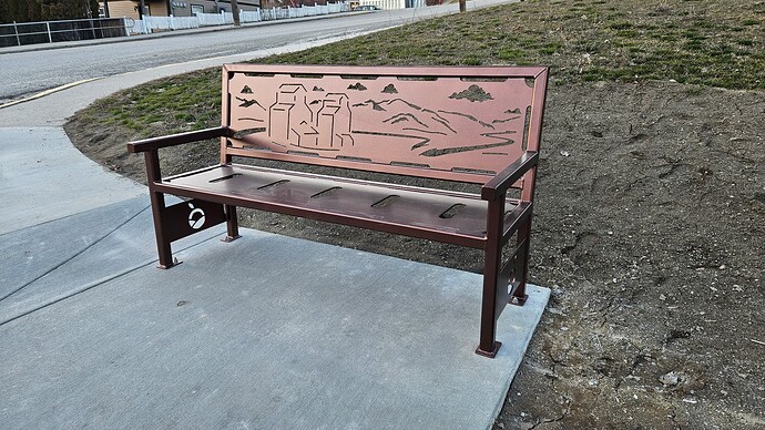

The benches have been, powder coated, delivered and have started to be installed.
Those look really nice, TW! Your city will be proud of them!
TinMan, great job! I bet you’re glad that’s finished.
Thanks guys.
I’m proud of what my business partners and I did.
Definitely felt like we pushed our limits both in our own capabilities and in our equipment’s.
learned a few things, screwed up a few square feet of material.
These benches should last a lifetime.
I am happy with the final product.
Those BYOC (Bring Your Own Cushion) benches turned out really great.

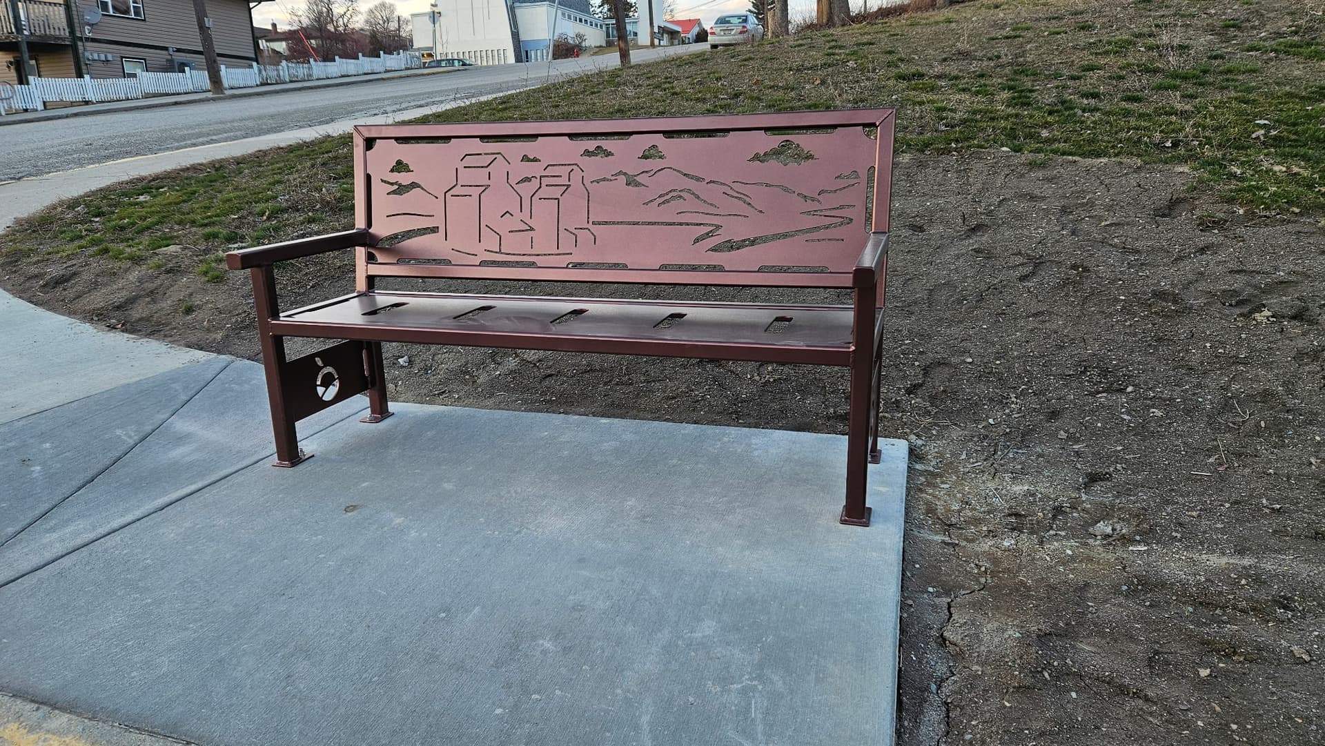

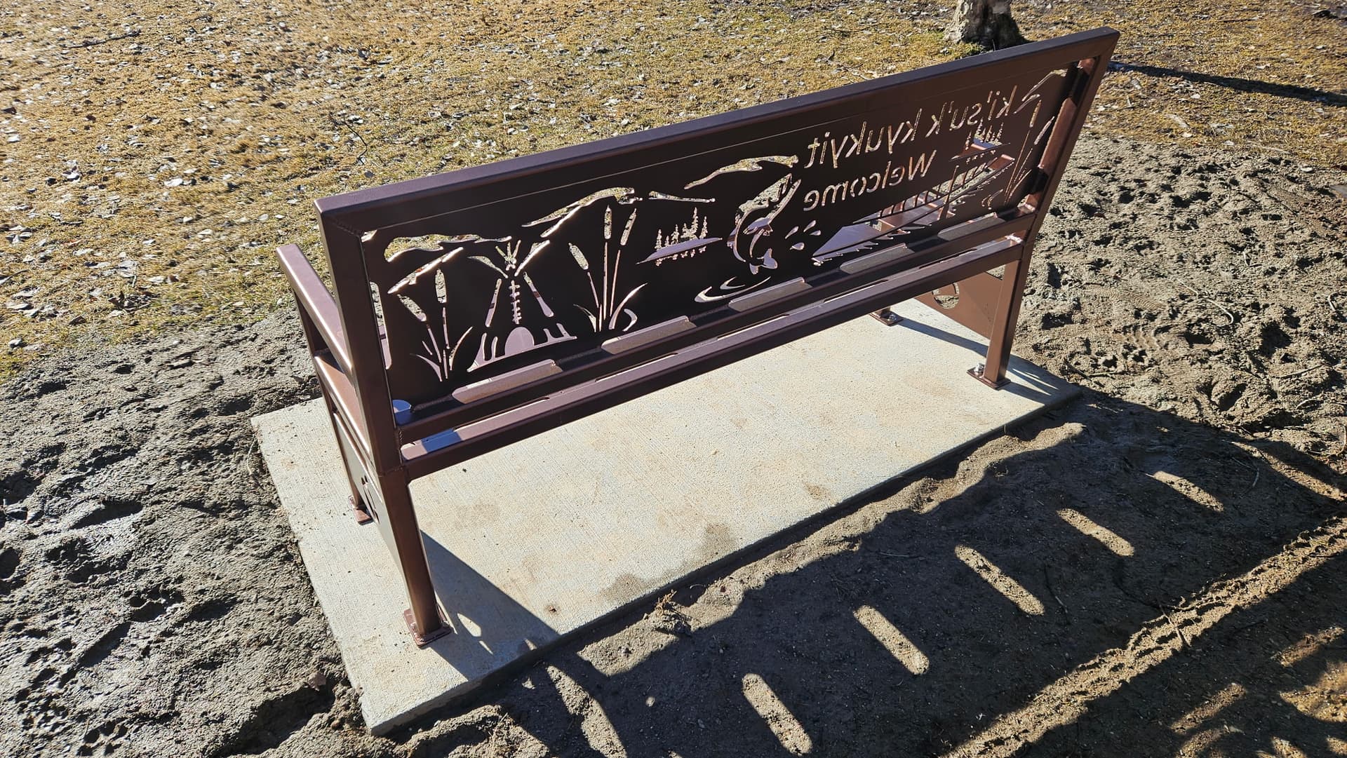

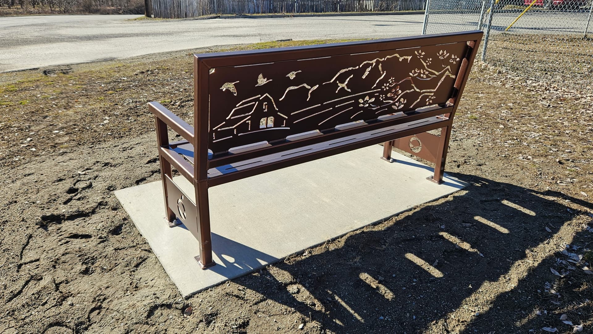

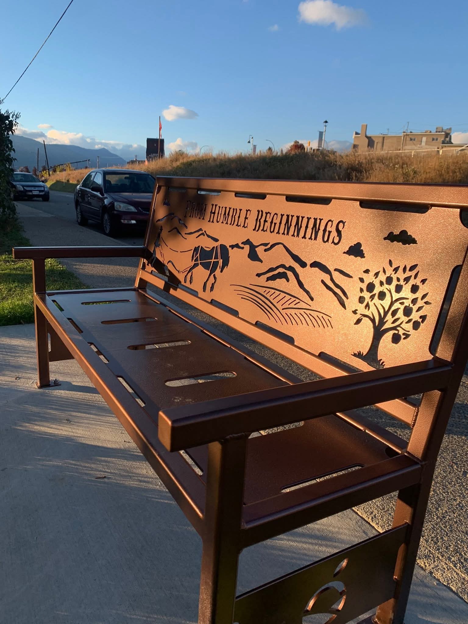

Another couple were installed.
Pretty barren surroundings currently. I think there is some sidewalks and shrubbery planned

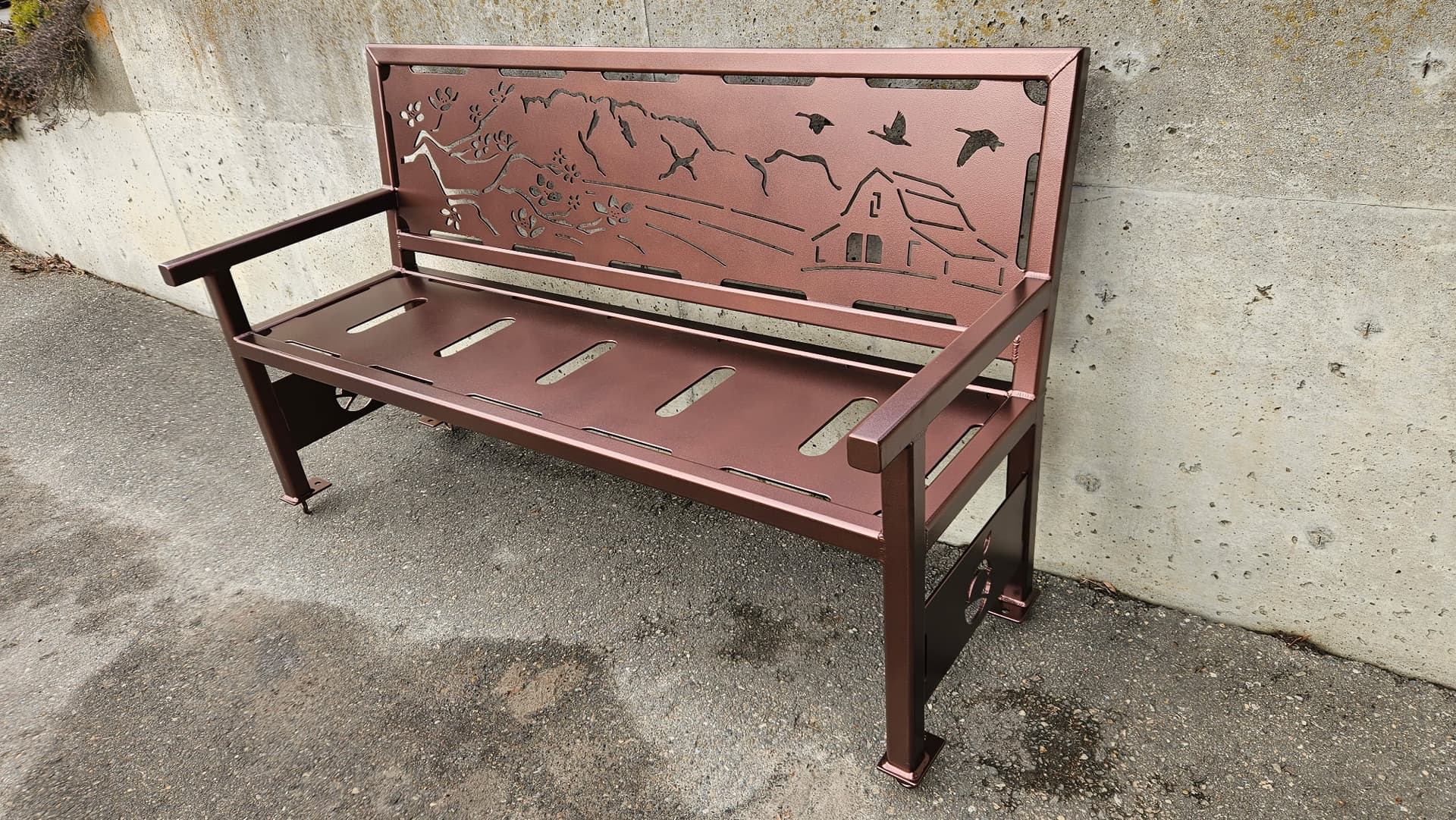

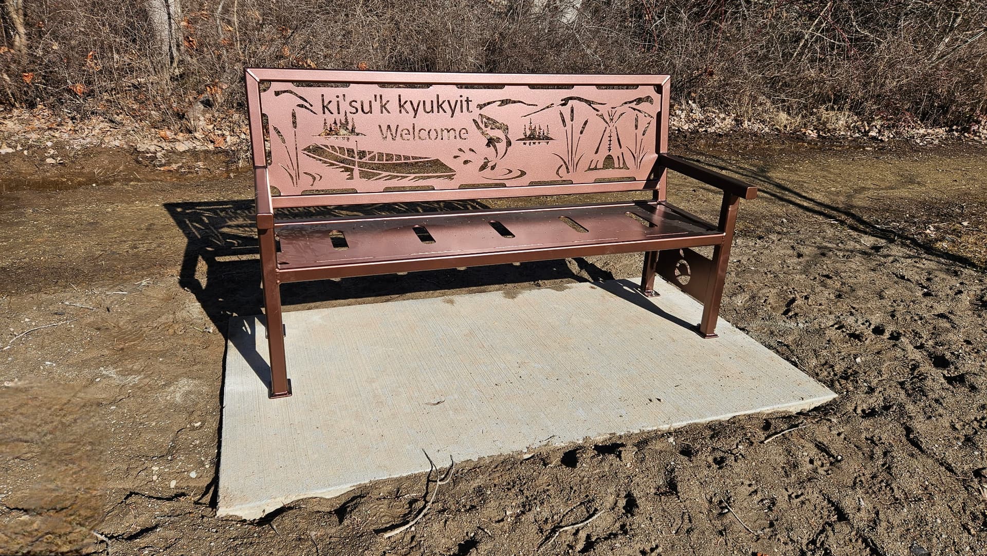

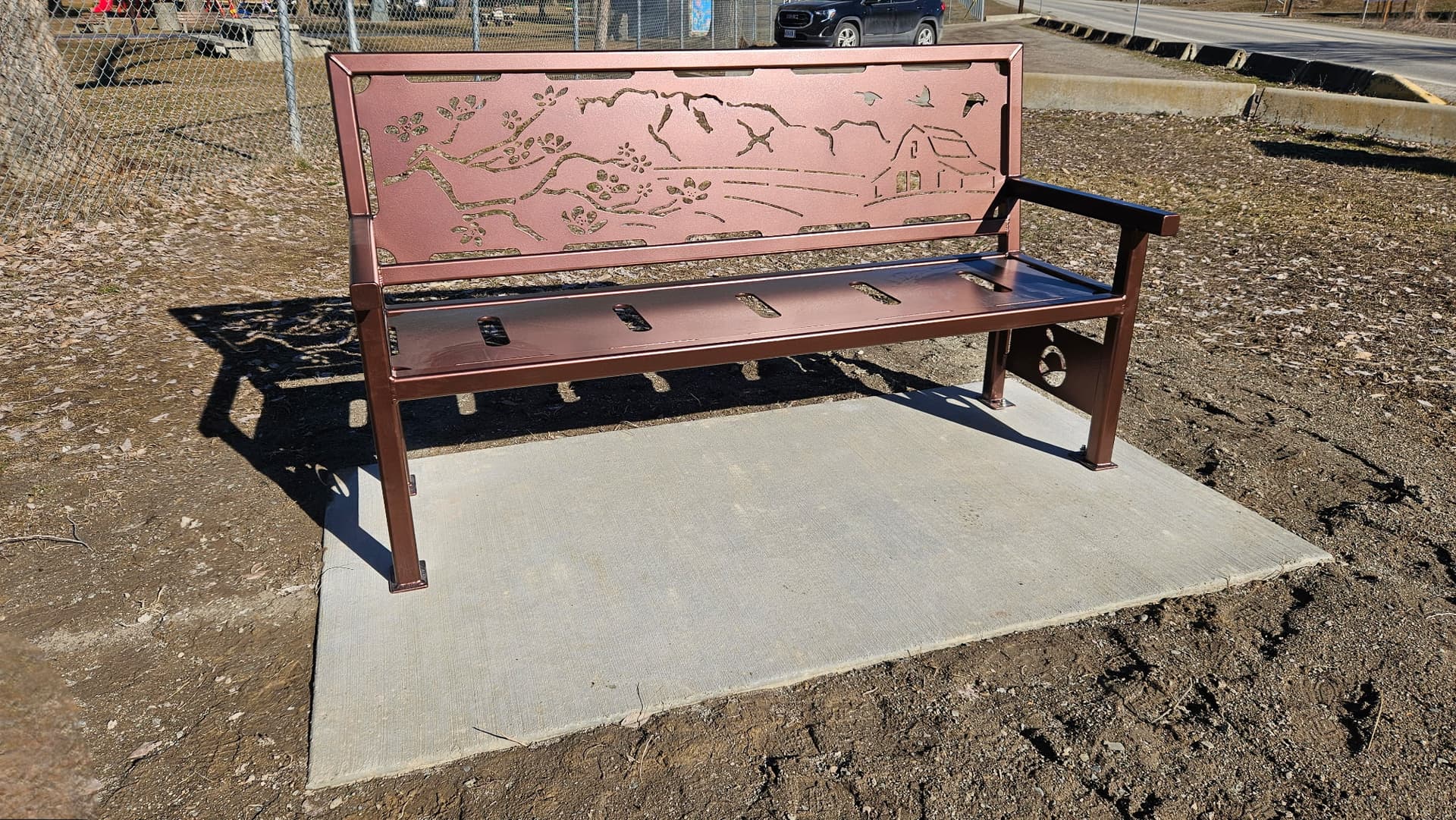

Here’s some finished pictures of that last bench we made.
Those benches will provide for decades. I expect there will be postcards with them in the near future.
You and your team should be very proud.
