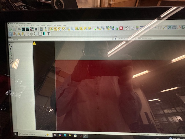

Panels in SheetCAM stuck at top just below icons
This is occurring on the touchscreen provided by Langmuir for the Crossfire XR.
The Parts and Tools panels got moved from the default positions as the left column in the app. Now they span the app window and go beyond the right boundary. I can’t seem to pull them back down into the default positions where they’re actually usable.
Is there a menu setting for restoring them to a stacked vertical column?
If not, is there a preference file somewhere that I can delete and start over?
The photo shows the Parts and Tools panels at the top.
Why do you have sheetcam loaded on The XR table minicomputer? Click on top of tool panel line and drag down, should straighten out.
I don’t have a Windows machine other than the touchscreen. At least, not yet.
I should have included what I’ve done thus far because I have tried and tried to drag the panels down, expecting them to behave like in any other program. It hasn’t worked for the Tools panel. That’s why I’ve submitted this question.
I would plug a wired mouse into a spare USB socket to drag the windows back to the left.
The notion that the touchscreen can emulate ALL Windows functions is delusional. (Not you, the designers! :grimacing:
Great idea. At this point, I’ll be uninstalling SheetCAM from the touchscreen computer and running it on Mac using crossover. Overall a win. Gives me an excuse to rebuild my tools library now that I almost know what I’m doing.
