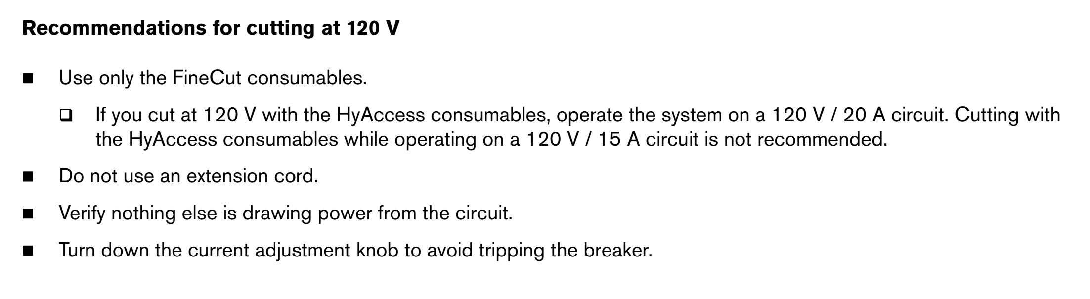

Ok, so I really want the ability to use it on 110 and 220. Not with the CNC but on job sites or the road. Would I get the same goodness for the hypertherm 30xp?

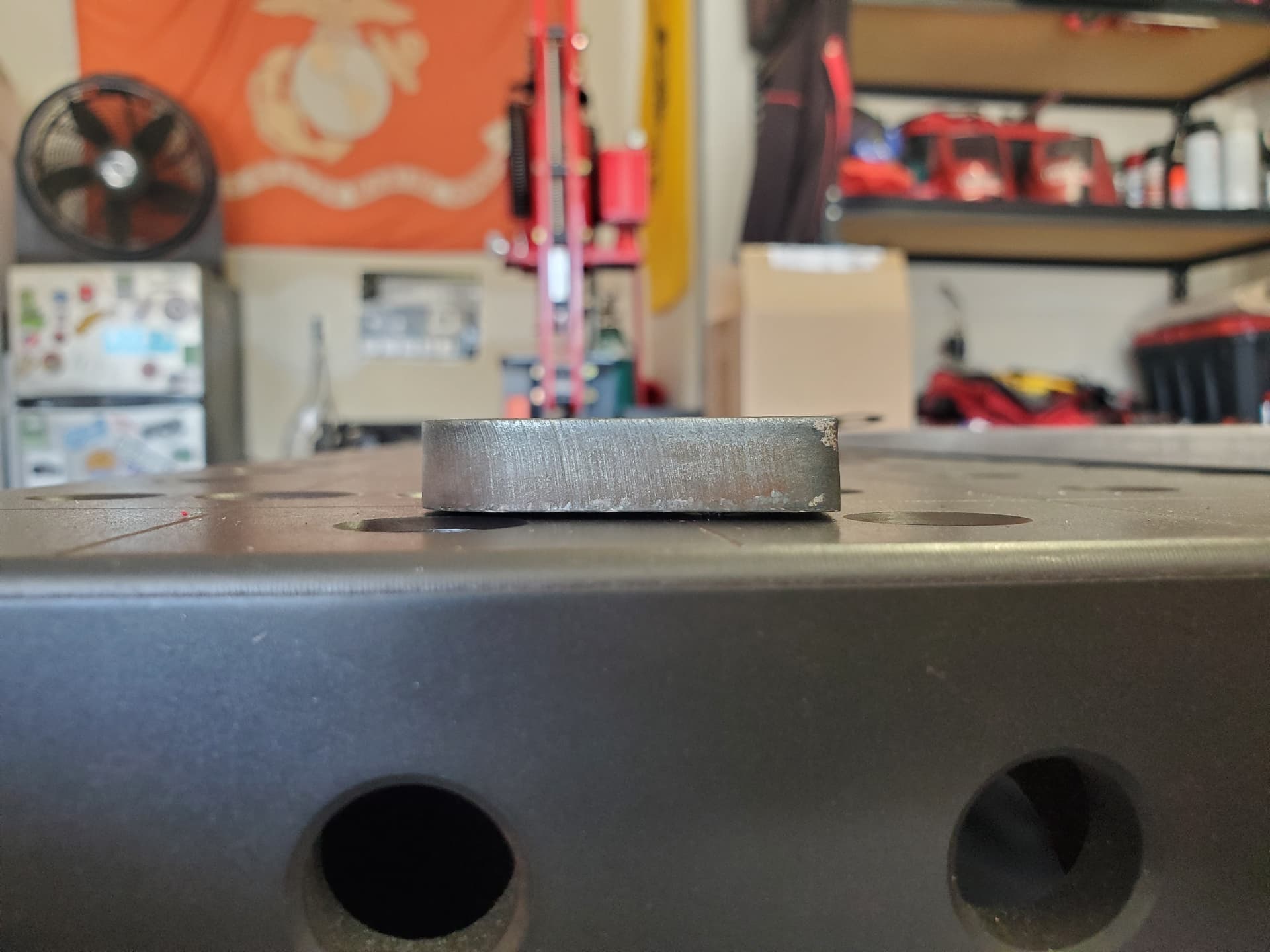

Being able to run on 120v is more important to me that clean cuts on 3/8. Can I get clean cuts on 1/4 and use a 30xp? I could always outsource or buy a second unit if structural stuff becomes a bigger deal for me. Big question is, on thin stuff will the detail be as good. Can’t be artsy fartsy if everything looks like it was done with a market on toilet paper.
The 30XP will work on 3/8” as long as you don’t try and rush it. But for the money the 45XP would be a better deal. Its your money to spend as you see fit but for the extra amps I think the money would be well spent.

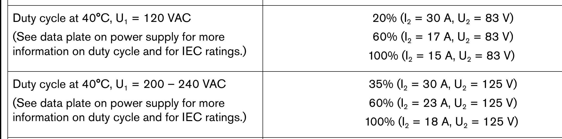

You’re basically going to have no working duty time at 3/8.

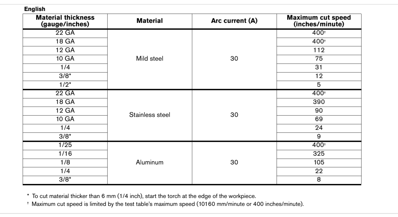

Took a few clips out of the 30 XP manual.
You also want to be edge starting or pre-drilling your starting locations or you’ll be nuking your consumables trying to pierce start at that thickness.

Thanks. The outlets are not an issue for me, my mobile use case, where I need 120v, is to run it from my RV generator which has 2x30 amp circuits. But at home, and at campgrounds 30amp 120v outlets are plentiful, as are 2x50amp 120v outlets.
Must be regional thing. 120 volt outlets above 20 amps is super uncommon at a residential home here unless you are at an RV park.
I added RV plugs, its not common.
