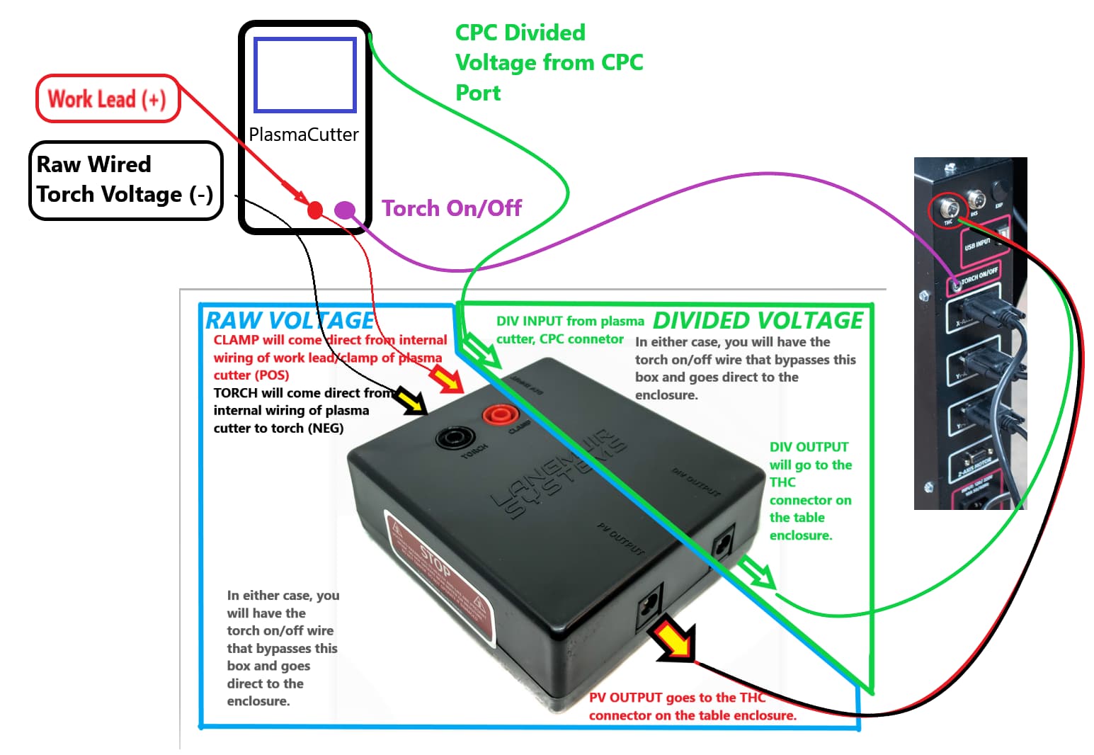

Dear Jim: Thank you for your prompt response, torch is not turning on.

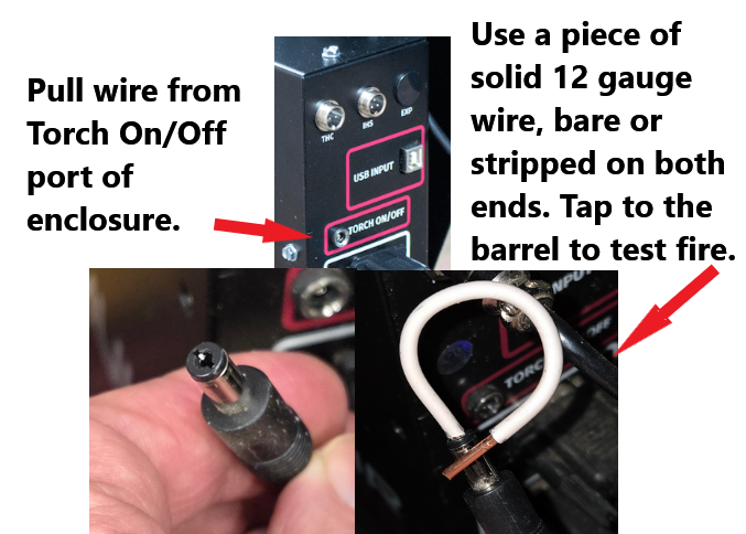

You might try this.
Other than that, if that does not fire the torch, check your air supply.
Here is a general wiring that should connect the cutter to the table:
Note: Torch On/Off connection at the plasma cutter, may be coming of the CPC port in the back of the machine.
If this does not cause the torch to fire, refer to my above post for more information.
Dear Jim:
We think the problem might be te connection between the box and the plasma cutter. We tried to follow your attached schematic, but we are getting lost.
We are using the plug and play input/output. If you are so kind to give us the foloosing information:
DIV Input goes to:
PV Output goes to:
DIV Output goes to:
The plasma cutter we are using is the Tazor CUT 45, this is the unit that was recommended by Langmuir when we purchase the table.
Everything works, we can do a dry run, no problem, but as soon as we engage the torch, alll movements stop.
If you are using the divided voltage from the front of the Razorweld machine, you won’t use the PV output. That port will stay empty.
The cable from the divided voltage port on the plasma cutter goes to the DIV input.
A cable then goes from the DIV output to the THC port on the electronics enclosure on the table.
None of that is responsible for firing the torch.
You need a cable from the other port on the front of the plasma cutter to the “torch on/off” port on the electronics enclosure.
I would focus on that torch on/off cable first, since the ports on the plasma cutter could be reversed.
Plug the torch on/off into one of the ports and try to fire the torch with the manual torch fire button in Firecontrol. If it fires, great. If not switch the ports and try again.
Yes, it gets confusing. Follow what David (DS690) said. He knows this frontwards and backwards.

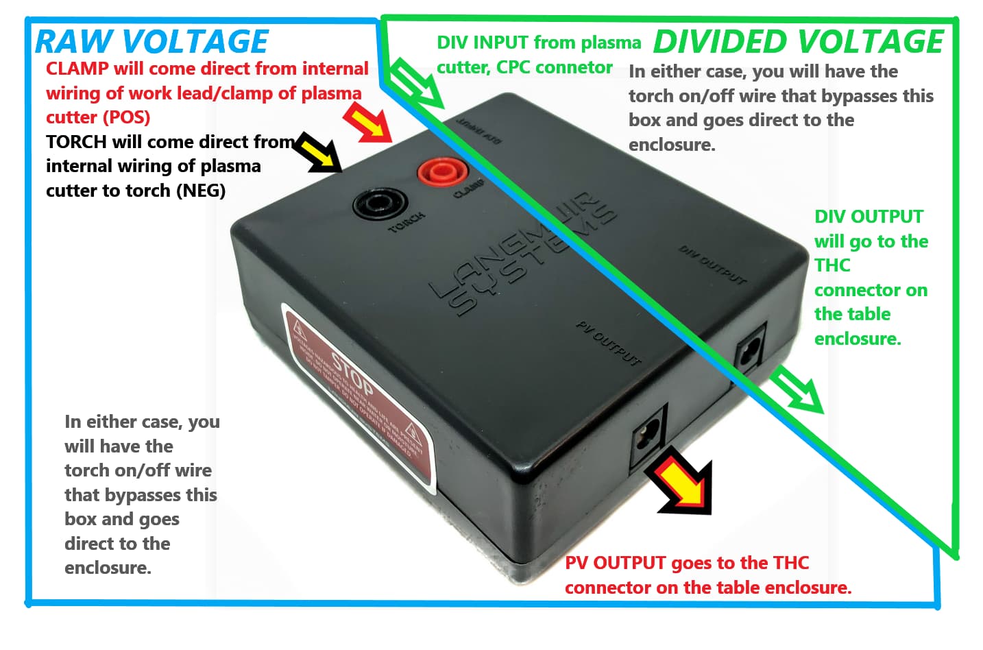

As far as connecting that black VIM box is concerned, all connections will stay on either the blue boundary side of the diagram if you are using Raw voltage…
…or if you are using Divided voltage then the connections will stay on the green boundary side of the box.
David is directing you to this part:
P.S. I don’t think I will use that image again. I tried to make things simple but it is confusing.
