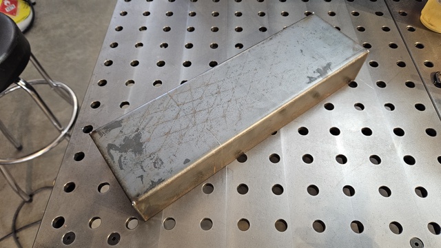

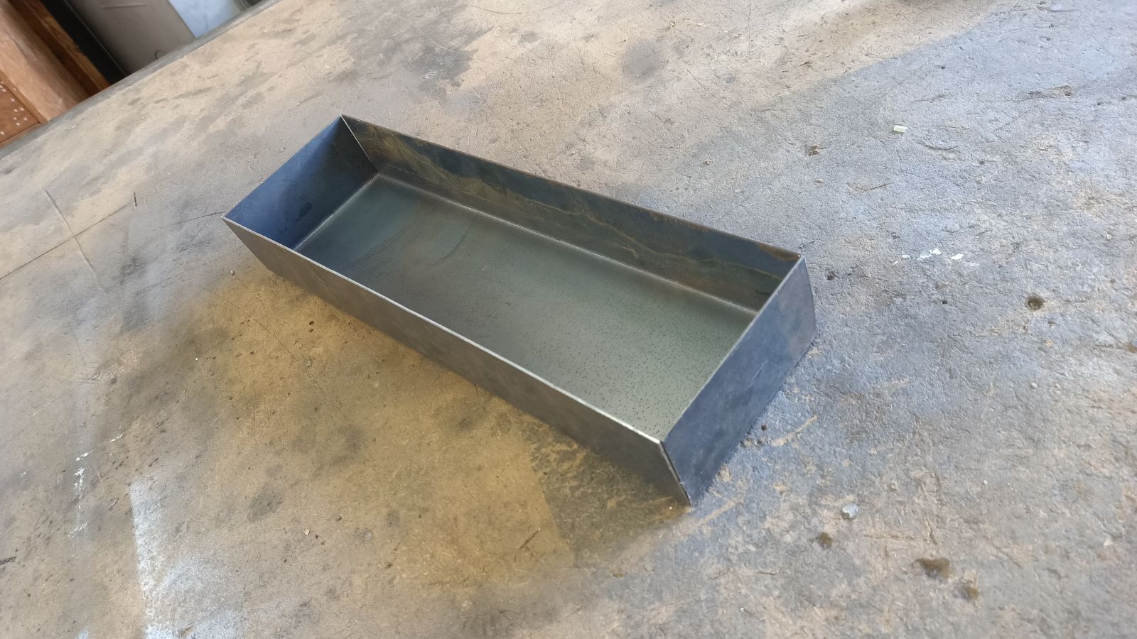

Local shop did mine. It’s oversized width and length, and 3 in deep as opposed to the 2-in on the OEM pan. My out the door cost was $400. This is mild steel not stainless.
Your best bet is to call around to some sheet metal and other fabrication shops local you and get a quote.
That torch is in the home position right now. My water capacity is 35 gallons opposed to the 15 Gallons on the oem.

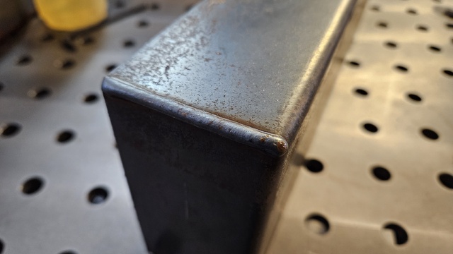

I did mine with 14ga stainless, but the same relative dimensions as the OEM table, except I increased the height to just clear under the Y gantry cars (2.400" max height). My metal monger had me purchase the entire sheet, but did the bends for me for $50. I welded the corners.

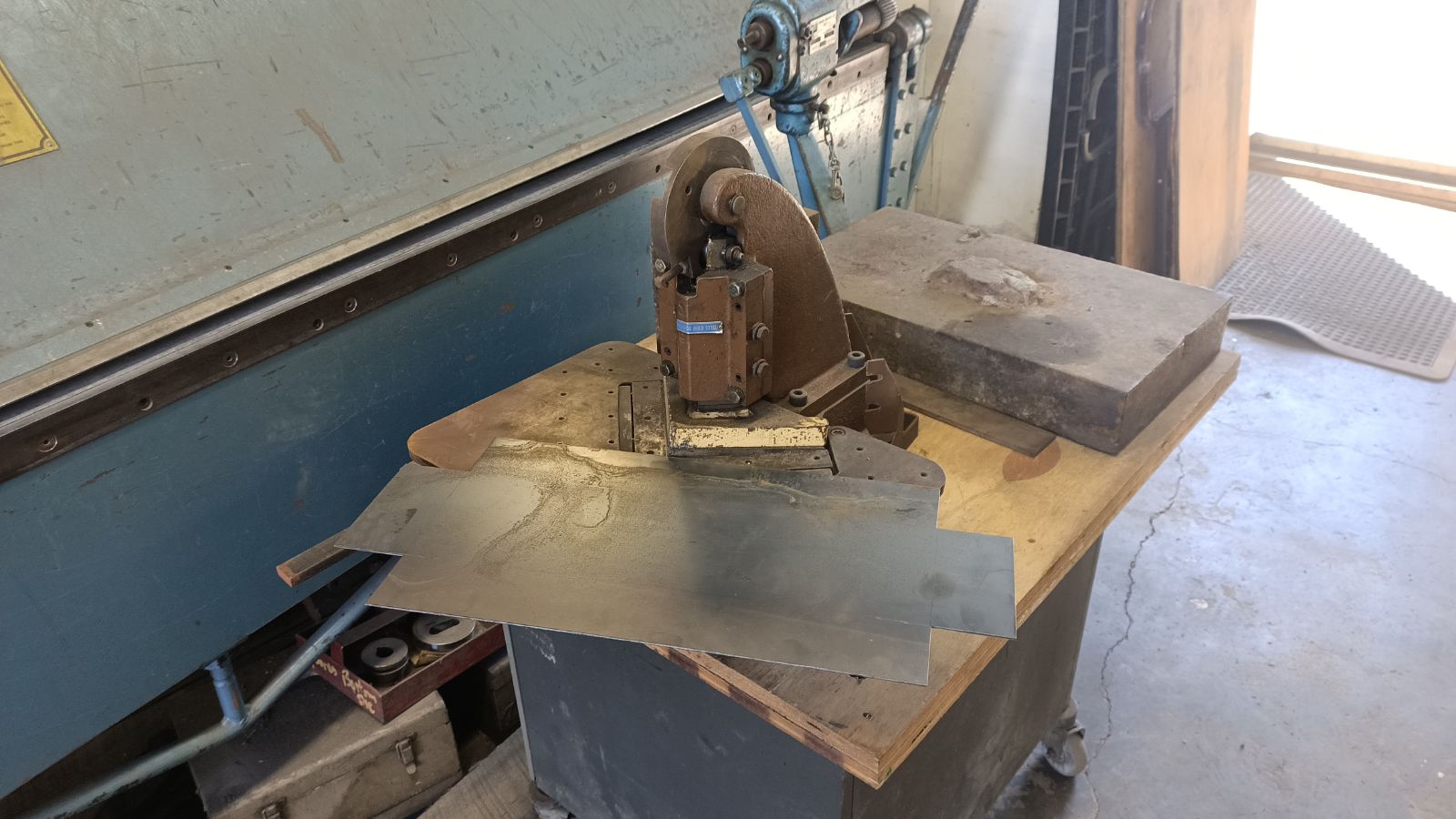

We do a fair bit of stainless countertop work and have a diacro corner notcher. It sure makes nice contaminant free inside corner notches.
The pictures are a mild steel pan

Ironically one of these notchers cost about the same amount as a XR.
