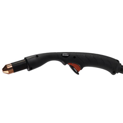

“Owners of the world’s most popular air plasma, the Powermax45®, can now upgrade to a Duramax® series torch, the same torch type found on Powermax65, 85, and 105 systems. In replacing the T45 torch originally sold with the Powermax45, owners can enjoy longer consumable life, better cut quality, and more torch and consumable options.”
Wish I had found those articles when I was looking for my machine torch. I looked at all the spec sheets (obviously they dont go back an update those) and found the T45M. I would have liked to have been able to use the same XP consumables. I wonder if the hand torch could use them or if I would have to keep both on hand? I think I will hold off on any upgrades until things settle down and go with a SYNC model with yet different consumables. Thanks for posting. Gives the OP something to think about.

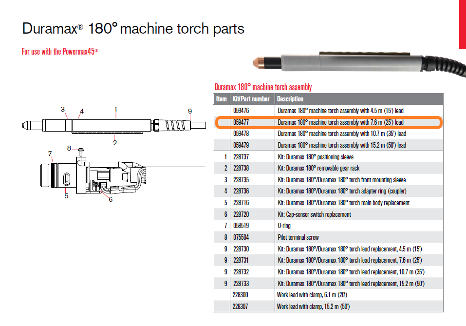

I’m reading this thread in December 2025. I have an older Powermax45 with few hours on it. Right now I’m using the hand torch on my new Crossfire Pro. To go to a machine torch, do I buy the Hypertherm 059477 or the original 088010 T45M torch in todays market? Best price I have found is Weldfabulous at $763 and $831 respectively.
For some reason my Google is not working on my phone and I’m on the job site so I can’t use my computer But if it were me I would buy the retrofit torch to use the new style duramax consumables.

I do want to buy Hypertherm. Was just wondering which pn is the best choice.
https://www.hypertherm.com/Download?fileId=HYP184334&zip=False
