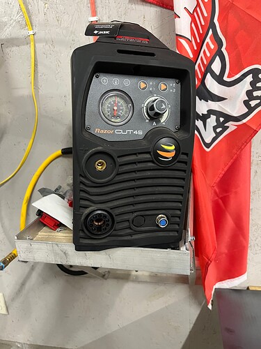

Here is a picture of the front. I’m sure I need to hard wire the torch on/off. I don’t want to wait for the part so I’m going to try and make one?
Is that port a torch fire power or dividend voltage?
Either way you will need to crack it open…. You can connect the plug to the torch on the control box and see if it will fire.
How was your friend cutting?

He wasn’t, he was someone who worked with my wife and died and the original crossfire was still in the boxes. I ordered the xl kit, limit switch kit and the z control upgrade. I don’t know how old it was but it was the old system so I ordered the new electronics box to use fire control.
I will guess that port is the torch fire. You will need to pull raw voltage off the cable lugs inside to run the thc.
He can skip the THC for now and cut the part right?
Definitely. Actually he he bought the thc upgrade the should have plug to go from vim to the control box and banana plugs to pick up raw voltage.

Ohming out the trigger the one outlet on the front is the torch fire. So I’m guessing I need to switch some of the plugins to make it work?
I’m heading to work so I can’t look for it. But somewhere on this forum/Langmuirs website are directions how to install the THC on that version of the RzrCut45
The 2 pin plug is the torch fire/ trigger plug. To hook up the THC you need to take the cover off the plasma cutter and hook the wires to the work cable/positive/red and black negative/torch.

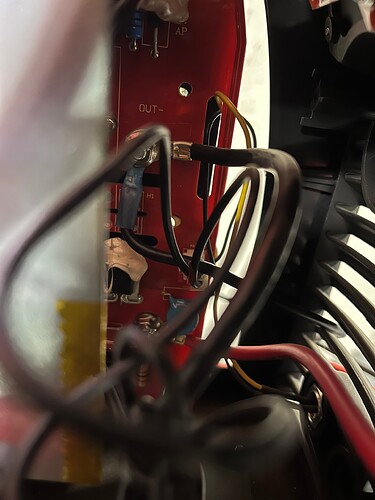

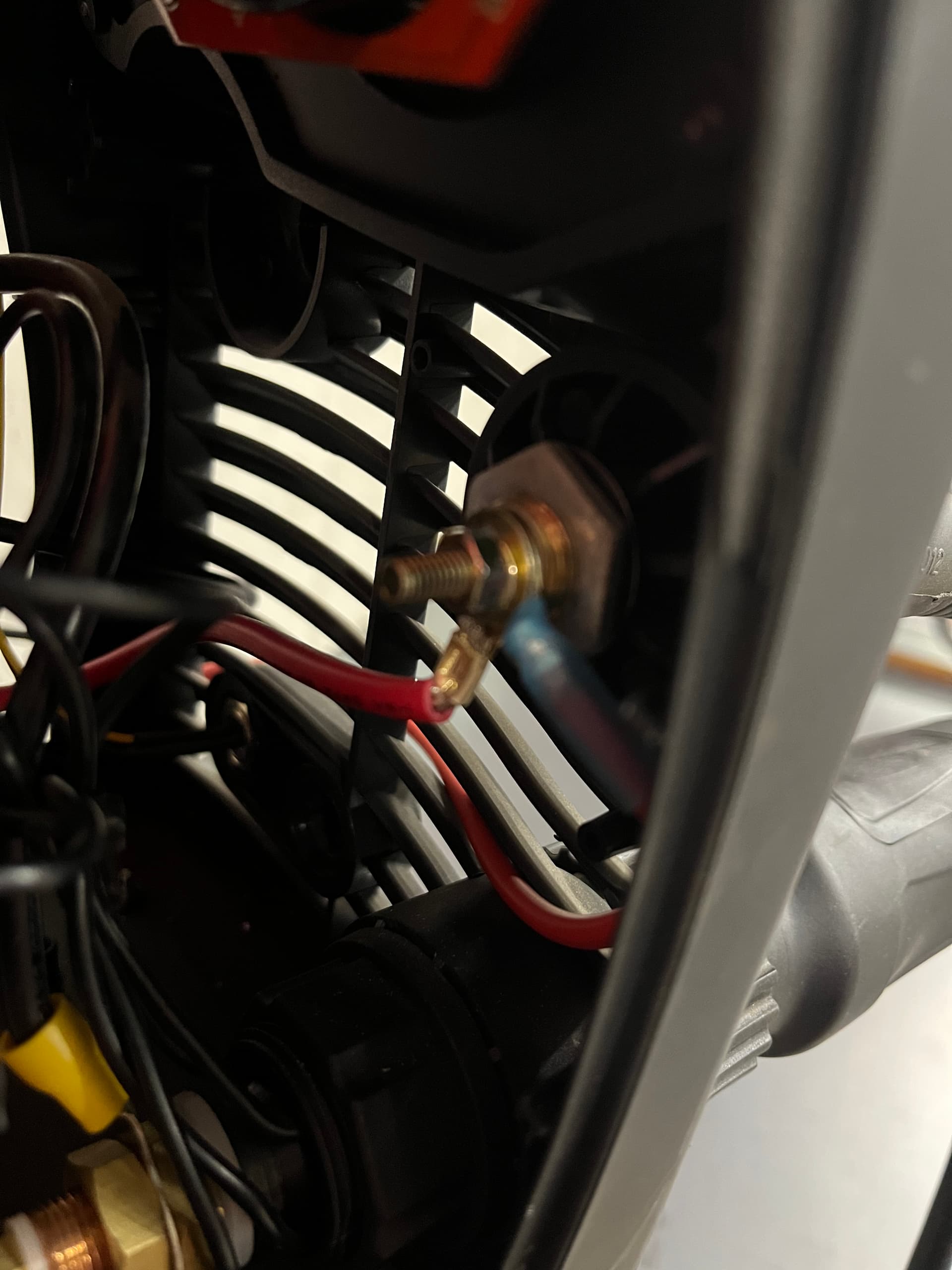

Ok my new best friends!!! I wired the torch fire from the 2 pin on the front of cutter to the plug in on the electronics box on the table. I then used the 2 banana plugs and red went behind where the ground/pos plugs in and the black to the big black wire off of the torch plug in.  It does nothing but it does fire manually?  So again I did something wrong?
Here is how I wired it into the cutter. I probably hav
e the black wire wrong? I’m guessing. they both have the light blue ring on the wires so you can find them easier
I believe I found the problem!! They had sent me a new white board which I thought was complete but I needed to take some pieces off my old one and add to the new one. {Didn’t know that). But I can’t remove it because it’s the black relay and it’s hard soldered to the old white board. So I think I’m screwed again. Don’t know why they don’t send the whole thing when the old one can’t be removed. It’s been a month of headaches and still have not fired it once.
Probably time to directly contact Langmuir. They are very responsive
