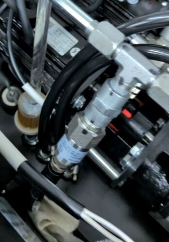

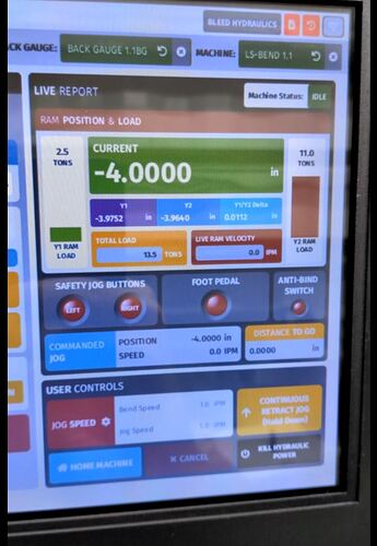

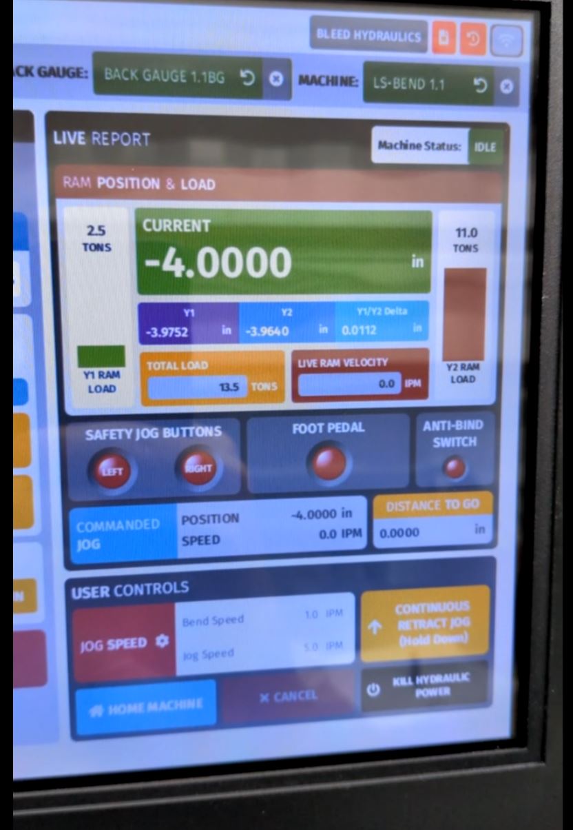

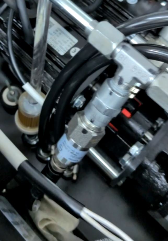

As far as the machine crashing and blowing the relief lines off - the problem was one of the pressure sensor electrical couplers not being installed properly from the factory - the threaded coupler was cross threaded, so it appeared to be connected and tight, but in reality the sensor wires inside were not connected, causing the machine to malfunction while pumping oil at full speed, blowing the lines off. discovered by Y1 / Y2 ram load not the same, machine would not allow homing, would not allow bleeding - had to manually bleed the rams, but the Y1 was still showing 2.5 tons. The machine would run in manual mode, but was still showing 2.5 tons after moving in both directions. I figured the sensor was damaged, but after taking it off, the coupler was cross threaded onto the sensor. I installed that properly, now everything works.
I’m guessing that if both sensors are functioning, that the servo pump motor would not run at full speed if the ram bottoms out? with one disconnected the servo was full speed mode overwhelming the relief lines? Is there a safety mode in the system that limits the servo in crash mode?
Yes that is correct. The system does have several different failure modes - rams going out of sync, tonnage maxing out, anti-bind system trigger, loss of data trigger. It sounds like your system lost the tonnage reading at the same time it triggered the PRVs, preventing the early over tonnage stop top from happening.
