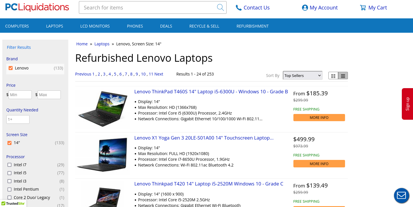

#2 The old guy (me) needs to come into the “laptop” world. I am cheap but recognize the need for a suitable and portable computer. I am “shopping” for a suitable laptop and on the forum I ran across a previous post that indicated that some guys are running an older laptop that is capable of just talking to the machine. Is this a good idea? My desktop computer has all the fusion and cad capabilities needed and I am wondering if this approach is a sound one? On the other hand, would I be better served to just bite the bullet and pop for a more expensive laptop that (in my mind at least might prevent computer issues that I don’t want or need) My “shop” is semi open and I am making an effort to minimize the “dust” by enclosing (with good venting) the area as much as possible.

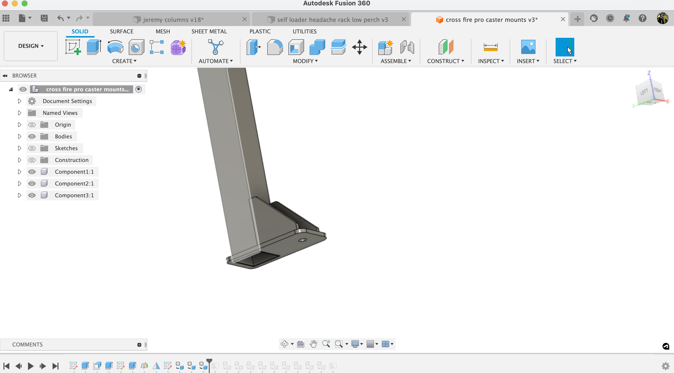

Here is what I had planned to do.
72Pony
Sep '22
This is what I plan to do.
2 inch square tubing for the frame
L3x3x3/16x0,3" with a custom base plate for the legs outfitted with the original leveling feet.
I also plan to install some threaded rod with leveling feet. This will serve two functions level the table quickly and unload the caster wheels when not in motion to keep them from getting a flat spot… I guess I could just use steel casters and simplify it a bit… but I struggle with simple.
Attached is a quick sketch to give you an idea… not the final design. I haven’t decided on the base plate thickness or configuration yet. Still playing with it.
As far as the computer I would look at the Langmuir sheet posted on the website for comparable computer requirements and get one that meets their criteria.

I bought a HP laptop from walmart 4 years back $230. on sale and have had no issues with it. Run Bend-Tech software,DeltaCad, Inkscape and sheetcam never had a freeze up any issues . Runs my Pro table.

I used same casters as @rat196426 but cut out brackets and gussets then added cross braces in the y axis. I ve moved my table plenty and cut multiple index cuts on entire 8’ sheets with good rests. I left the original leveling feet in place for when the casters run out of stroke. Ill try to add a pic tomorrow

Any of these Lap tops will run the table. Use a memory stick to transfer the cut files.
