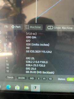

Has anybody had any issues with machine not making complete cuts on circles? Everything in the program looks good. Cut about 30 circles on 10 gauge and it misfired on one circle. Then I cut out about 10 circles on 20 gauge steel and it misfired on half of them. Torch will pierce the steel, but stop arching, whilst completing the rest of the the circle. THC is plugged up correctly, sanded area where ground connects, and all cut paths look correct

Post the first 50 lines of your code.

Razorweld cut 45 plasma cutter, compressor has more than enough to keep up. I’ll post some pictures of parameters and first 50 lines of my code in a moment.
nothing too out of line with the code.

Set plunge rate to 60 ipm in sheetcam setting, you have it at 40 will cause issues.
That lead in/out is excessive at .3125". That wouldn’t fit in any hole smaller than that.
Check the box for “start at the center of circles smaller than” and put in .75". That will start at the center and spiral out to cut the hole on any holes smaller than .75".
