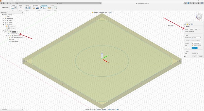

Maybe someone else will capture it, but I opened the file myself and saw some weird things I’ve never had to do.

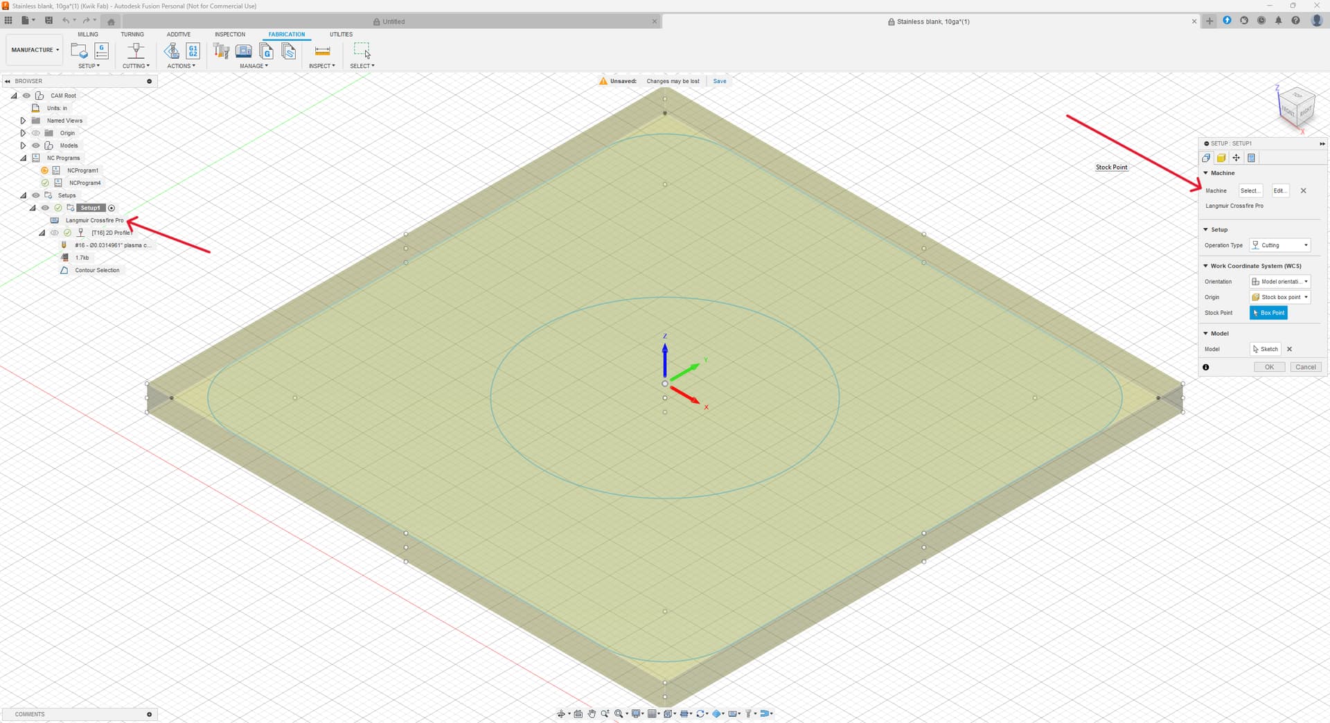

For example in SETUP, why is this here?
Probably not the root of your issue, but I’ve been cutting for a few years using only Fusion 360 and I only touch the last tab in the SETUP menu for entering my program name.
I’m unaware of what that part of the SETUP does, so I’d like to learn out of curiosity.
Also noticed a lot of different parameters are implemented throughout your tabs in the PROFILE menu. You could get away with extremely accurate, and well done cuts without so many minor changes.

Just wasn’t sure what the -Machine- part does for you?
By chance, did you alter your tool details at all between adding the cut paths? I ask because normally having a second tool will yield a tool change error and won’t post, but it could be something done in-between that created the issue.

Kwikfab-the “Machine” part…has always been there, must have been when I initially installed FC, two years ago, that I may have accidentially added another machine…or opted for that at least. I have had the tool change error before, so Im aware that you get that in the Fusion360 Personal version if a different tool is selected. This is just weird.
