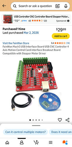

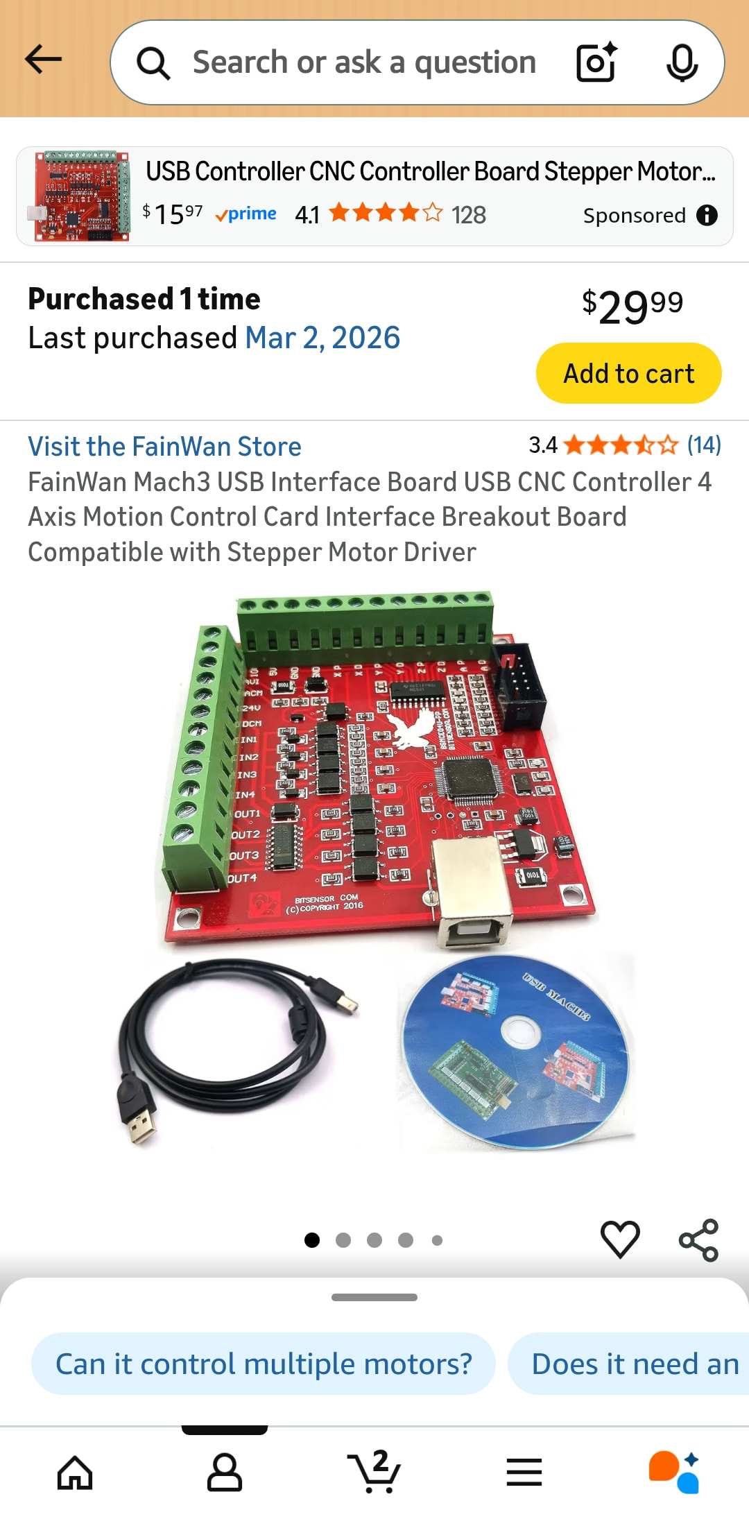

Sorry, New to posting on the forum. This is the board I have ordered to replace a legacy board. Thank you for any help!
I ‘think’ the only difference between that board and the Langmuir version it the type of connector used to connect the wires - yours uses Screw Terminals while the Langmuir uses crimp type.
Going from Crimp type to Screw terminal is easier than the other direction but it’s still work. If you can return the one you purchased, you might be better off simply getting a replacement board from Langmuir. They generally have good stock of parts and won’t rake you over the coals on pricing. Pretty fast service too.
EDIT: Whoops, I went back to read the original post. I think it’s worthwhile checking with LS just in case.
If you want to keep this new board, then each wire needs to be cut from its original connector, stripped, and inserted into the Screw Terminal and tightened. IIRC both boards are labeled at the connector so you can verify that the same signal is on the same pin.

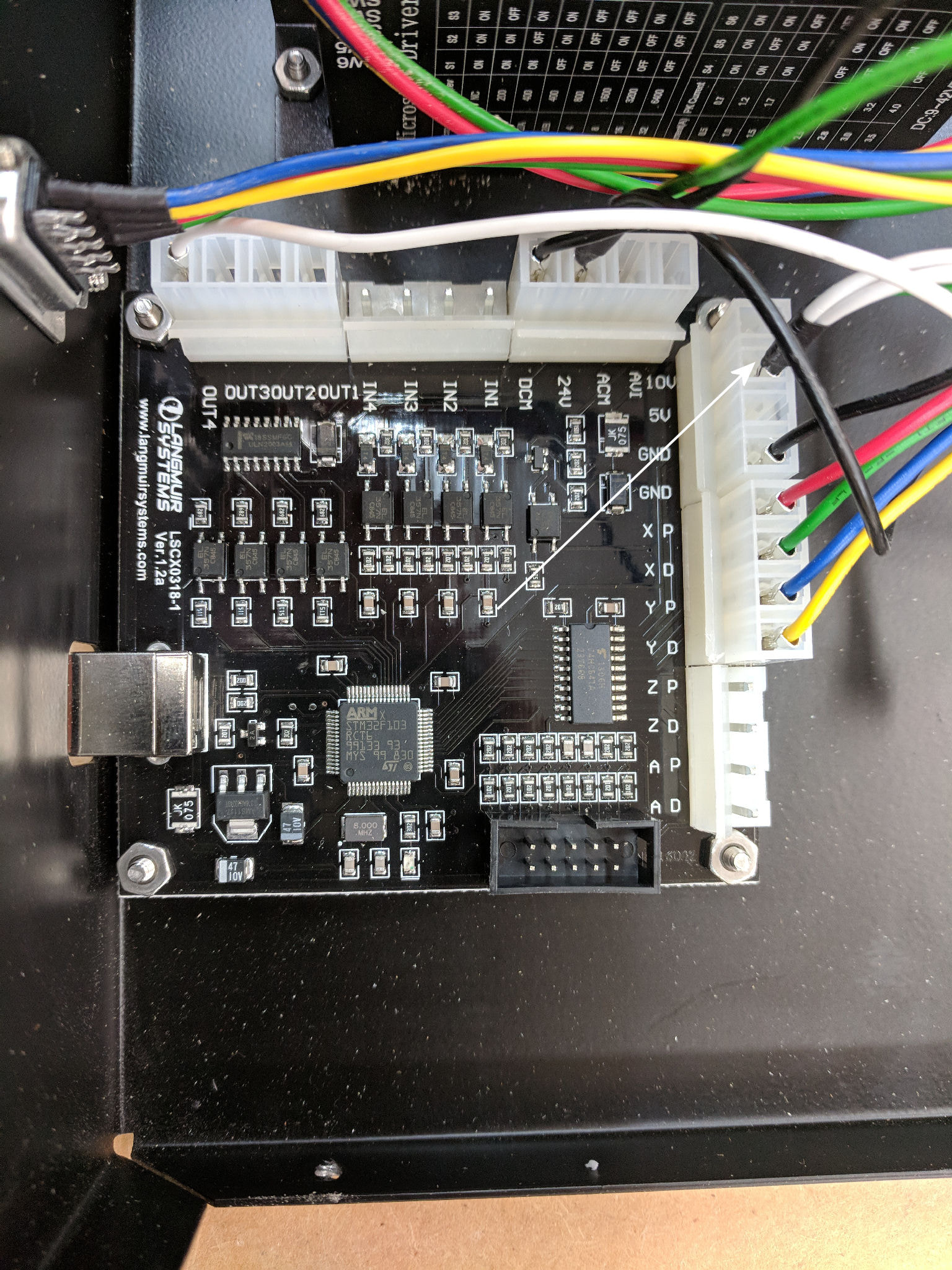

You may run into a small snag when you wire the ‘24V’ pin. LS uses 5V that they jumper from another terminal and that drives their Torch Relay. I ‘think’ it’s ok, but check the wiring very carefully around that ‘corner’ of the boards.
Here is the original board with the wire flagged:
