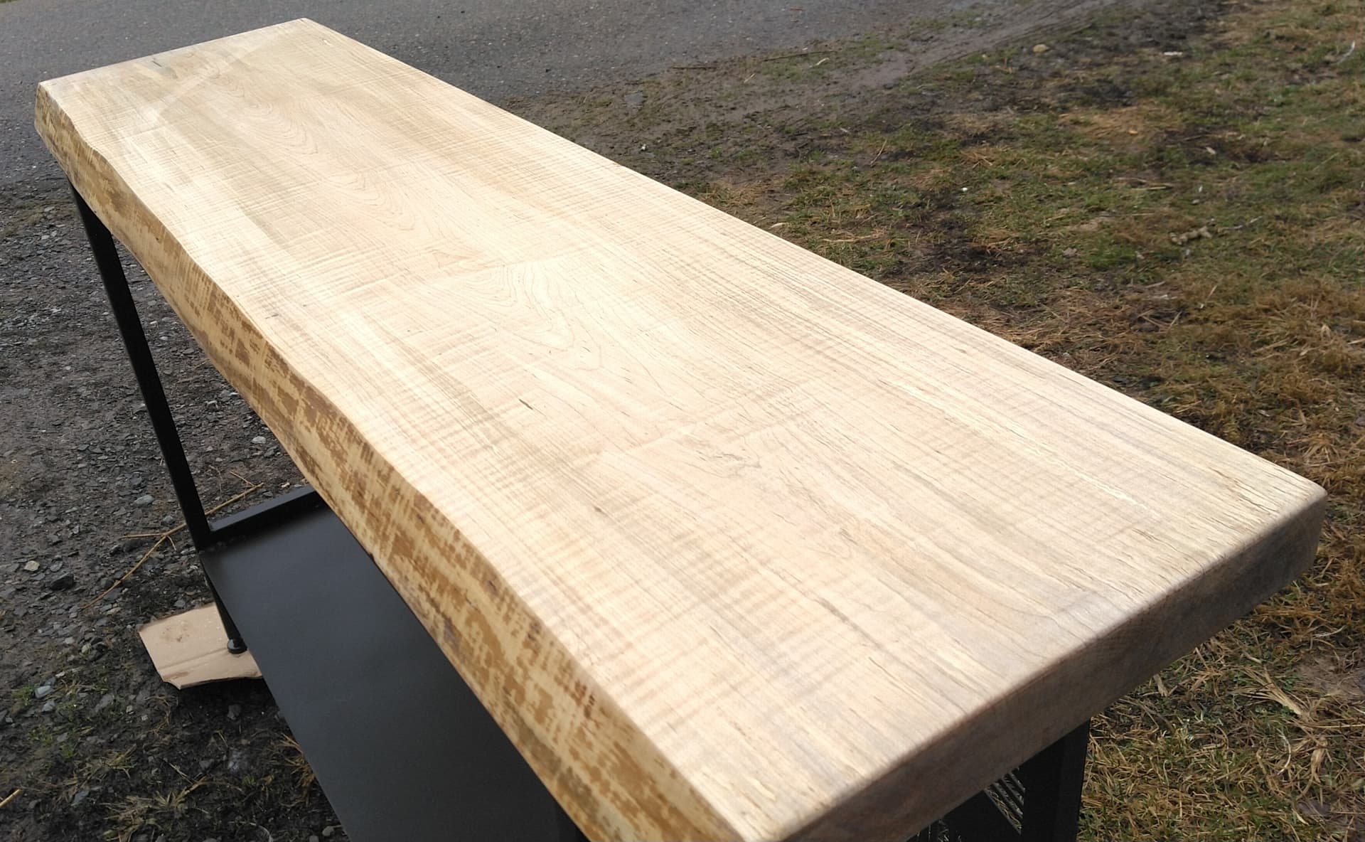

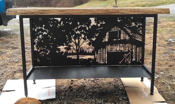

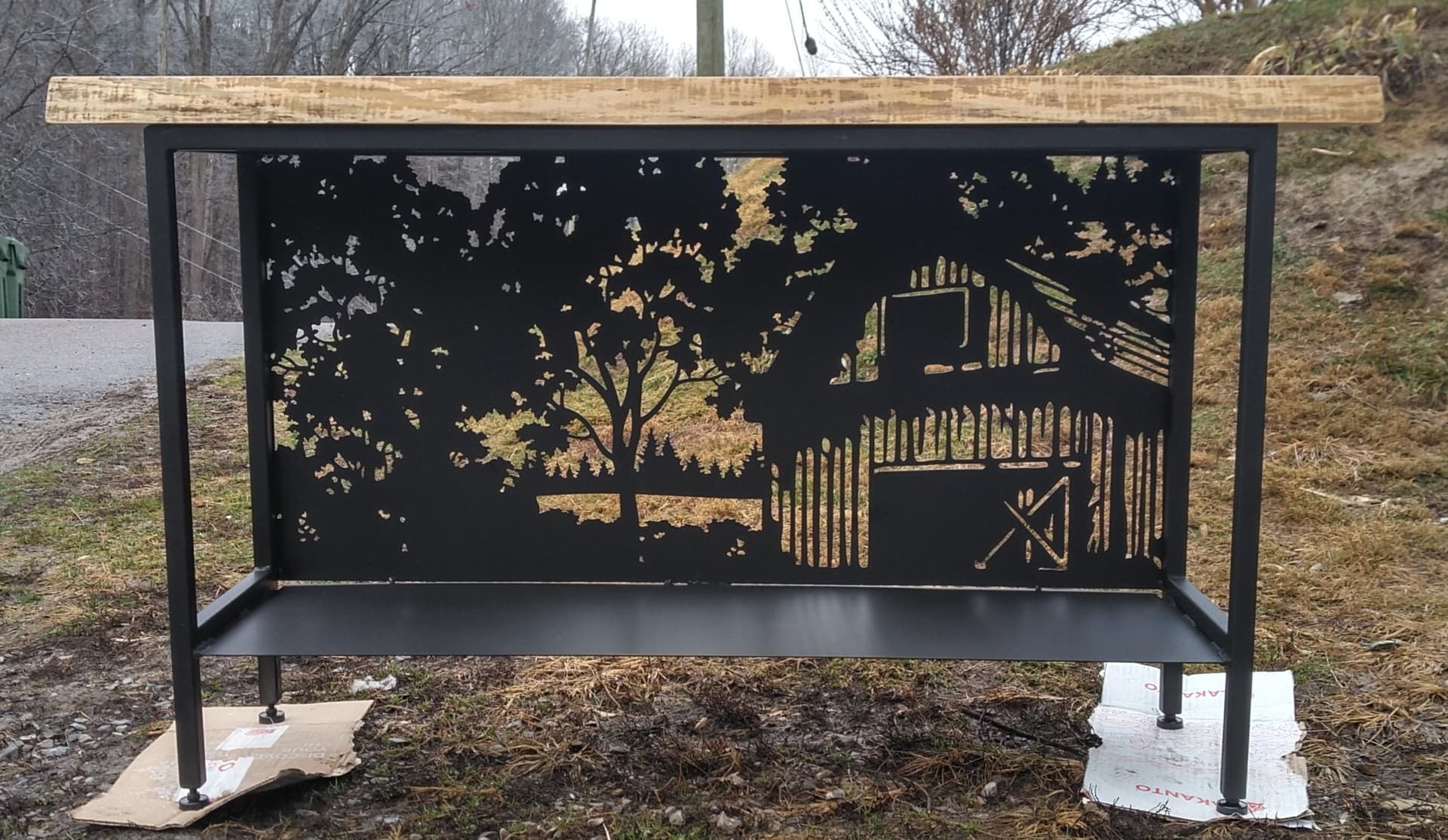

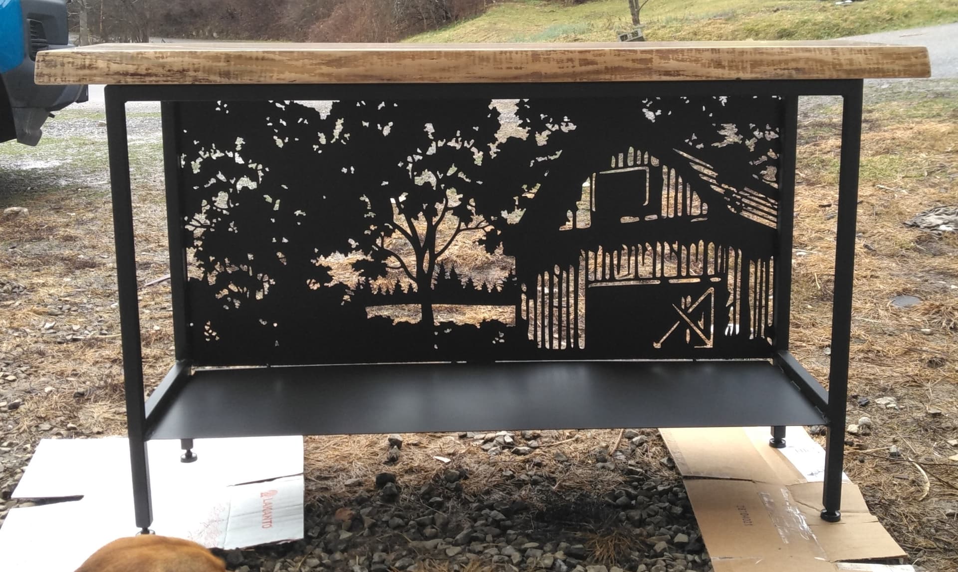

Here is a new project I started over a year ago. I finally had time to finish it during the holidays.
The wood is live edge curly maple. I am not a wood worker there are mistakes but they are mine.

That top needs a good oil finish to bring out the chatoyance!
I did polyclear polyurethane. Wasn’t sure the best finish for it. I filled some voids with epoxy. My research up up with polyurethane as best finish.

This table is about 60x14. It is curly maple and powder coated frame.

For the finish I would have done a flood coat of epoxy resin to create a really hard durable finish and sanded it down to 320 grit. Then a couple of coats of Rubio for a final hard oil finish. Depending on the use (desk vs accent table) I might follow that up with one of the nano coatings for more durability.
Poly is a film finish and won’t really soak into the wood far enough to make a truly durable (as in years of daily use, water resistance, etc) finish. Epoxy and hard oil finishes soak deeper into the wood and alter the structure of the fibers so the finish isn’t just sitting on top of the wood. The downside is the cure time. Epoxy needs days (for big projects like tables using slow cure epoxy) and hard oil finishes need a month for polymerization unless you use one like Rubio which use a catalyst accelerator and then you’re good to use in 24hrs and full cure in a week.
I like the combination of epoxy and Rubio because I don’t like the shiny finish of epoxy and prefer the softer look of the Rubio matte or satin finish.

Awesome I appreciate the tips. This top I put 4 coats of polyurethane then wet sanded with 2000 grit. it has a void on the bottom I had filled with epoxy. I researched around and found polyurethane was the best thing for epoxy.

That would make an awesome two-person dining bar for a patio area. Some form of a back-lit strategy might make it pop.
Yes Sir I am planning on a back light and will probably make a wood cover for the bottom shelf.
