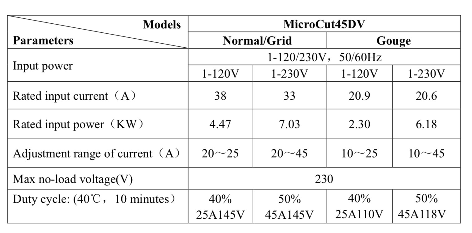

Does anyone else have experience with HTP Microcuts? I am not doing production, and speed isn’t too important, and my wiring limited me to a 50A 240V breaker.. I got one based on my experience with their tig cooler, and their spot welder - which is really nice. Was looking for a “discount” plasma dedicated for these little CNC tables.
I was navigating first cuts on an exhausting thread :slight_smile: but noticed that the speed estimates in their manual seem way off.. where they recommend 49 IPM for 1/4 SS but I am only getting decent results closer to 28 IPM.
Is this a common issue if not getting a hypertherm or miller, or other high end machine?
That should power any reasonably powered Plasma Cutter. Bear in mind that a Plasma Cutter unit is a power converter. Even a 100A PC doesn’t draw 50A at 240V on a continuous basis. The THC voltage of 110V at 50A is only 5500W.
Yep. Makes sense.
The HTP required 40A breaker in the manual based on max input current of 33A. With a max output voltage of 145V and max input power of 7kw. Looks like they are being a bit conservative.
