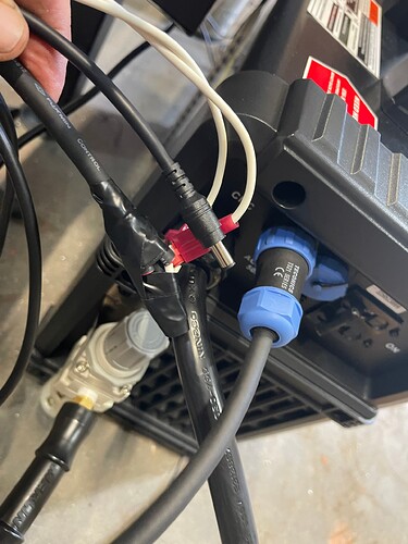

I’m sure this has been asked multiple times but I have completed my assembly of the Cross Fire Pro and I’m planning to pair it with the Primeweld cut 60 3rd gen through the CNC port. Do I connect wires #1 and #2 of the primecut to the torch controller pigtail, or is it not that simple? Thanks for the responses looking forward!
yes, pins 1/2 are for the torch on /off. polarity doesn’t matter.
Thank you for the quick response, I didn’t want to do something stupid!
