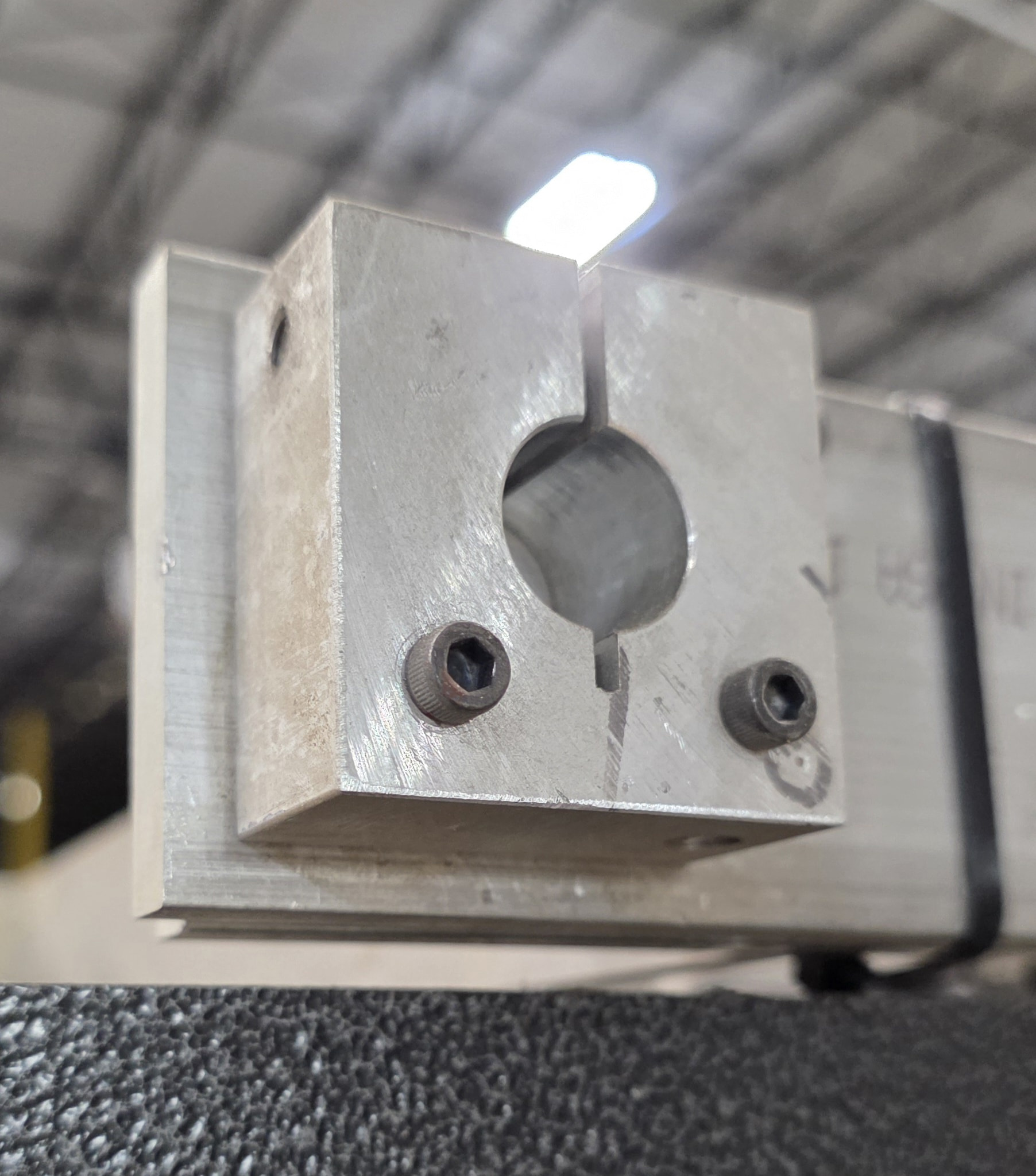

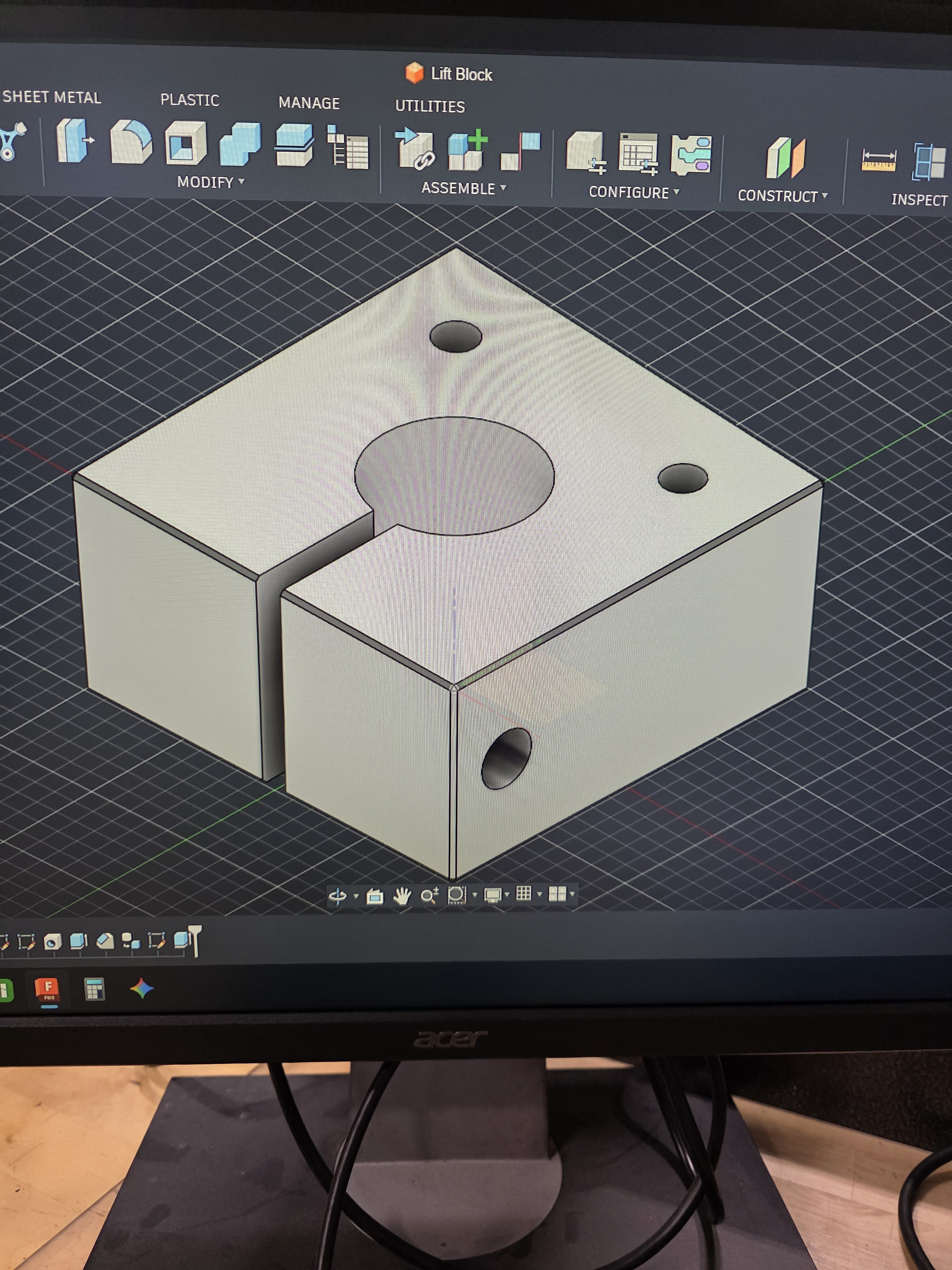

My company recently purchased an mr1 and since I i’m already familiar with fusion 360 (I 3d print tools and fixturing for assembly lines) I’ve been chosen to learn the new machine . The machine was purchased primarily to make parts for pneumatic lifts for gravity flow racks . These are generally small parts made out of 6061 extruded square aluminum . The most complex part I need to make is a block to secure a stainless steel rod (Pic attached). My first question is how do I machine these blocks level and flat when I am cutting them from a 20 ft piece of aluminum with a bandsaw? My second question, for now, is what is a good method of boring that Center hole? I’ve created the operation in Fusion manufacture , but I wanted to get some feedback on whether I am using the right method and the right tools. I would really appreciate any help / feedback. Thank you guys!

  1. Cut the stock a little thicker than part
    steps 2 - 5, end mill is fine
  2. Surface one large face, turn over, then surface the opposite side to the correct thickness
  3. The original first face is now you base reference
  4. If you need dimensionally on side dimensions, then face each of the four sides
  5. Zero x/y on one corner, then bore the large hole
  6. Drill the clamping bolt hole with a drill press or use the mill with a drill bit
  7. Cut the slot with a band saw
  8. Debur with a tumbler
hope this answers your question.

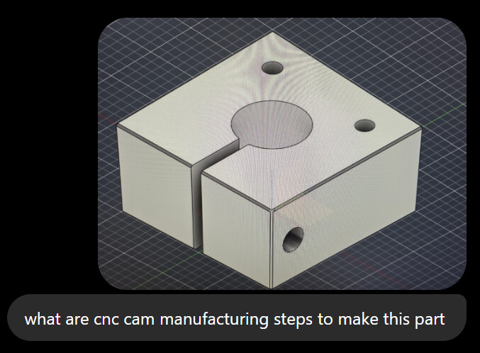

Here’s what chatGPT said
For a part like this, I’d make it from rectangular bar/billet on a 3-axis mill in 3 setups, with the split cut made near the end so the part stays rigid.
Setup 1 — Top side
Clamp oversized stock in a vise on parallels.
  1. Face mill the top to establish Z0.
  2. Rough/finish the outside profile if the raw stock isn’t already at finished X/Y size.
  3. Machine the large center bore
    • 2D adaptive/helical bore for roughing.
    • Circular finish pass or boring operation if diameter/tolerance matters.
  4. Spot/drill the two top holes
    • Drill, ream, counterbore, or tap as required.
  5. Machine any top-side chamfers.
  6. Do not cut the split slot yet.
For CAM, this is basically:
  • Face
  • 2D Adaptive / Bore
  • 2D Contour
  • Spot Drill
  • Drill
  • Chamfer
Setup 2 — Bottom
Flip the block onto the finished top surface, preferably in soft jaws.
  1. Face the bottom to final thickness.
  2. Finish the outside perimeter if you left material during Setup 1.
  3. Add bottom-edge chamfers/deburring as needed.
If the billet starts very close to finished thickness and the bottom doesn’t need machining, this setup may be minimal.
Setup 3 — Side hole
Rotate the part 90° and locate from the finished top/bottom and side surfaces.
  1. Spot drill the side hole.
  2. Drill through.
  3. Ream or tap if required.
  4. Counterbore/countersink if the design calls for it.
If that hole crosses the eventual split, drill/tap it before cutting the split. That keeps both sides of the part rigid and aligned.
Final operation — Cut the split
I would make the narrow cut from the outside into the large bore last.
Best method is probably a slitting saw:
 outside edge
      |  slitting saw travels →
      +----------------( large bore )
A slitting saw gives you a straight, narrow, consistent kerf and puts much less side load into the two resulting “ears” than trying to bury a small end mill.
If the slot is relatively wide, a small carbide end mill using a 2D contour is also reasonable.
Recommended overall sequence
Saw billet → Face/top features → Large bore → Top holes → Side hole → Bottom/outer dimensions → Split slot → Chamfer/deburr → Inspect
The important part for this geometry is machine the bore and cross-hole while it’s still one solid block, then slit it. That gives you the best concentricity and avoids the clamp sections moving during machining.

I took a crack at your clamp block in Fusion and attached the file (clamp.f3d). Here’s how I set it up. It should
cover both of your questions.
Getting it flat and square from bandsawn stock. Don’t try to use the sawn faces as references. Saw your blanks about 4
mm over in every direction and let the machine make the part square. The file uses 2 mm of extra stock on every side,
top and bottom. It’s done in two vise setups:
  • Op1, top side up. Face the top flat, then rough and finish the outside profile down to 5 mm above the bottom. Rough
    and finish the center bore, and mill the two 8 mm mounting holes. The bore and holes stop 0.5 mm short of the
    bottom. Use parallels so the vise grips the bottom 7 mm or so of the blank.
  • Op2, flipped. Clamp on the finished sides, face the bottom down to final thickness, and finish the last few
    millimeters of the outside profile. Then break the bore and holes through.
Facing both sides from finished references gets you parallel faces and square sides no matter how ugly the saw cut
was.
Boring the center hole. With a 1/4" end mill, I’d use a 2D Adaptive to rough the 25 mm bore, leaving 0.2 mm on the
wall. Follow it with a full-depth 2D Contour finishing pass. A helical Bore op works great for small holes like the 8
mm ones, but on a big hole it leaves a slug in the middle. If you need a tight fit on the rod, sneak up on the size
with the wear offset or a second finishing pass, and check with a pin gauge.
Cross-bolt hole. Op3 stands the part on its side. It mills a 2 mm-deep pilot with the end mill so the drill starts on
center. Then an 8 mm jobber drill peck-drills all the way through.
The slit. I skipped it in CAM. It’s narrower than a 1/4" end mill, so just bandsaw it after machining.
One gotcha worth knowing. The slit connects the bore to the outside edge, so the part’s bottom outline runs from the
outer edge through the slit and around the bore. Pick that outline for your profile ops and Fusion can get confused
about which side to cut. Mine plunged right into the part. The fix is a simple sketch: a square the size of the part,
a bigger square outside the stock, and a circle for the bore. Point the toolpaths at the sketch instead of the model
edges. It’s all in the attached file.
