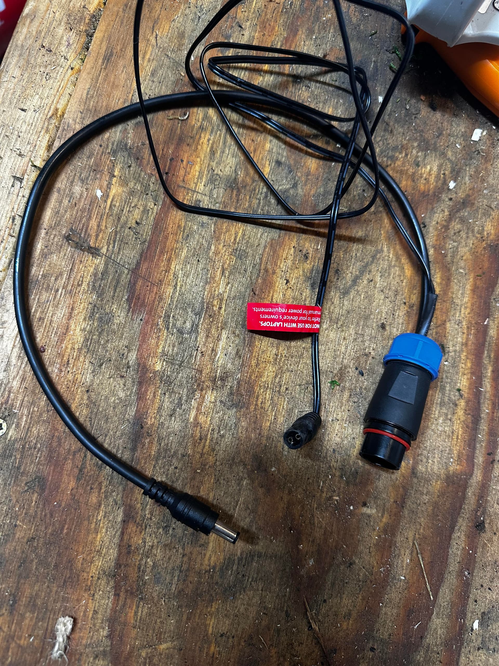

I just bought a brand new Crossfire XR off of FB marketplace because the previous owner passed away before ever making a cut on it. I am running into an issue where when I set it to cut anything it will move around like its doing a dry run but it won’t actually cut anything or blow any air. I followed the attached video to do the plasma cutter wiring. I did have to do some rigging for the torch on off wire due to it not coming with the machine where I took the cable from an old charger with a similar 2-prong connector on one end. it needed some modification to fit in the port but it seemed to go in alright. I was trying to avoid finding an actual replacement. the plasma cutter is a prime weld cut 60 if you have any other questions or need additional photos let me know.
this is the “custom” port
That plug doesn’t fit a primeweld 60
You will need to follow the directions to wire the Blue CNC port on the back.

That is how I have it wired. My custom plug is what plugs into the torch on/off port on the back of the table control box.

That torch on/off plug is not an aircraft-style plug. How did you get it to fit? That’s a first, but it works. When the machine is running, the torch should fire if you jump out the two pins on the homemade plug.

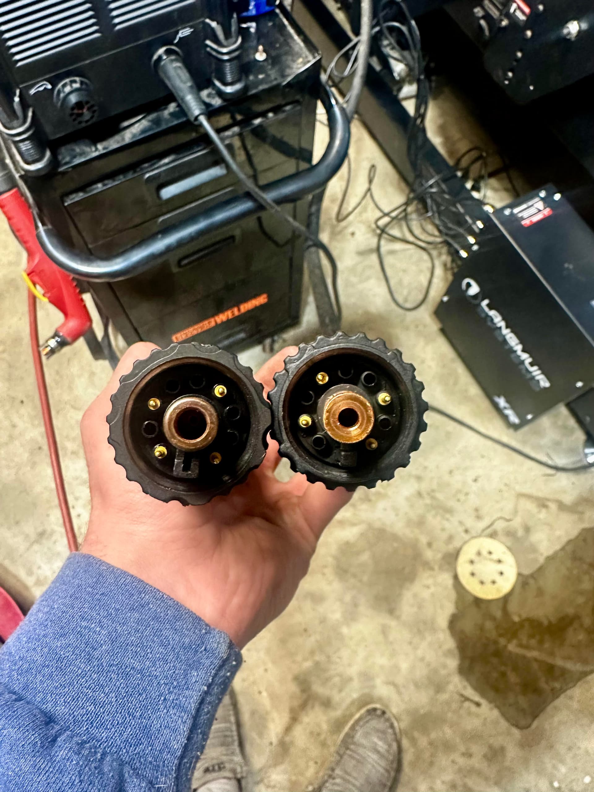

I have a Machine torch connected to the gantry of the table, and a separate hand torch that works by itself
Are the pins at the plasma end the same? The machine torch will have two less pins but the pins that are on it should match the hand torch.
Two pins in 5 and 6 pilot arc.
Two pins in 1and 2 torch on/off
they seem to be different, the one on the right is the machine torch and the left is the hand torch.
There is the problem. Can you read the numbers on the pins?
Send a message to @mechanic416 . His name is George. He can tell you how to move the pins.
Yes, it is the same as the picture you sent
They are totally different.
