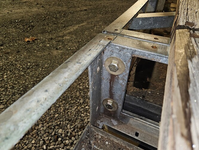

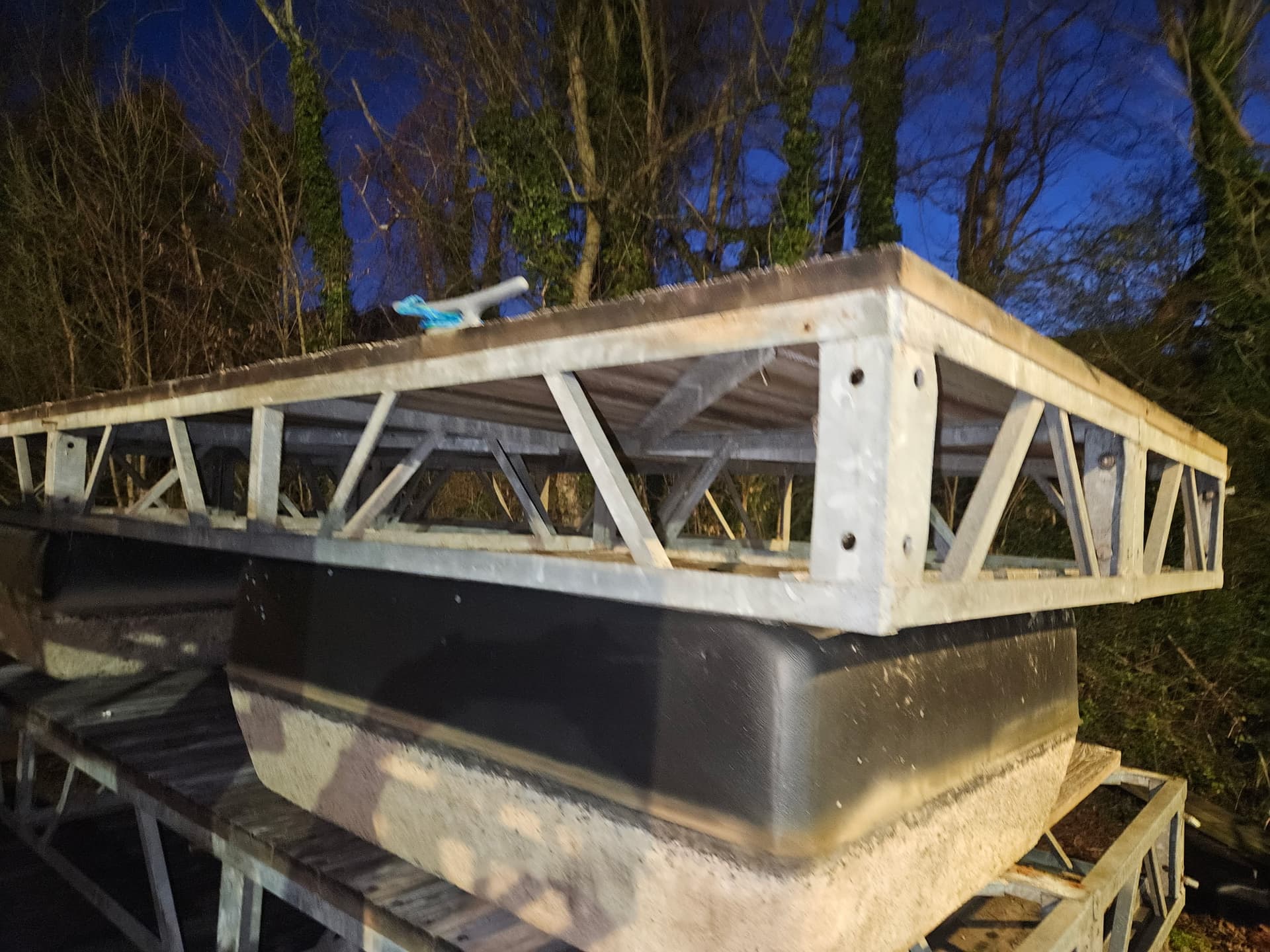

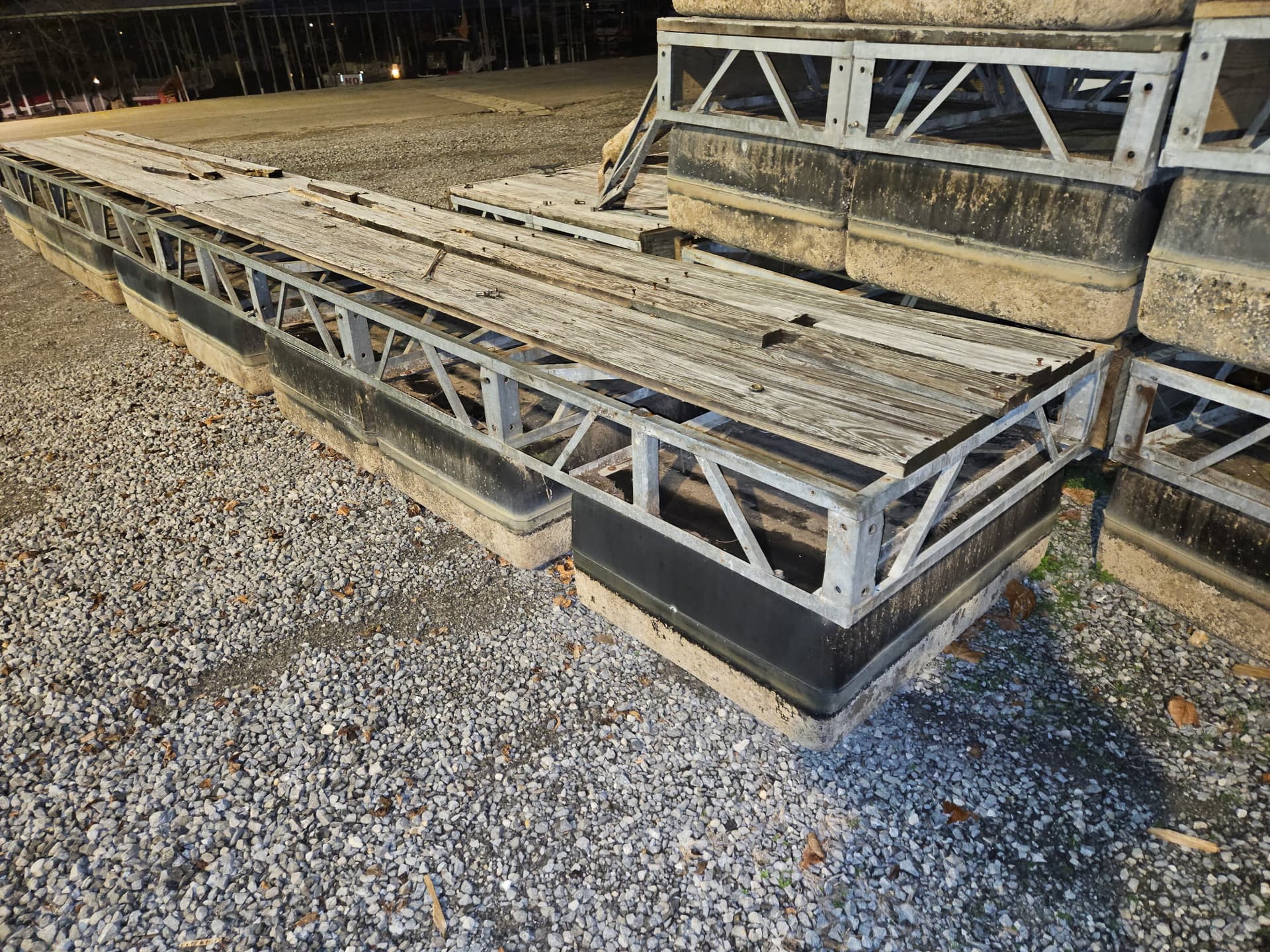

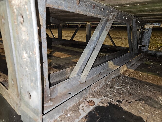

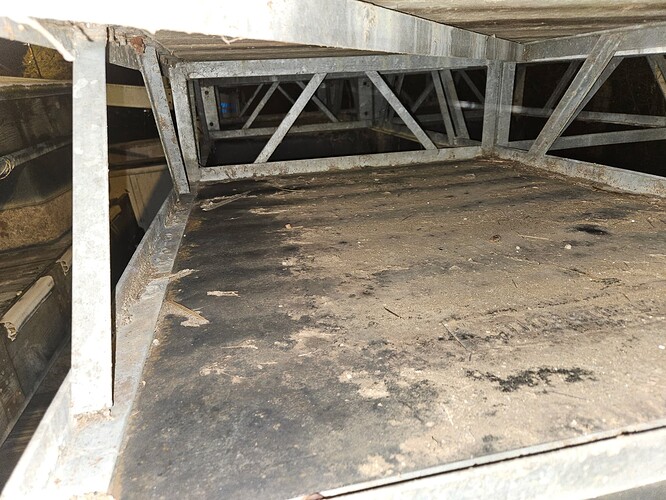

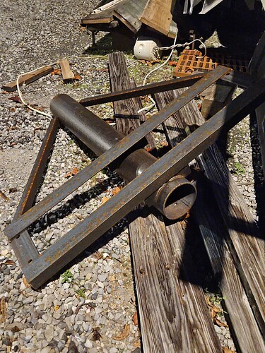

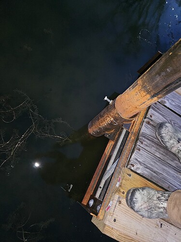

We build them several times a year. I will send some photos. I recommend making it at least 6 feet wide.
You will need to make spud pole brackets and sleeves to let it float up and down. I will send you pictures of a spud pole and bracket.
You will need to fab a gang plank to land. The length depends on how much the water level will fluctuate.

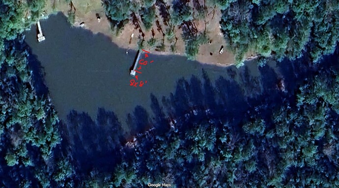

Some more details… Current static dock is:
Gangway: 4ft wide x 60ft long
T Head: 8ft x 8ft
I’d like to have a t-head still, so the wife and I can sit out there and enjoy the tranquility / cast some lines (plus the dogs), so thinking about at least a 10ft x 10ft T head, maybe larger (but $$$$).

It doesn’t have to be metal. These are commercial docks. Plus, the water here at the marina can rise and fall up to 7 feet. The spud poles need to be on each side to keep it from becoming a roller coaster. A 10x10 dock.I would use 4 spuds at each corner. Those floats bolt on and you would only need maybe 6 or 8. Plus decide how high you want it to float. Ours are 3x4 -24 inches high. They make 16 inch and 12 inch thick floats. 2 x 10’s are heavy if you make a 10 x 10.

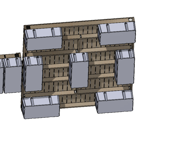

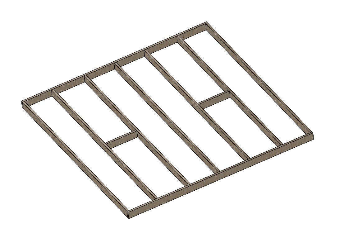

The floats I was looking at were 24Wx48Lx16H. Plans recommended 5 of them for a 10x10 dock (7 for a 12x12), constructed of 2 x 6 pressure treated lumber:
https://dockedge.com/wp-content/uploads/sites/3/2019/06/swimdock_10x10_E.pdf

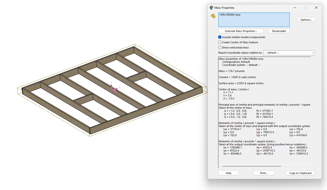

I CADed up a quick n dirty frame as they had in the plans above. 2 x 6 construction on just the frame is 135 lbs, roughly.
I am open to alternative floats if there is money to be saved, however.
I like what your looking at for floats. 3x4 x16 should be sufficient. I would do 3 on each side and 2 in the middle.
Nothings cheap. Consider 2x8’s. The weight won’t be an issue. You may get away with 6. Just remember they will be difficult to install once it is floating.
2x8’s in a 12x12ft frame (per https://dockedge.com/wp-content/uploads/sites/3/2019/06/swimdock_12x12_E.pdf , which also calls for 7x 550lb floats) gets me to ~177lbs of framing timber (reg pine, not press treat), without decking, fasteners, or brackets / carriage bolts etc.
Looks good. The thickness will make it float higher. Having 15 or 16 inch to the water.

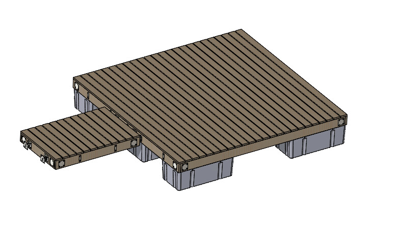

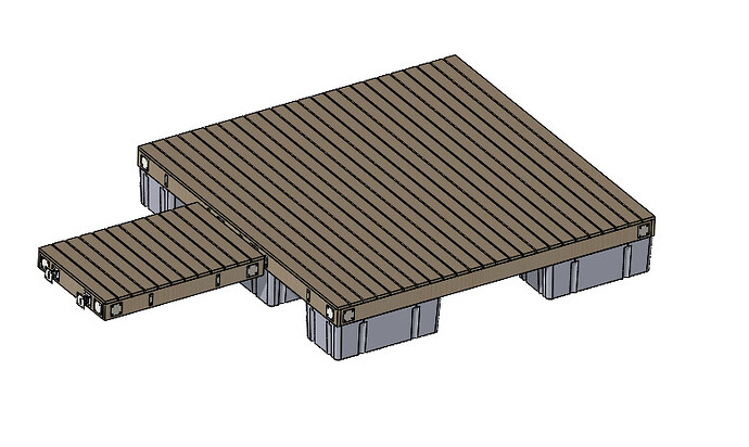

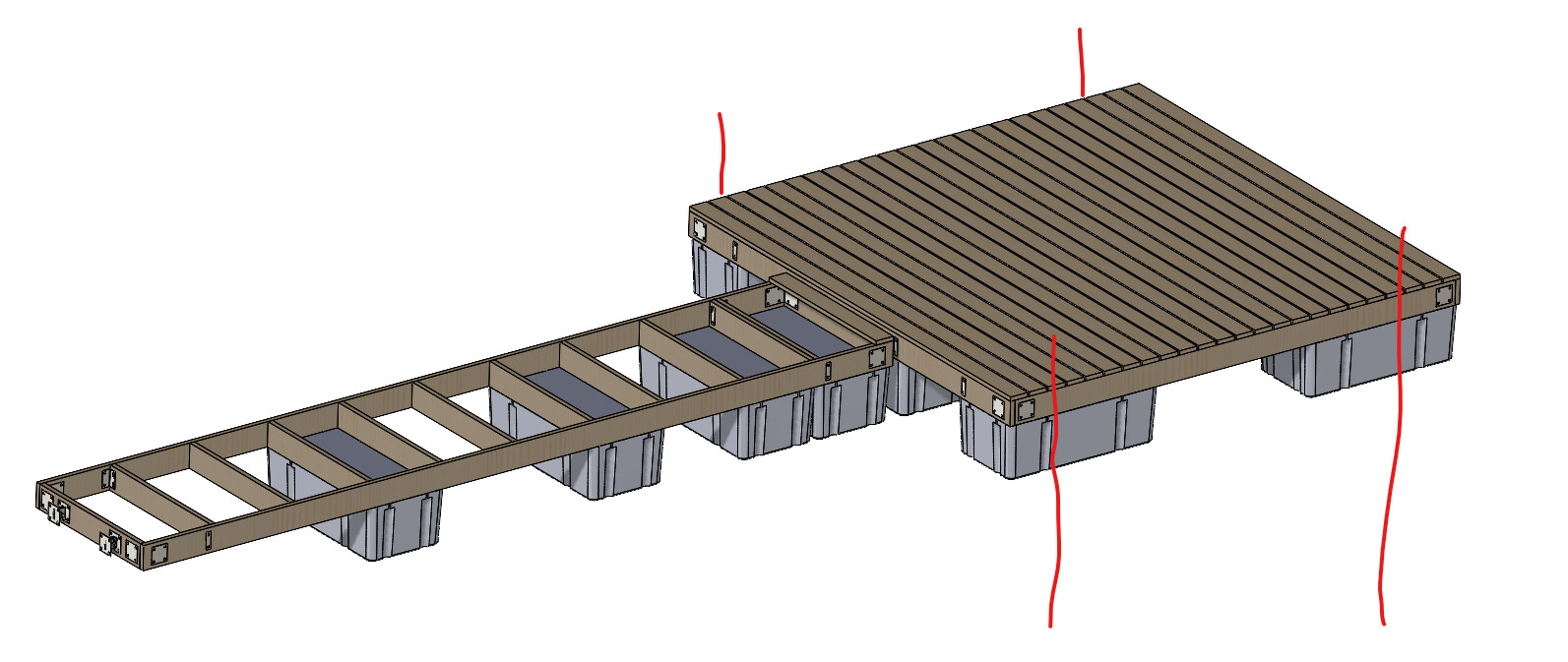

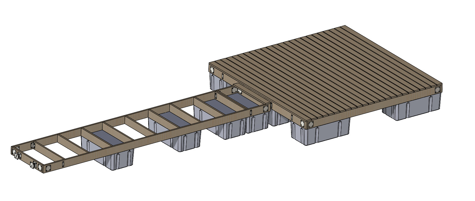

Just an update. CAD-ed up a couple full featured models of the idea I had. Here’s it with a 20ft x 4ft floating gangway that would be anchored on land with pinned hinges to allow for water height changes:
Doubt that I would need that many floats on the gangway, since some of the buoyancy load will be transferred to the land.
The T-head uses 7 floats of 550lb ea.
Still have to make the “spud pole” brackets and figure out where to place them, but considering this pond sees little height variation (maybe 2 ft) and essentially no waves, I would think having 4x total, at these locations, with more of a “slot” for the guide poles to account for water level drop, would be sufficient?
Last thing I need to do is determine the max water level of the pond, and then based on that where to create the pad to anchor the gangway to, and then how long to finally make it. It wouldn’t need to be as long as the current dock (60’ gang, 8’x8’ T-head) since it floats. Making a 60ft gangway would be cost prohibitive too. This thing is already knocking on 4 digits.
Alternatively, if I kept a length of the dock static, I could do a small section of a ramp down to the 12x12 T-head
I have one suggestion. You might want to add some pins in the spud pole brackets so you could lock the dock in place at high water level for future maintenance. You may want to be able to have the dock above water level to replace parts, treat wood, replace hardware,…
Ok, maybe two ideas. If you think you might ever want to add railing (grandkids, wheelchair access,…?) I’d go ahead and install some brackets along the ramp and deck sides. And/or, maybe just a gate at the ramp entrance.
Or hinge and pin them to release the dock to move for maintenance maybe…
Good thought
