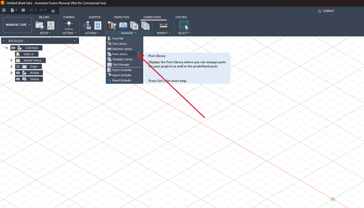

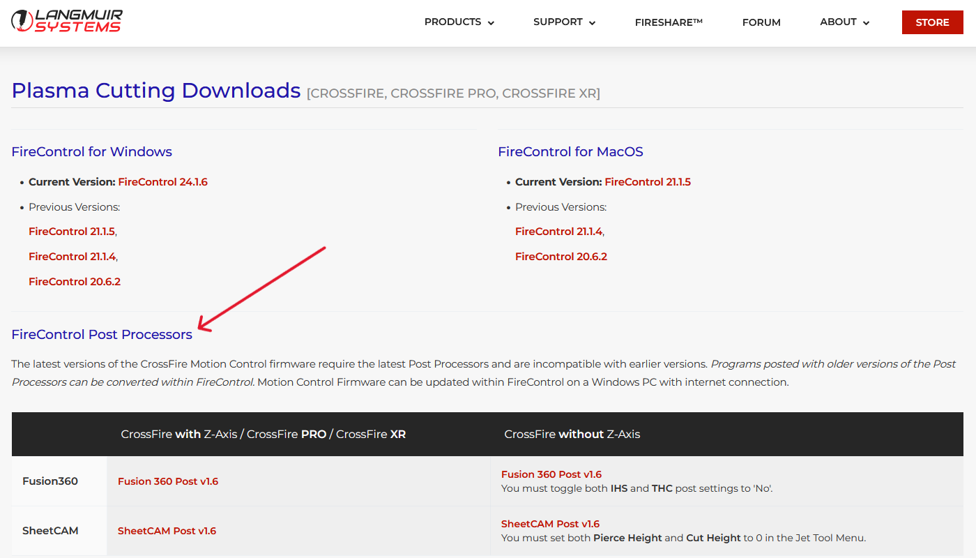

If you have a Post Processor error, you may simply need to download the file from Langmuir’s website and add it to Fusion.
After downloading, you add it by going to the Manufacture tab in Fusion, and go to Manage → Post Library. From there you import the file you downloaded and now you’ll have the correct Post Processor for Firecontrol.

Download from their page -

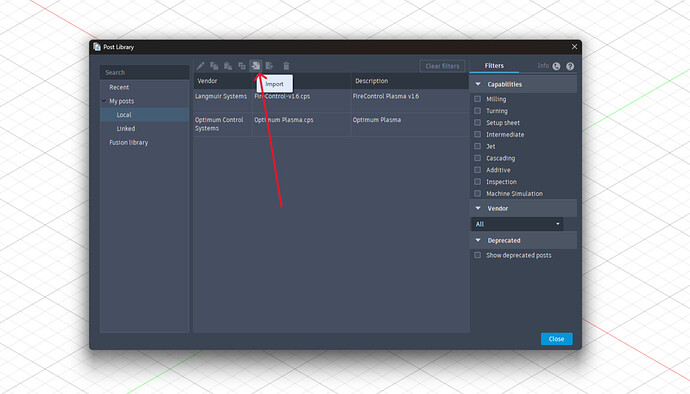

And as I mentioned, go to Manufacture and go to your Post Library -
After which you’ll need to choose Local and then Import the file you just downloaded; it’ll appear and remain in the list below
