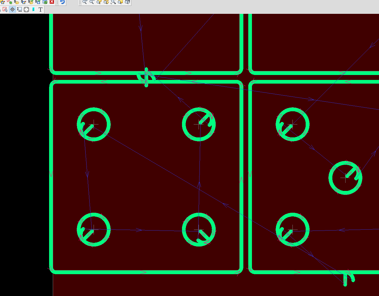

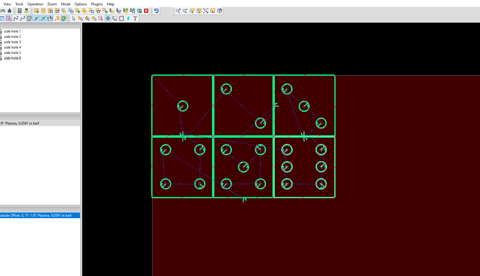

I’d like nest parts to share a cut edge, how do you do that so you don’t shrink your parts? If I simply nest on their edge, I expect I’ll be taking half my kerf width from each part edge.
I know I could oversize the parts when I draw them, but is there a simpler way in sheetcam or something? Seems like this must come up alot with a plasma table?

Thank you, so do most swirl rings go the same direction as that picture because I’ve had terrible bevel, and I noticed that sheetcam is running the toolpath the opposite way as your bevel drawing.
It’s counterclockwise outside and clockwise inside
Check the box for “reverse cut direction” in the Jet cutting operation screen.
Almost all plasma torches in existence will spin the plasma stream clockwise.
You can use Edit Starts to move the lead in/out location to an outside edge. This is so you won’t burn into another piece.
