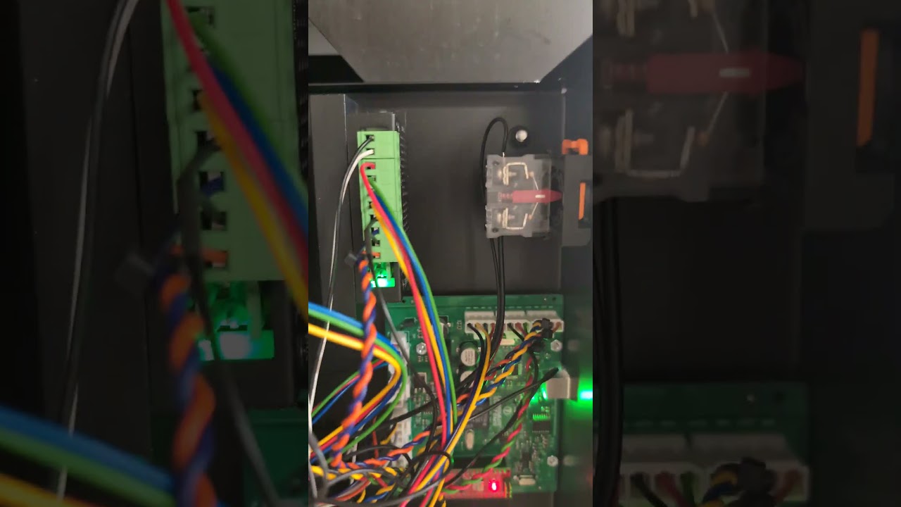

Friday i went to turn on the machine and it just clicks, repetedly, and the status led on the cutting head flashes green.
I have power to the motors because i cant turn the rails by hand.
Inside the electronics box The LS-THC module has a flashing red LED in the PWR slot.
There is also a flashing green led up by where the usb cable plugs in. All other leds on the other components are steady green and all fans run including the power supply.
I powered off the machine, unplugged power cable and removed the LS-THC module and the flashing stops but will still not connect. I have tried two computers both with the latest fire control and usb driver installed.

Zach with technical support reached out to verify some information. I am going to run a multimeter against the control board when i get home and hopefully we can fix this issue.
If you want to see what the machine is doing i have attached a short.
@FoothillsDesignNC Has Zack followed up with you on this issue?
Yes, I measured all of the voltages across the power supply and everything checked out. A replacement Motion control board has been shipped. I am waiting for the replacement and will post the results.
