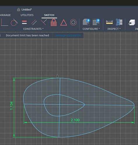

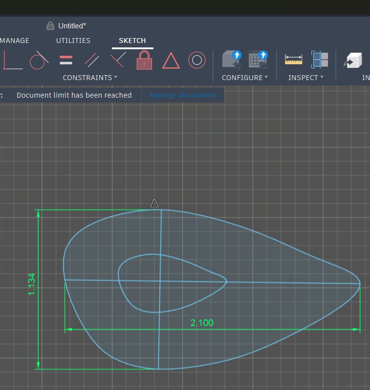

Item 1. Resizing. Are you opposed to just going back to CAD and resizing the shape, then regenerating you cut file?
If not, here is a dxf with the x axis dimension set to 2.1”. Also, is that really all that is supposed to be there? Just an oval shape? It’s all that is contained in you dxf.
This shows original size vs setting that x axis dimension to 2.1”
Oval DXF.dxf (8.6 KB)
Not adverse, just didn’t have success resizing in OnShape either. I tried resizing in OnShape with construction lines for constraints. First try it had no constraints. Next try it was overly constrained. Thanks for providing the corrected file – I’ll try it today.
