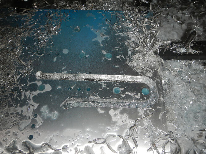

I am trying to cut parts out 3/8 plate al and it starts chattering bad and the extension starts coming out to the point it is jacking up my bed threw a sacrificial plate under neath. the 1/2 cullit is luse on the extension
and I half to tighten the _____ out out of it. short of buying a plasma table to do this is their any way of tracing out parts on the mr-1 mill?

Looking at your part… you need to add a region where you helix the tool down for each step height and you need the width of cut to be larger than the tool. It’s not a plasma table, you can’t just plow the whole tool through the material (at any step down). Your chips are a lot more “long and stringy” than they should be.

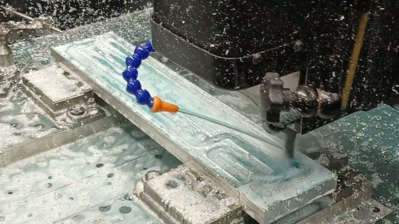

  1. ditched the extension shaft.
  2. Used 2 Large slabs of 1” and 7/8” al as the sacrificial plate under neath to raise the part up to the cutter height
  3. clamp the _____ out of it and fully supported under neath.

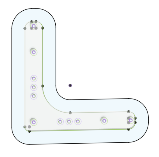

  4. for the cutout make an outline ~2 x cutter dia away from the part and use adaptive clearing down to ~0.05 away from the bottom, so 3/8-.05 depth of cut. Tried up to 60ipm with a 3/8” and did not brake anything nor was she groaning.
  5. do a final cutout using 2d couture with .03” tall tabs and 2 passes.

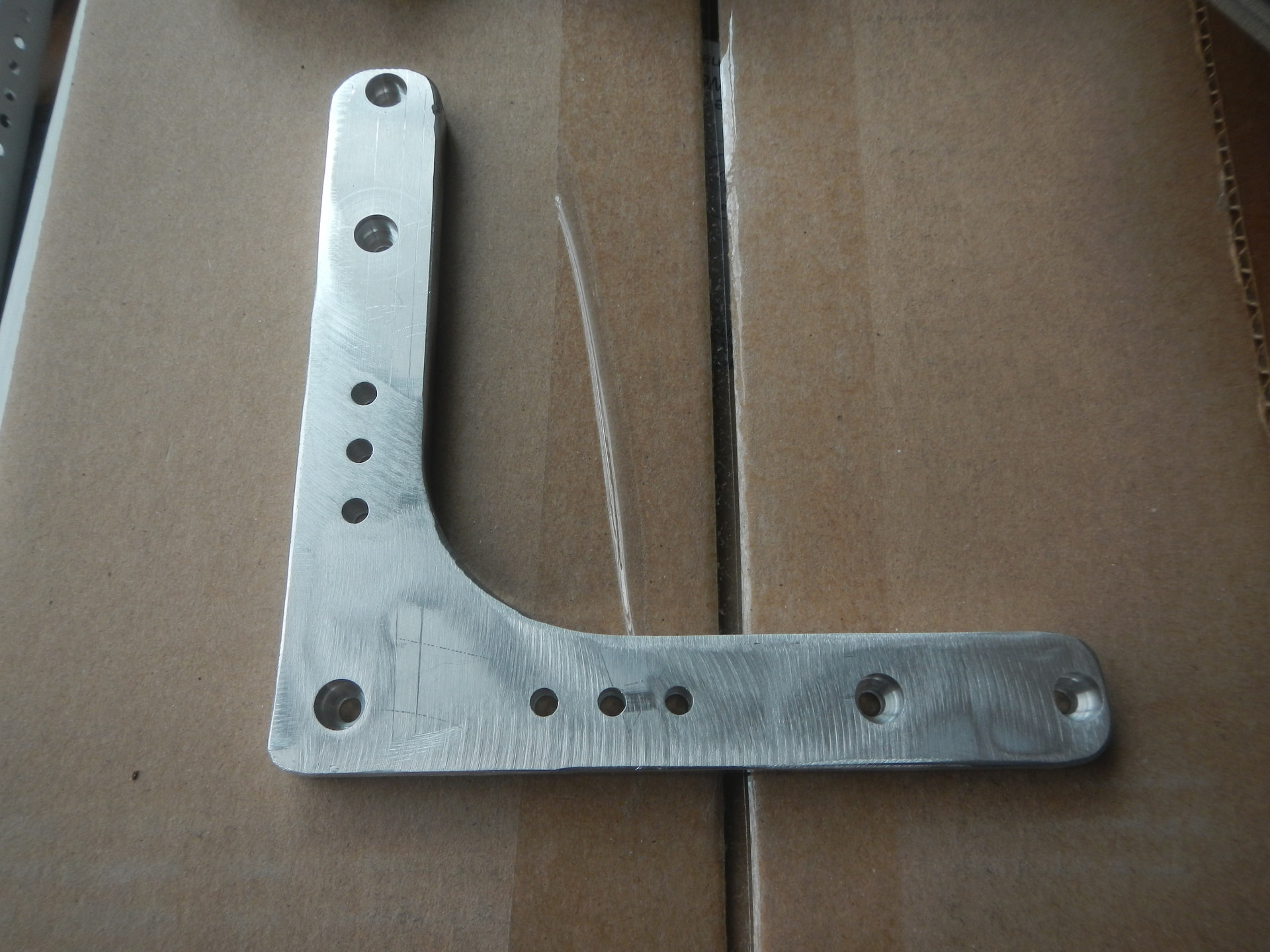

All in all it took ~ 17 min of milling time to counter boor and cutout one part. Each leg is 6” long.
All the scrapes are from smoothing things out with a flap wheel(tab cutoff removal and smooth out the sharp edges).
so if you’re full width slotting in aluminum I would use a 2fl endmill (3fl if you’re not going too deep). The most I’ve done is 2x diameter in a single pass. I’m not really a fan of that because it’s hard to get rid of chips that large. Now days I go more shallow and move faster. Small chips are much easier to clear and also don’t stack up as fast as the large chips. you can fit more of them in the machine. Here is an example of some full width slotting in aluminum. My feeds and speeds are in the video description

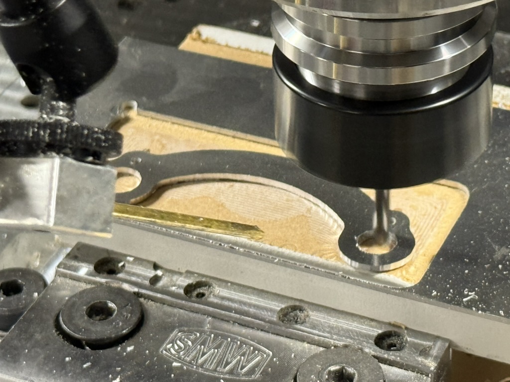

Richard’s advice is good. The other thing that I’ll add is that you can avoid tabs just by CA gluing down to MDF and then breaking the bond afterwords. There are a lot of videos on youtube with this technique. The other advantage is that the MDF supports the part so you don’t get those vibrations.
This photo is an example where I did that and used adaptive clearing rather than slotting. I didn’t time it both ways, the piece was just small enough that adaptive clearing was a pretty fast strategy:
Did you run it with coolant or dry? Was the MDF dust any kind of a problem?
My machine is setup with MQL (fogbuster) and I turn the coolant down very low. I haven’t done this with flood coolant.
