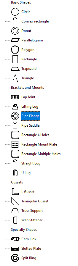

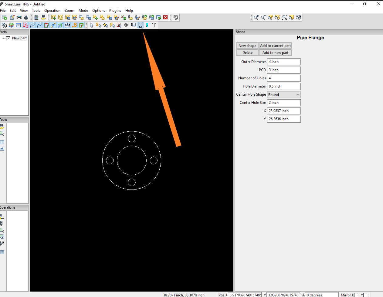

SheetCAM does have the ability to make some simple and common parts in its “Shape Cutting Library”
maybe a simple way to get started if the shapes suits you.

Wooooo! That’s a feature I didn’t know sheetcsm had. Guess I should explore the software a little more beyond just post processing with it.
Never used sheetcam for moar than simple cam, thanks
