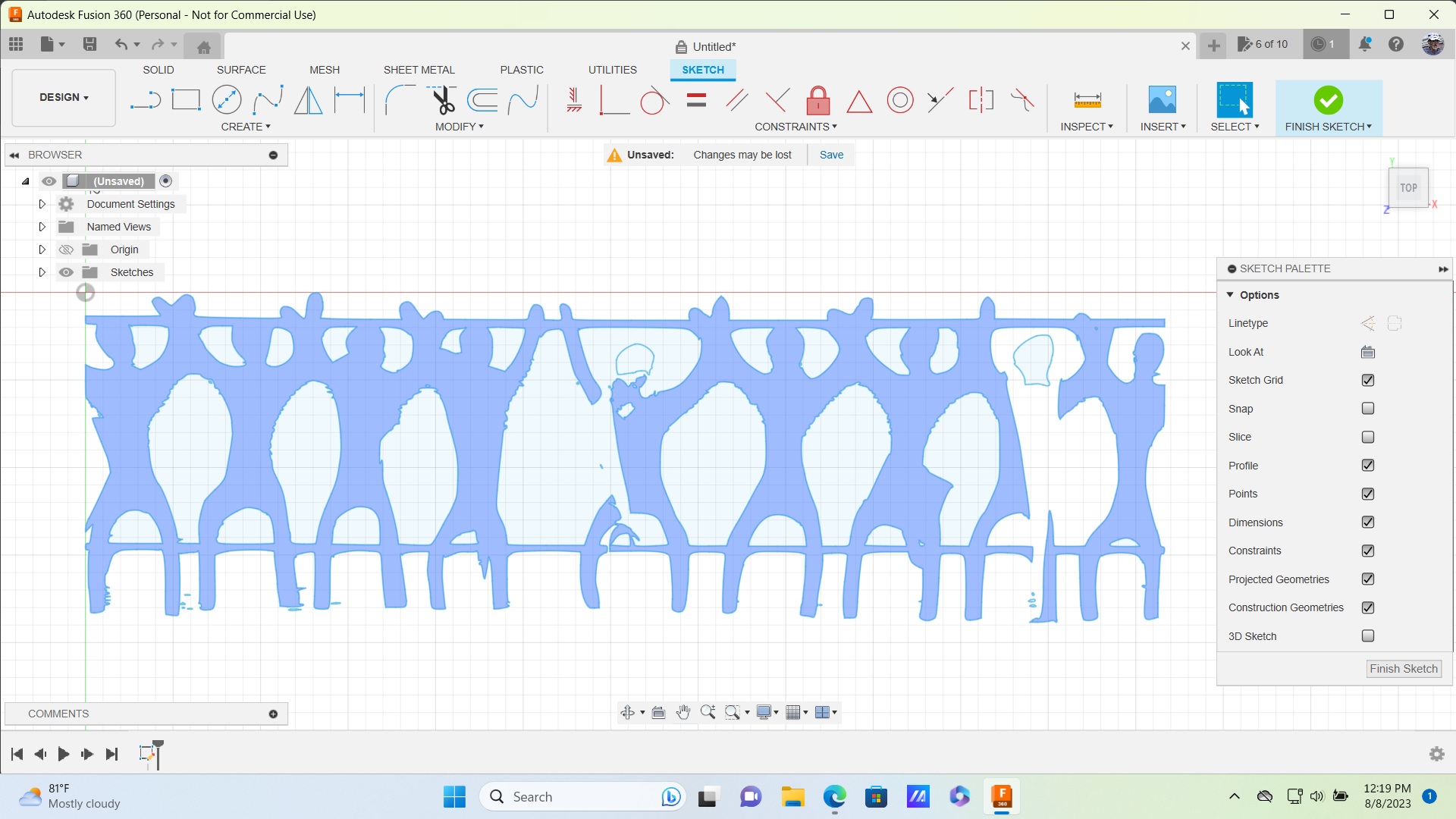

Just sitting here eating my lunch and threw a converted version into Fusion 360. Looks like getting 5 good ones out of that would be pretty easy.
The first 4 guys plus number 6 looks doable. If you don’t get any offers in a day or two, let me know and I will help you.

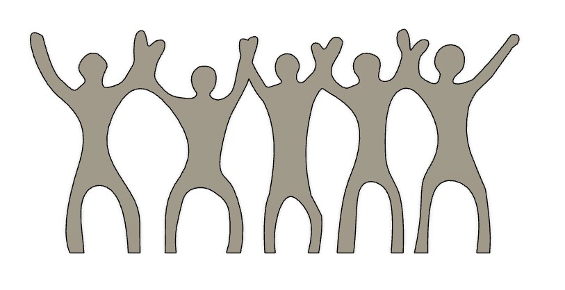

People.dxf (529.2 KB)
So best way to do this in under 5 mins is use canvas feature in fusion with your image. after that just a matter of scaling it to size. Nothing needed for DXF. GL and post pic of your projects!
People 6inch tall_.dxf (1.3 MB)

@Wsidr1 what conversion program do you use?
@DonP I didn’t even think about the canvas. I assume you just used the spline tool and traced it out?

Yes, I just used spline tool. Even when you use Inkscape Trace bitmap you’ll find 95% of the time you’ll need to go fix lines. Many times, I use mirror so things are symmetrical but I didn’t on your people since it seemed like the look you wanted. Fun project and love the little scarfs.
I used Convertio. I think a lot of folks on here use it with good success. You can convert jpegs to svg or dxf to load into CAD programs.
Works pretty well and it’s free.
