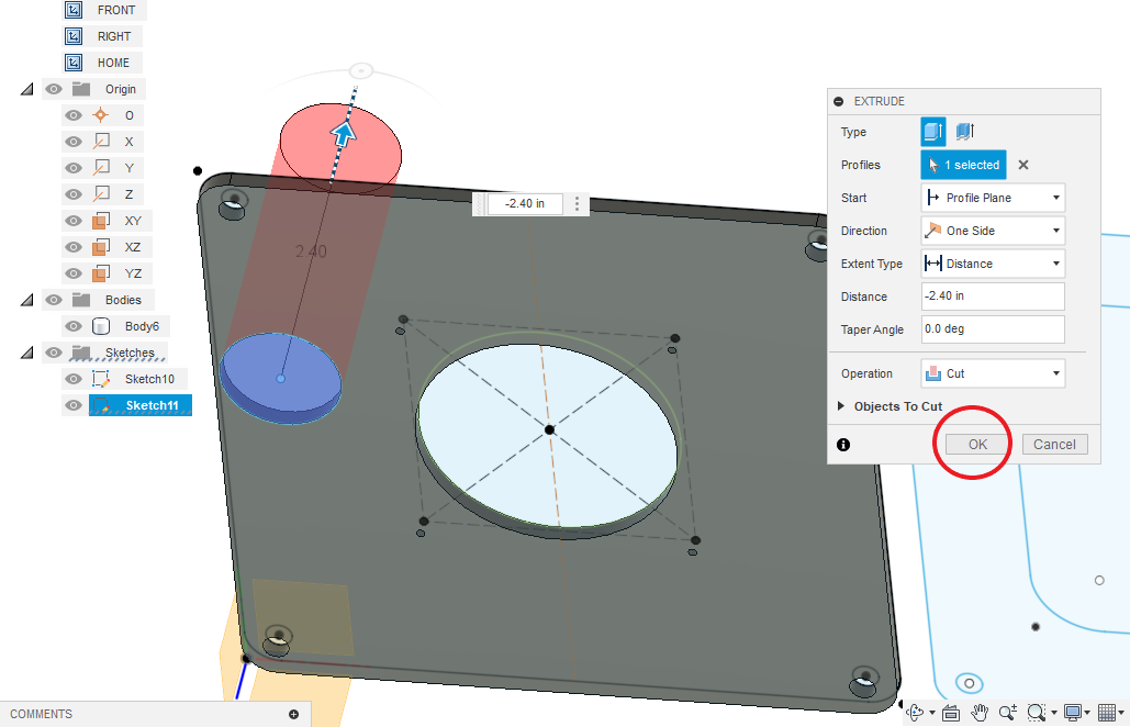

Once you have created the body, you can change things by several ways:
  1. Create a new sketch on the face of the body and then do an extrude “cut” with the new features. OR

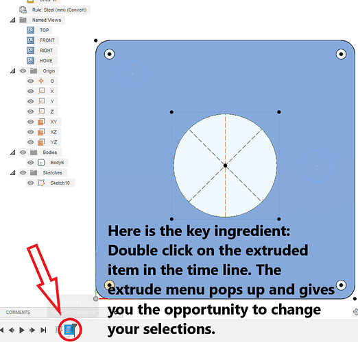

  2. Edit your sketch and then edit the “extruded body.” I will show you this second one.

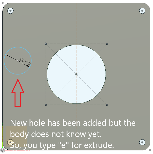

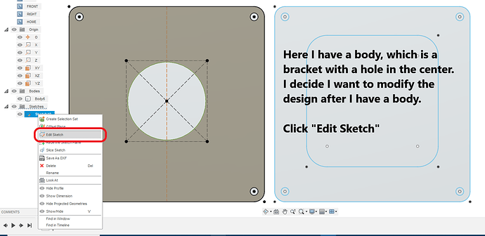

You “edit sketch” by turning on the eye of the sketch (if it is not already visible), right click on the sketch and left click on “edit sketch.”

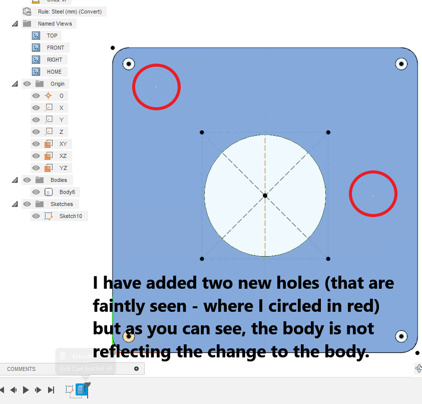

I close the sketch and see that the holes I have created are not visible in the body:

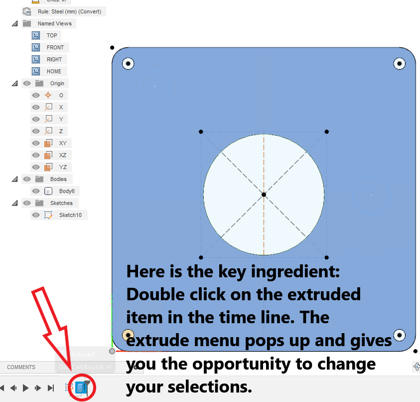

To make the body realize these changes, I wake it up by double clicking on the “Etrude” item in the timeline.

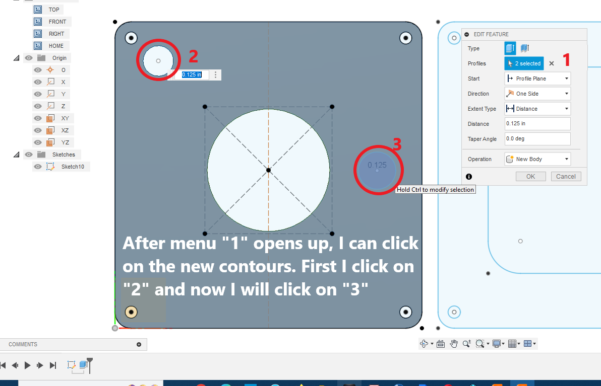

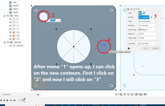

This new menu pops up and as I click on each contour, they are instantly added to the contour selection and reflected in the body by making the holes.
When you are done selecting all of your new changes, click “OK” and return to manufacturing. In Manufacturing, you will see that your tool path is now saying it is out of date. Use the drop down menu on the tool path and click on “generate.” This will reflect your new contours in the tool path.

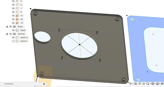

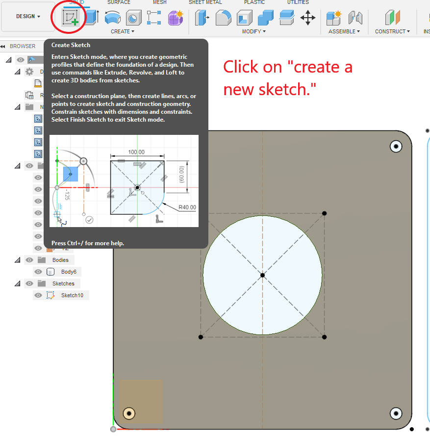

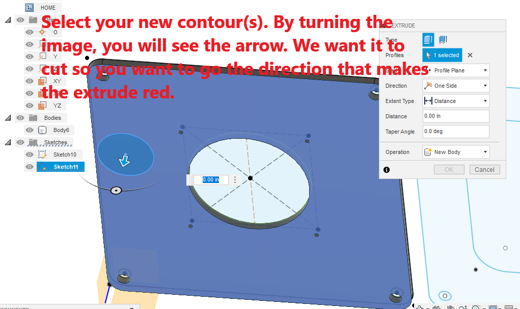

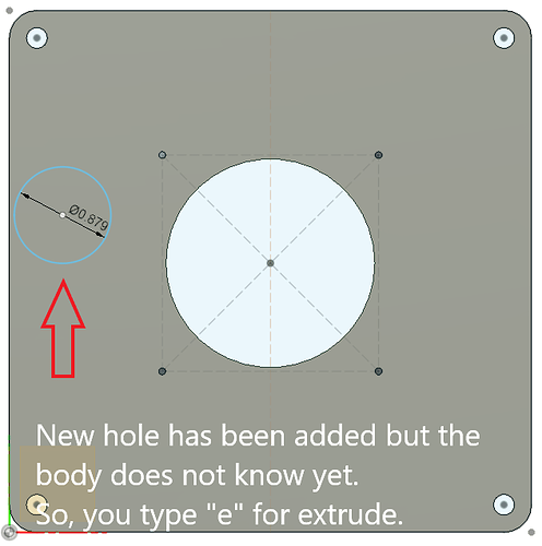

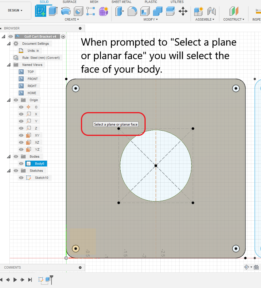

The next method is what I often use because it is actually fun. You create a new sketch/contour on the body face and then perform an “extrude” cut.
And you already see that it has happened but here is your newly revised body:
