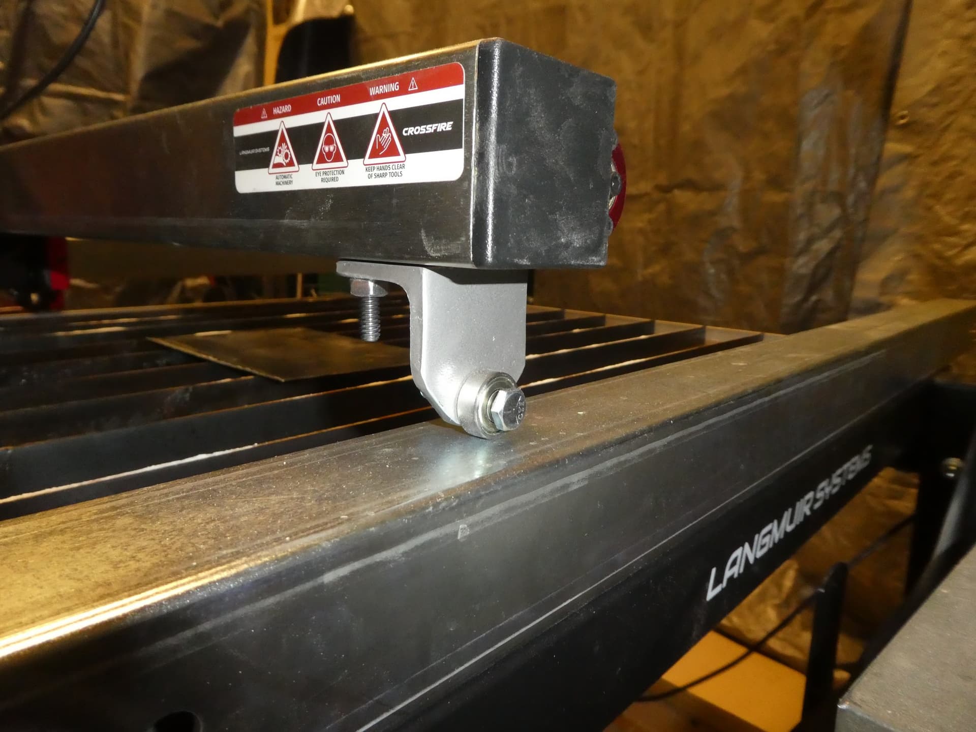

I think I will do what others have and add a support track and bearing at the far end of the X-axis. After a lot of frustration I got the tube level and did a dry run for my first project. I then left town for 3 weeks. When I came home the X-axis arm had sagged 3/16" at the last slat. I know the 8 screws are tight so there must be enough flex in the Y-axis tube to allow the sagging.
The tube steel will not flex. The gantry bolts hold the x axis in place so any movement is usually here. One other location of possible flex is if the y axis plate bolts aren’t tight enough holding the upper and lower y steel tubes.
But yes, if an issue, adding a roller of some sort on the end tip of the x axis will remove any vertical sag.
I have the XL tubes on the y axis and taller plates I cut with the table to add extra space for cutting thicker stuff like tube steel. With all that, I do not have sag and the THC Z axis is installed.
Do what fits your needs best.

Problem solved. Because I got the extension kit I used to standard rail for the track with a bearing. Variation is not much more than 1/32" over the whole table.
Nice job. Does it roll smoothly? Great idea.
Very smooth.
