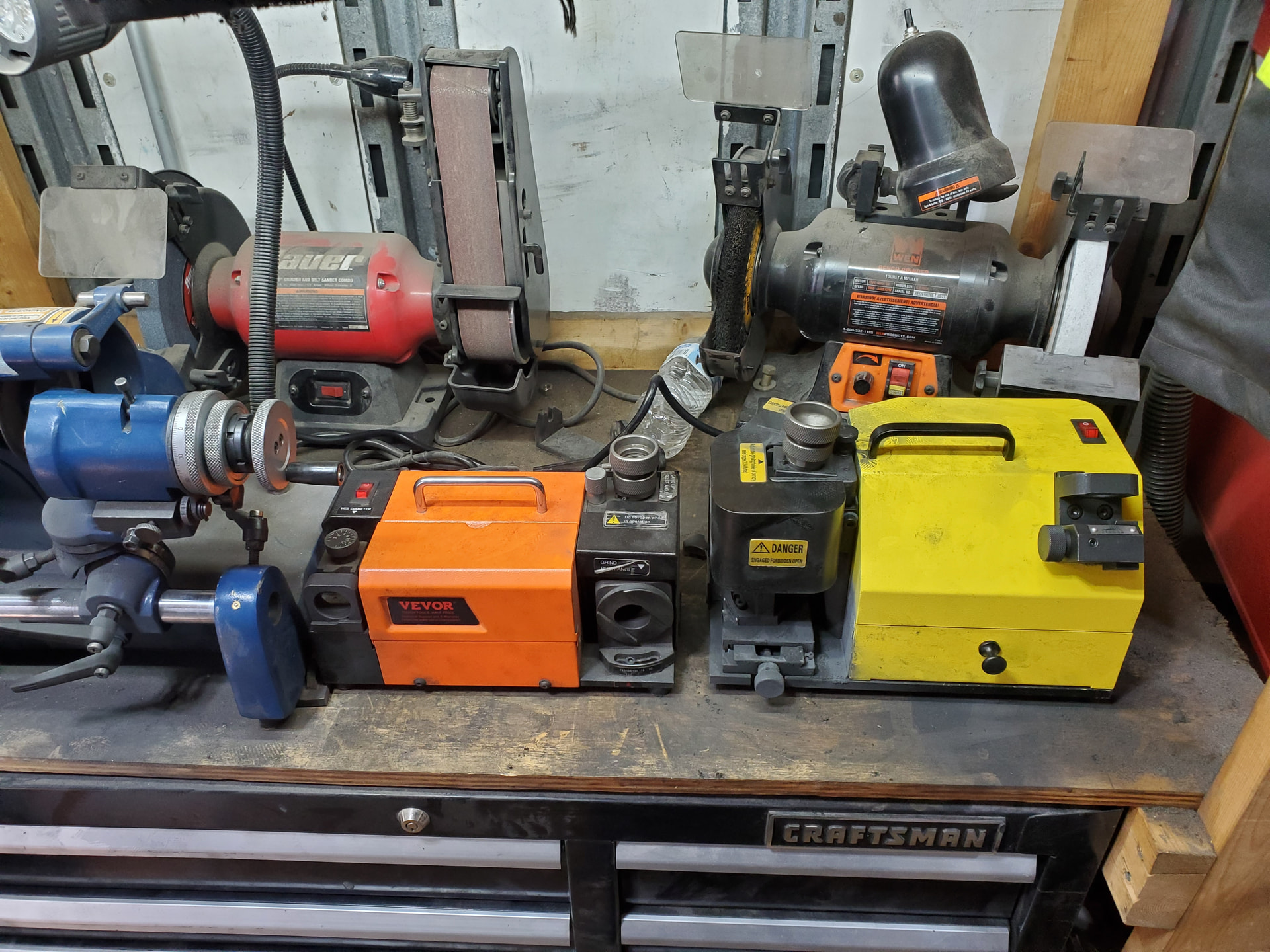

My two favorite tools, drill bit and endmill sharpeners

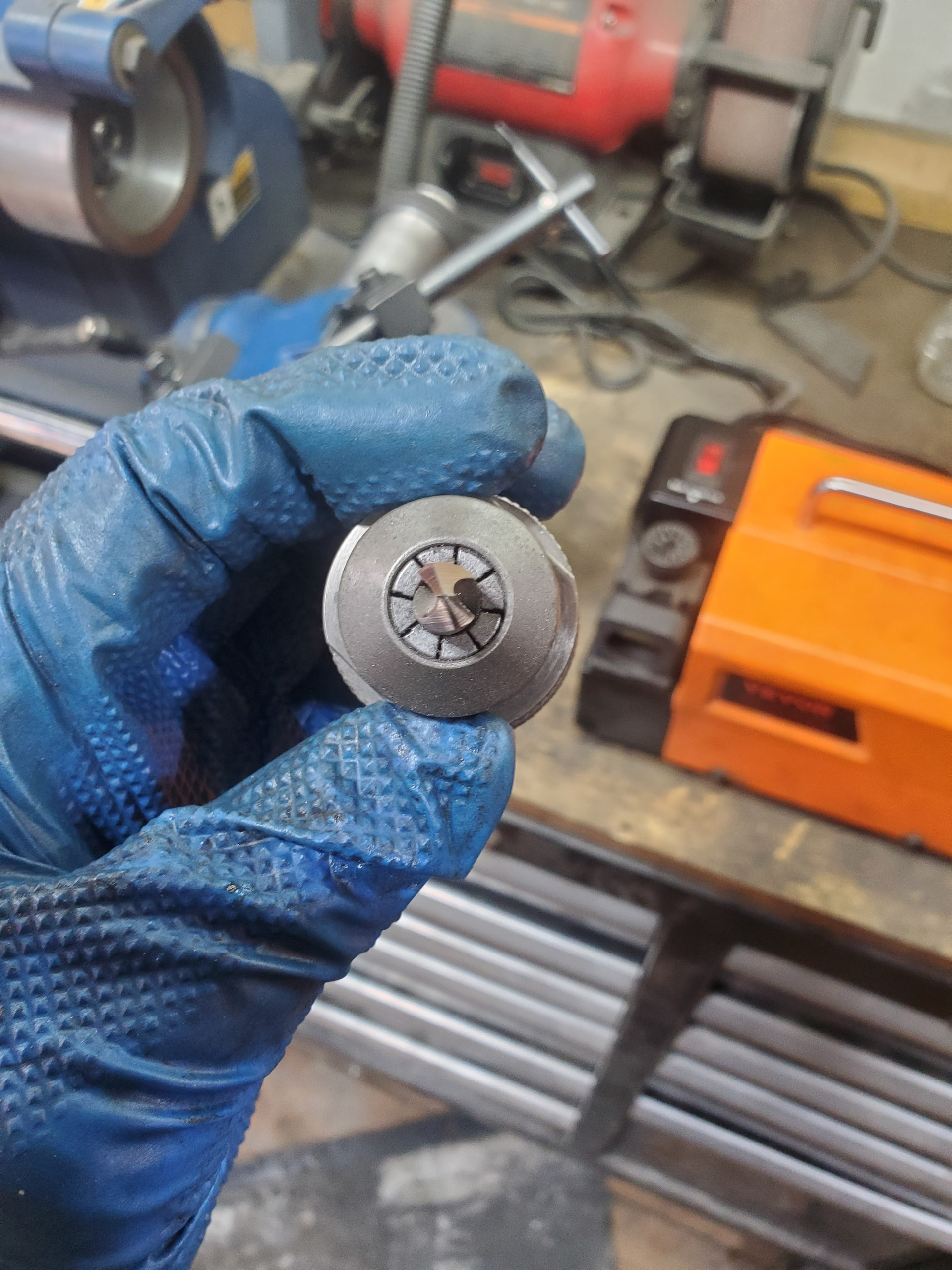

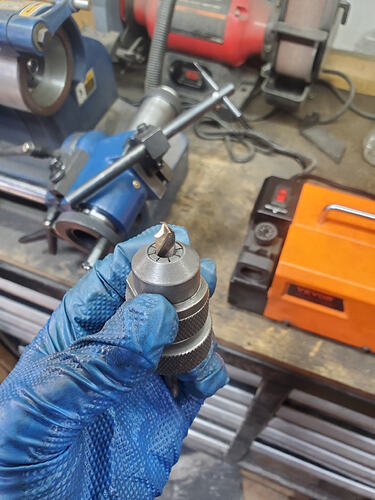

Last year I picked up a Vevor MR-13A drill bit sharpener and I gotta say it is hands down better than the Drill Dr I had. I have salvaged so many bits and they are near perfect after sharpening. Dull bits, snapped bits - no problem, just shorter than before I started.

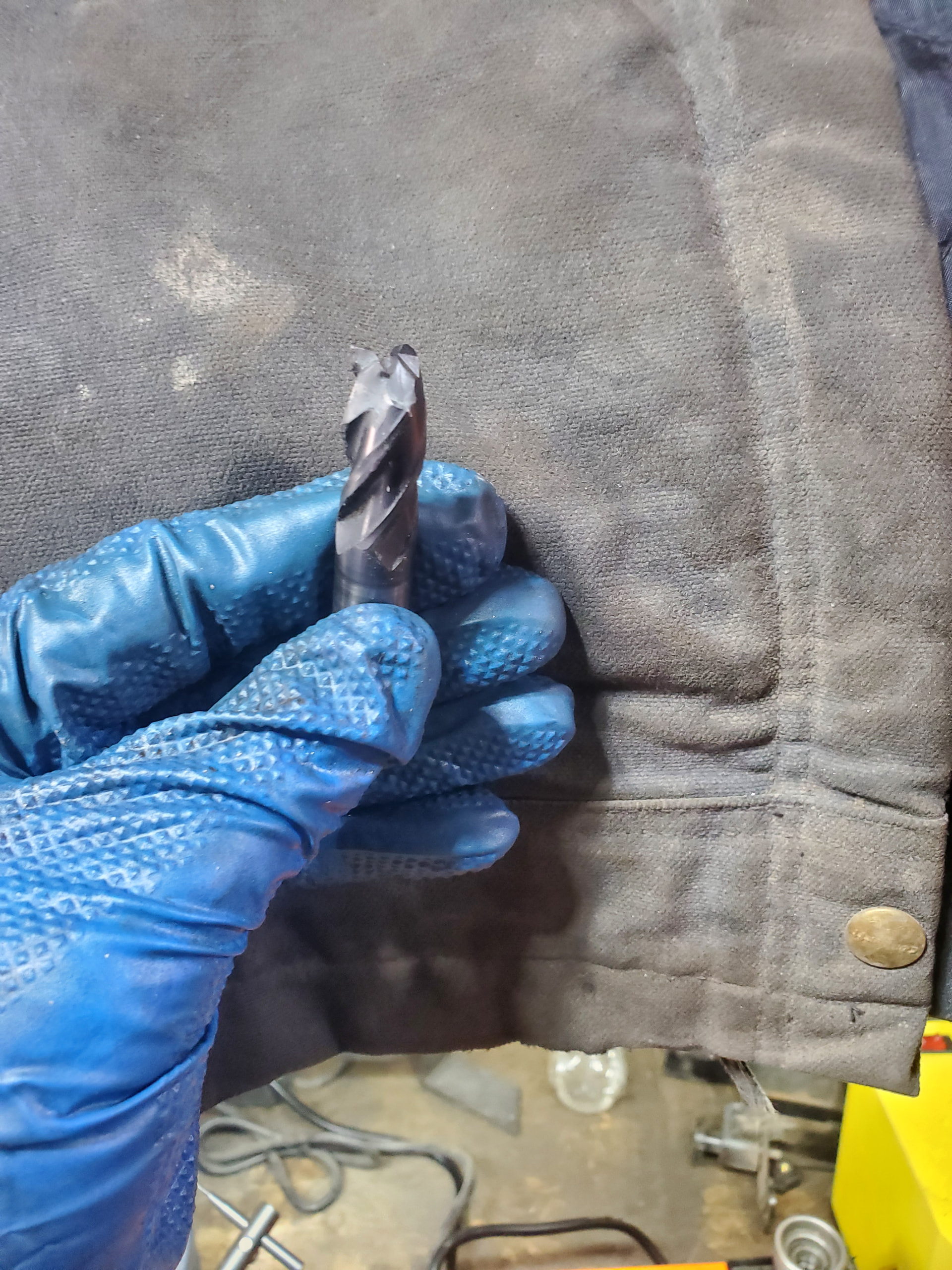

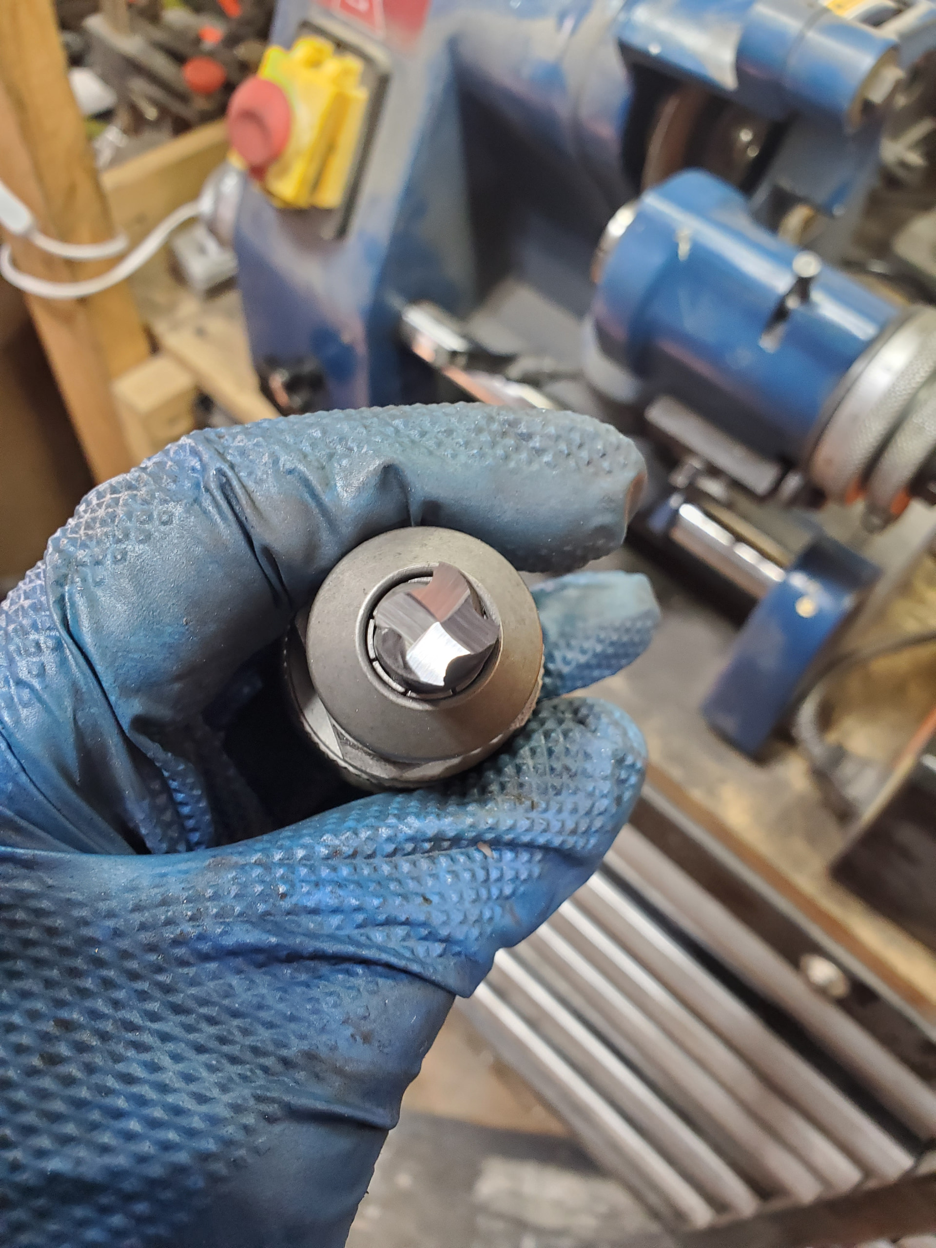

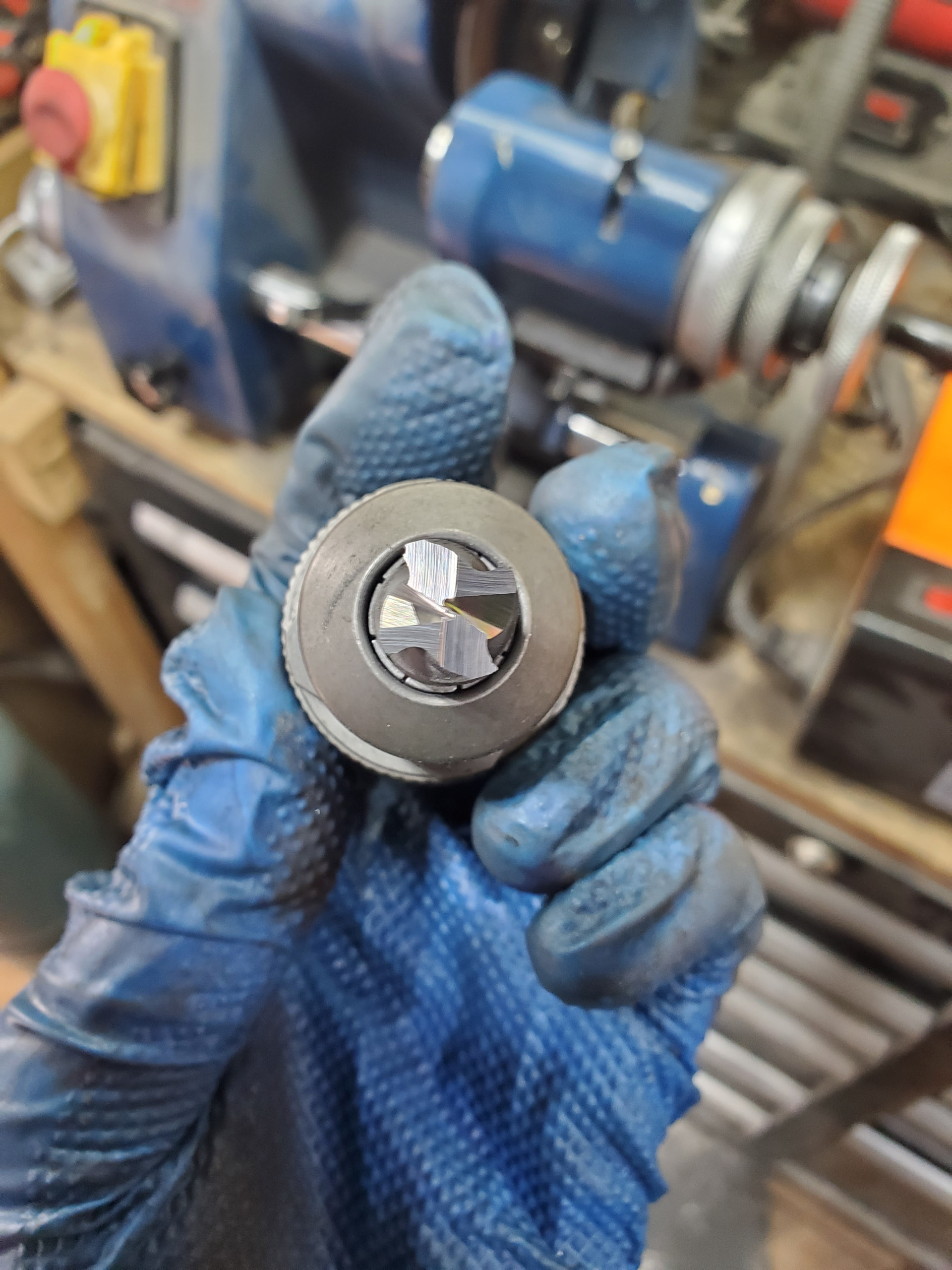

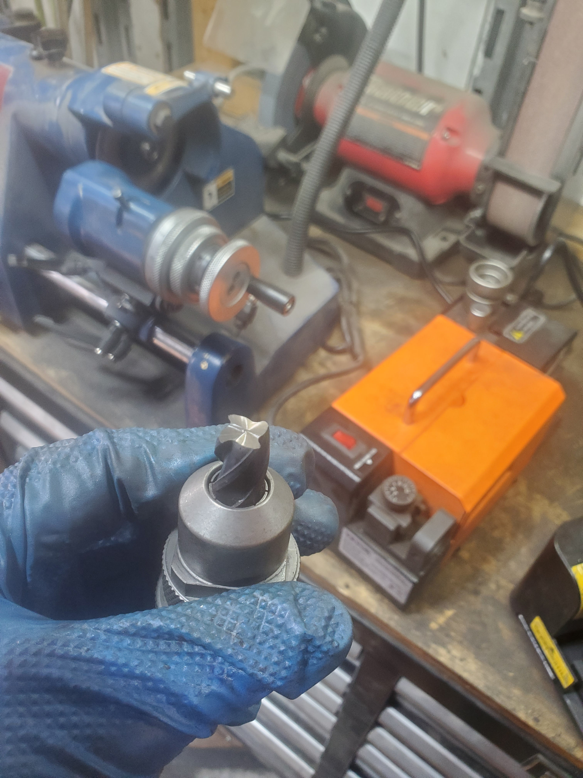

Last week I bought a MRCM MR-X3 endmill sharpener to quasi replace the Deckel clone Dbit grinder.
WOW

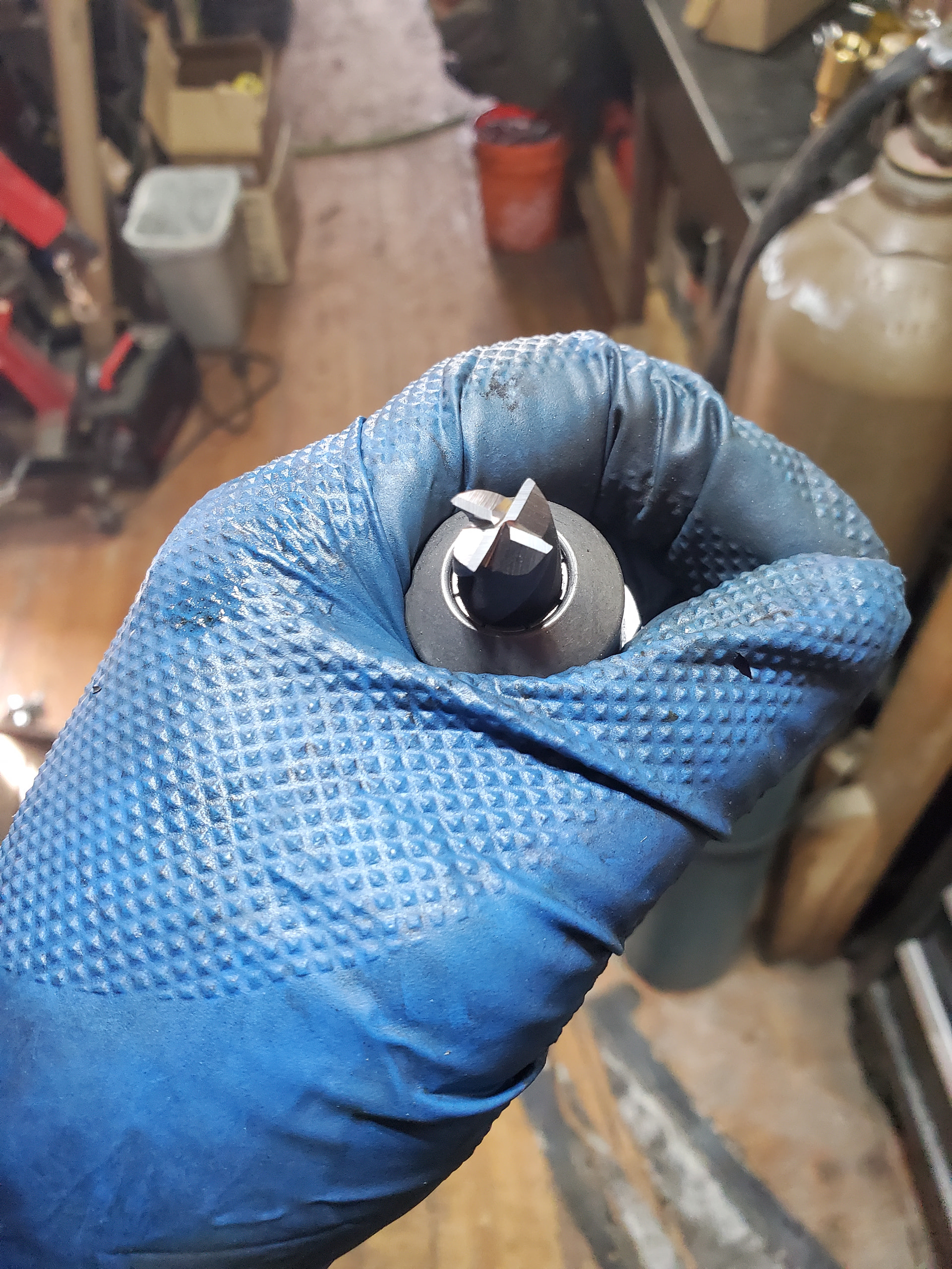

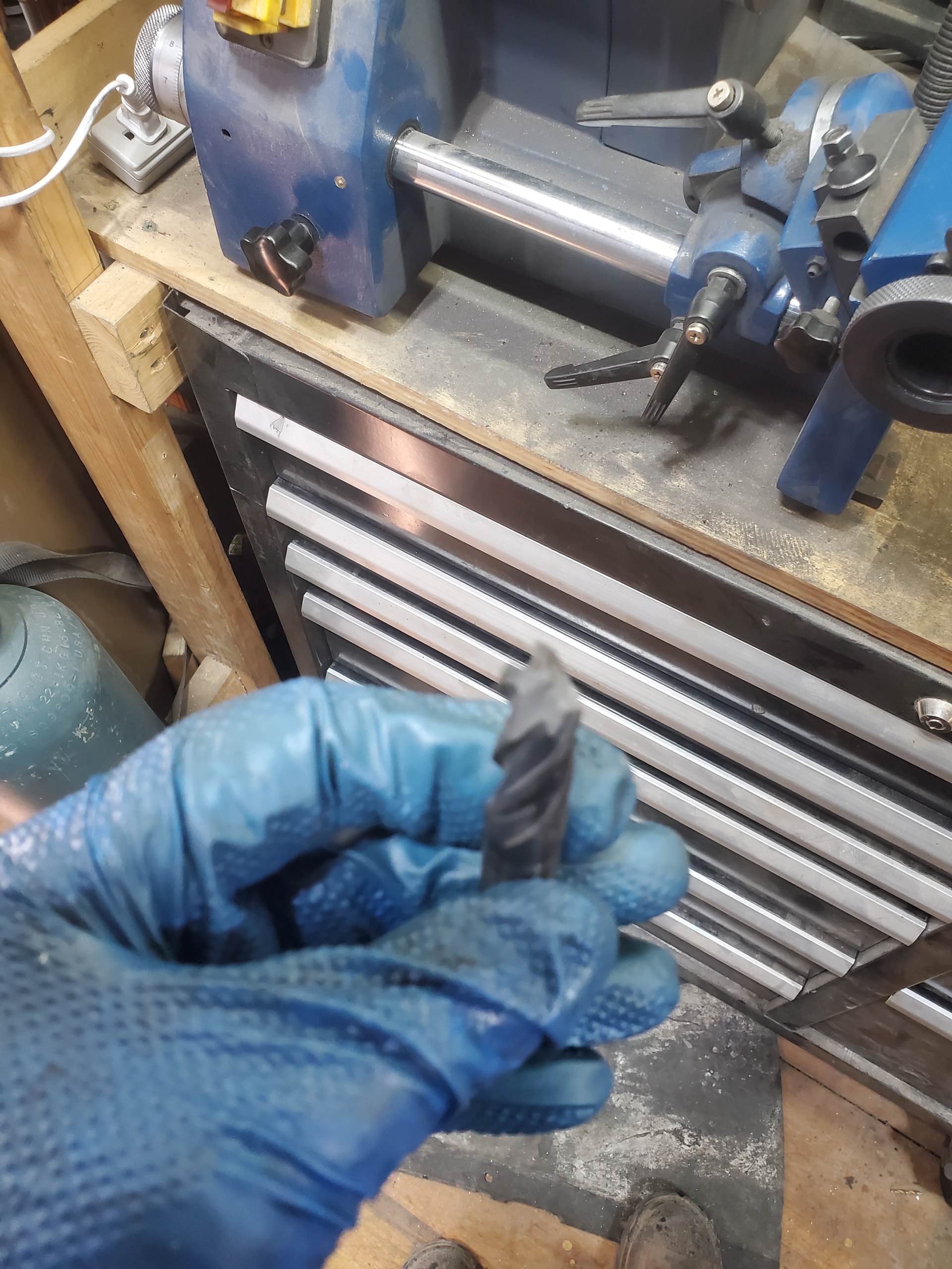

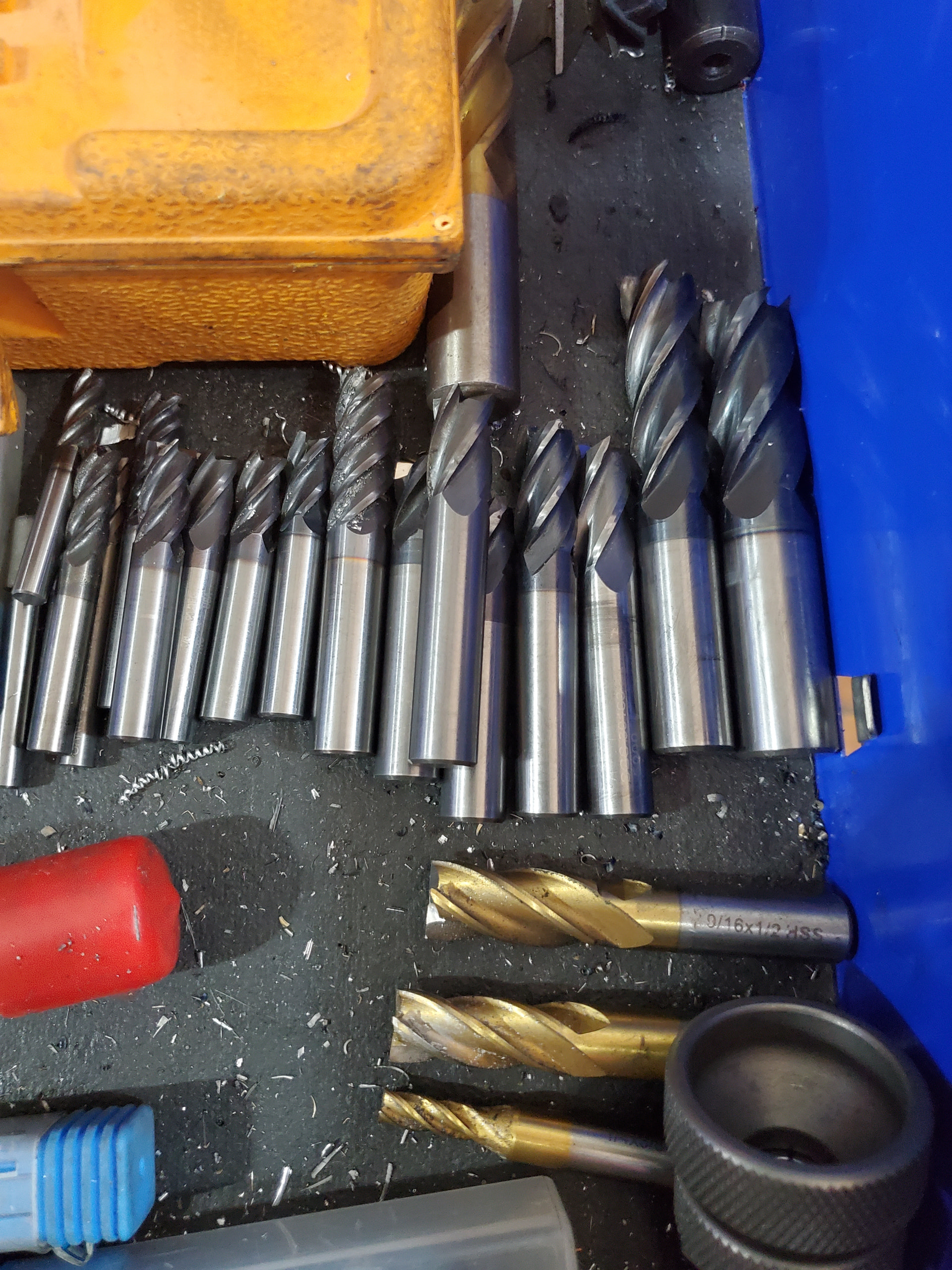

I had been saving my trashed endmills for the last 3 years, and in a few hours had salvaged and returned to service around 17 carbide enmills.

i have literally a hundred pounds of twist drills I’ve rescued from the scrap bin at my work. and piles of used end mills that just need a touch up.
That Vevor drill bit sharpener is good for up to 5/8" drill bits.
The Endmill sharpener (the yellow one) is good for up to 5/8 endmills, HSS or carbide, 2, 3, 4 flute.
Both are stupid simple to use.

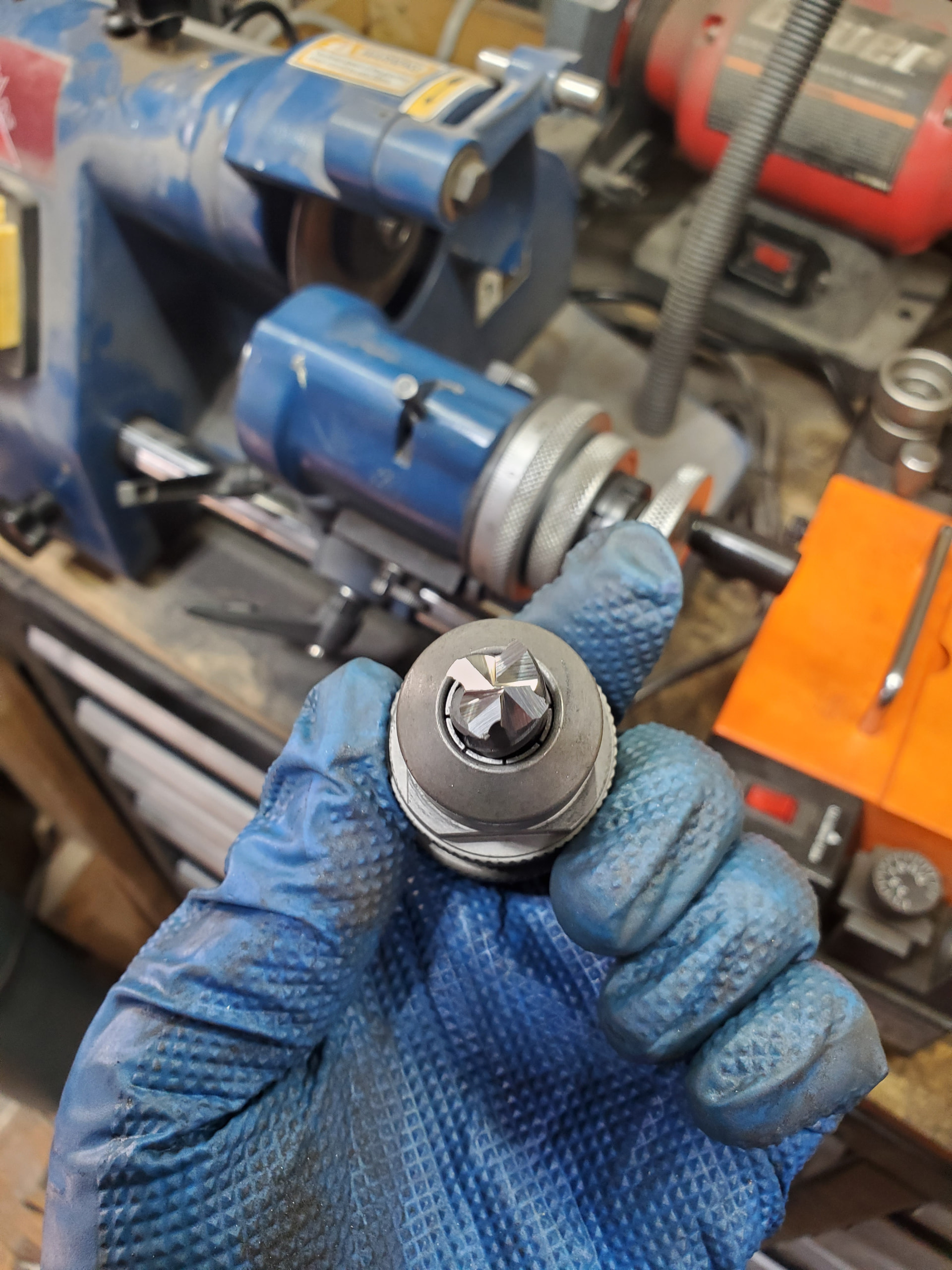

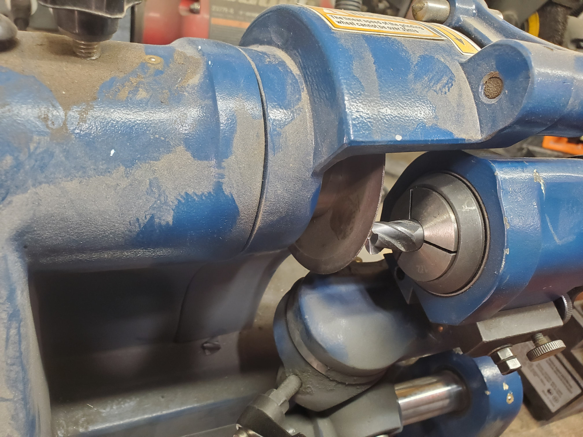

The Dbit grinder does both, but they are finicky in setting up, knowing all the different angles… Unless it is an authentic Deckel, they need disassembled and fixed. The 3 different angle locking is inconsistent and slips easy. I would not have bought it if I had got the yellow one first.
Having said that, I have used the Dbit for sharpening annular cutters, but again finicky setting up.
