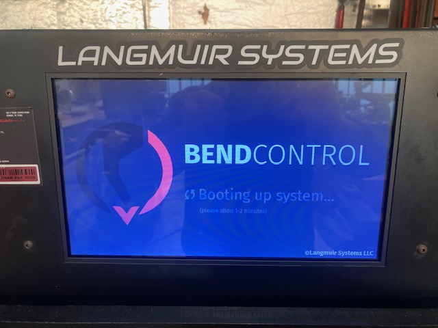

I haven’t used my Titan for about 6 weeks, was working just fine last time I used it. Went to fire it up today but it won’t get past the the boot up page, just sits there. I have tried turning it off and back on after a few minutes but same result. Has anyone had this problem? Any suggestions?
Make sure the Micro SD card has not slipped out.
It is a total pain in the ass to check. Open the top to see the Orange Pi unit. The SD card is on the bottom. They don’t click in as you would think. Put a rag under it in case you drop it. Very tight inside. Get with @langmuir-sam.
The receptacle for my micro SD card is the kind that positively clicks into place. I have removed it and reinserted several times. when I turn on the machine it gets to the screen below and doesn’t go any further. I will call Langmuir in the morning.:slightly_frowning_face:

Thanks for the call. I have a pre-etched SD card going out to your location.
