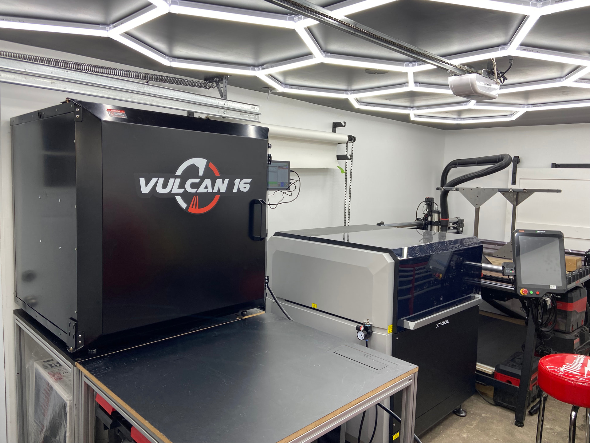

My experience building the Vulcan 16 Oven
Let me start off by saying this oven is pretty awesome. There is really nothing like it on the market and that is why I purchased it (even knowing there are issues with it).

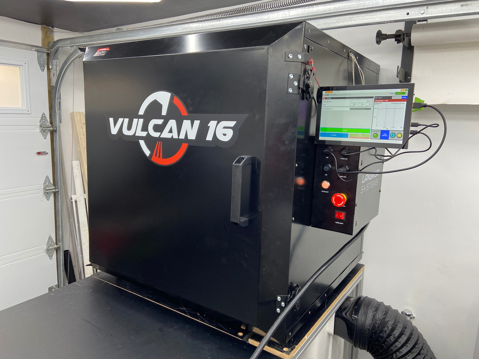

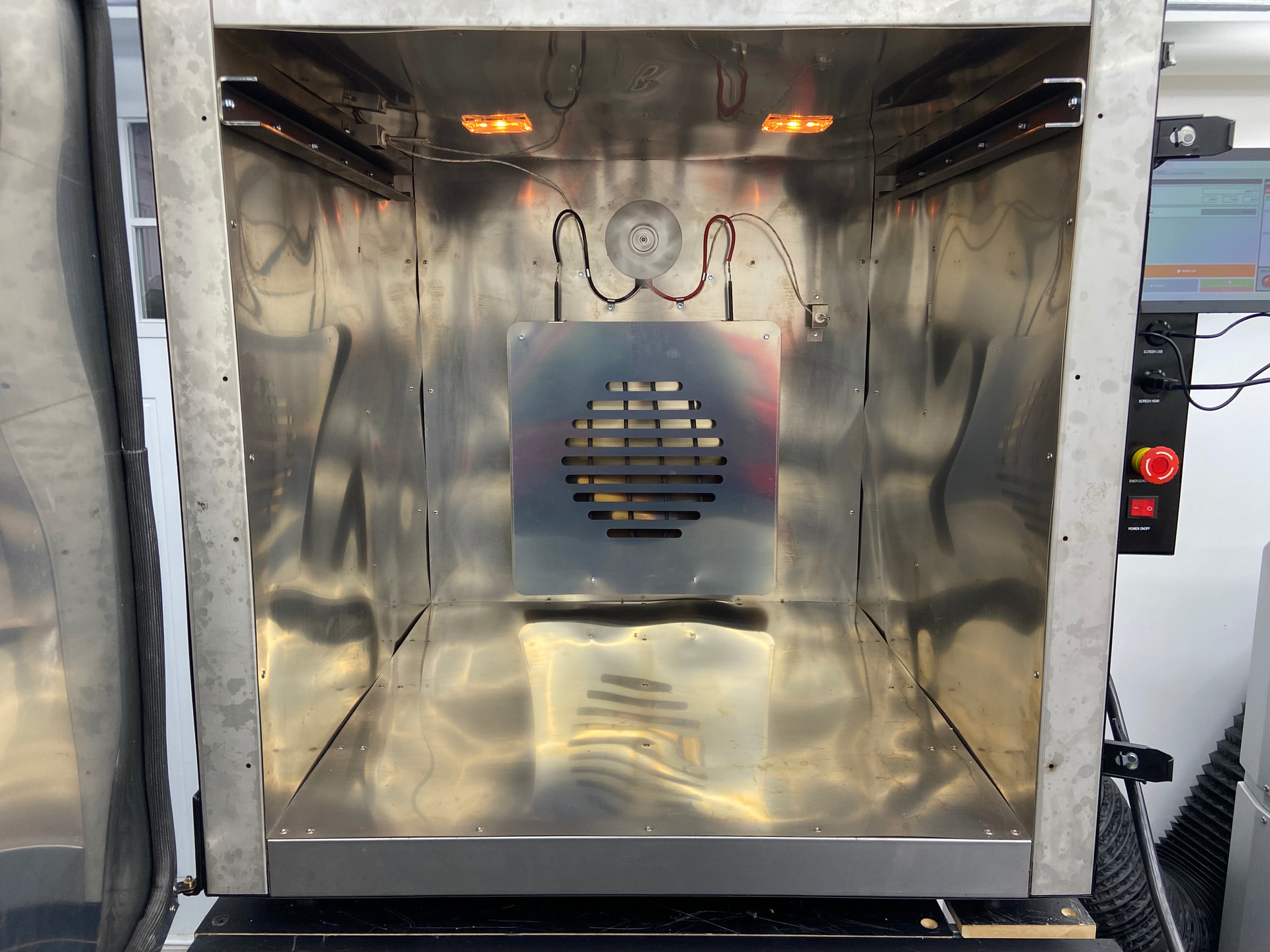

  2. Building the frame required a few long ratchet straps to get everything alined. I was able to get it built perfectly and everything was great until I heat cycled it for the first time. That is when all the internal stainless steel panels started warping. The fitment is just too tight. It would have also been nice to have instructions for the door opening on the left but it only shows for the right.
  3. The holes for the USB and HDMI ports on the front of the electronics box are too small. They need to be drilled out a little.
  4. I did receive the 240V fan but it shipped separately from my order a few weeks later.
  5. The touch screen is not great. You need to keep touching the same section over and over to get a response. This is a known issue. I was told it was resolved before ordering but its still a problem.

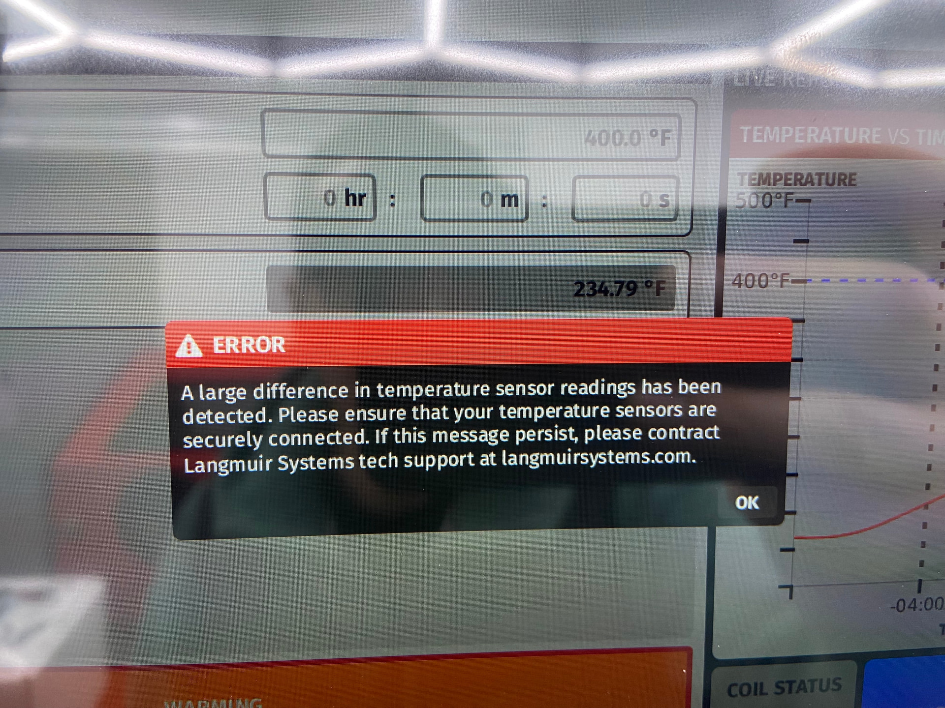

  6. I am also getting the error “a large difference in temp sensor readings” while its warming up. This should be a simple programming fix but again, its been 5 months and still shipping with the same issue.

Yep that sums up my experience from months ago. At this point having to work thru all sorts of issues, we are on our 3rd heating element and wires as they keep melting.
They sent an new electronics box, now I get that some error message your getting on temp. Shows up around 275 degrees is every time.
I’ve replaced the sensors several times as we were fighting temp miss match issues. I finally made a change to the mounting and put them both on the back wall and now my temp range issues have gone away. (I was seeing 20-30 degree differences, not it’s down to 5 degrees)

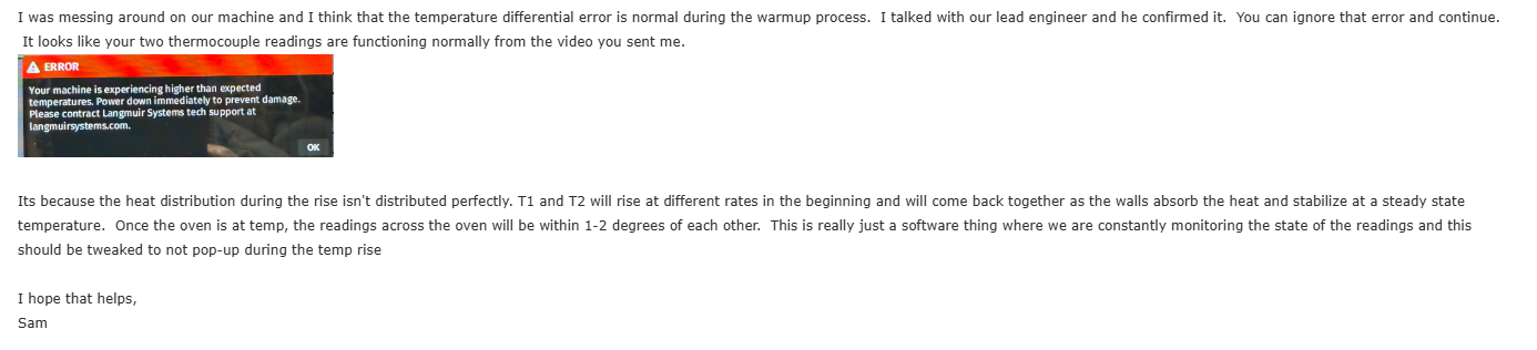

I am getting a little concerned because the responses I am getting from tech support make it seem like they have no interest in solving the issues we are experiencing.
They want to send me a cheap wireless keyboard to fix the issues with the touchscreen. They also told me to ignore the temp sensor errors during warm up.

I am noticing a ton of expansion/contraction inside the oven. It makes very loud pops sounds as it warms up and cools down. Is this normal? I want to seal the corners but with this much movement i can see it failing…
https://youtu.be/GlNT3QWwEIg
Mine isn’t a langmuir oven but it is sealed with high temp silicone. That could be a option.
I sealed mine with the red silicone and don’t have that issue.
Glad to hear but I am getting a little skittish adding the silicone knowing how much movement there is.
The inside is filled with rock wool. Even if it moves a little, it won’t hurt anything. Use the Henkel 500° red

I was also told to ignore the warm up error multiple times and apparently they are planning to update the firmware in about a month to fix it.
I started getting that error message after they sent me a new pro electronics box. But I’ve moved my sensor so they are both on the back wall on either side of the element. It did solve my issue with my sensors being way off at start up.
I usually see that error between 230 and 270 degrees at warm up.
