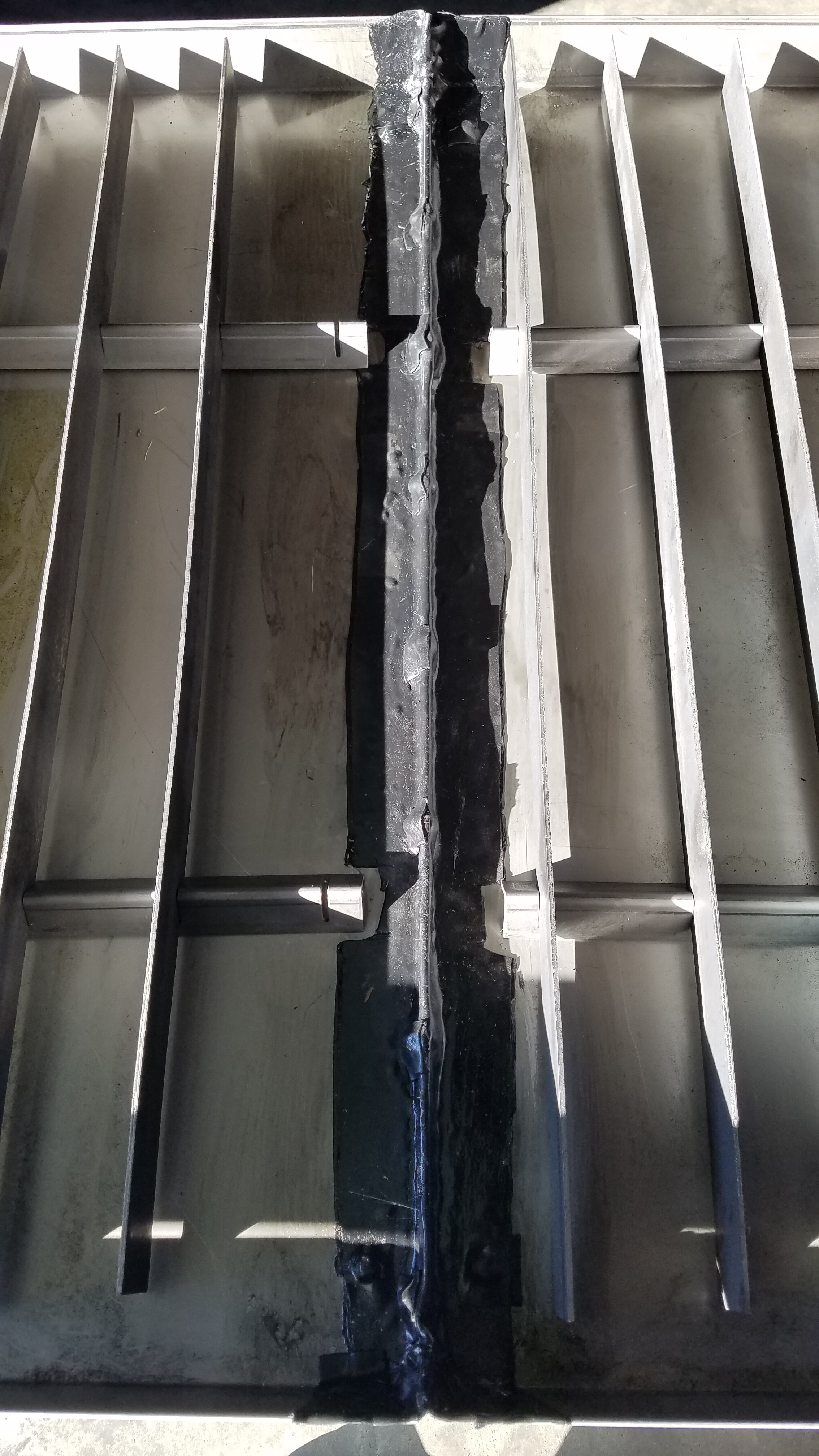

My build is pretty well finished. I got my brother-in-law to seal my water tray joint with some Firestone roofing waterproof lap joint materials today. He said it is designed to be permanently underwater.
I tried the silicone seal method and it leaked. So, I TIG welded it AND had him come over and apply a seal. I will fill it tomorrow, even though he said no need to wait,

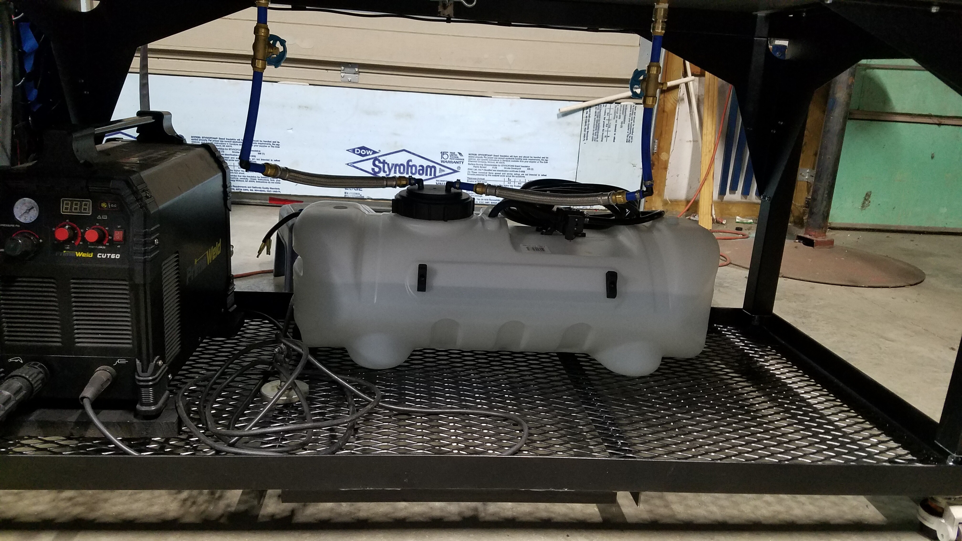

I bought my Pico Quench from this company for $191/5 gallon, including delivery fees.
https://www.trick-tools.com/PICO-G-Quench-Guard-G-Anti-Corrosive-Additive-for-Plasma-Tables-14578

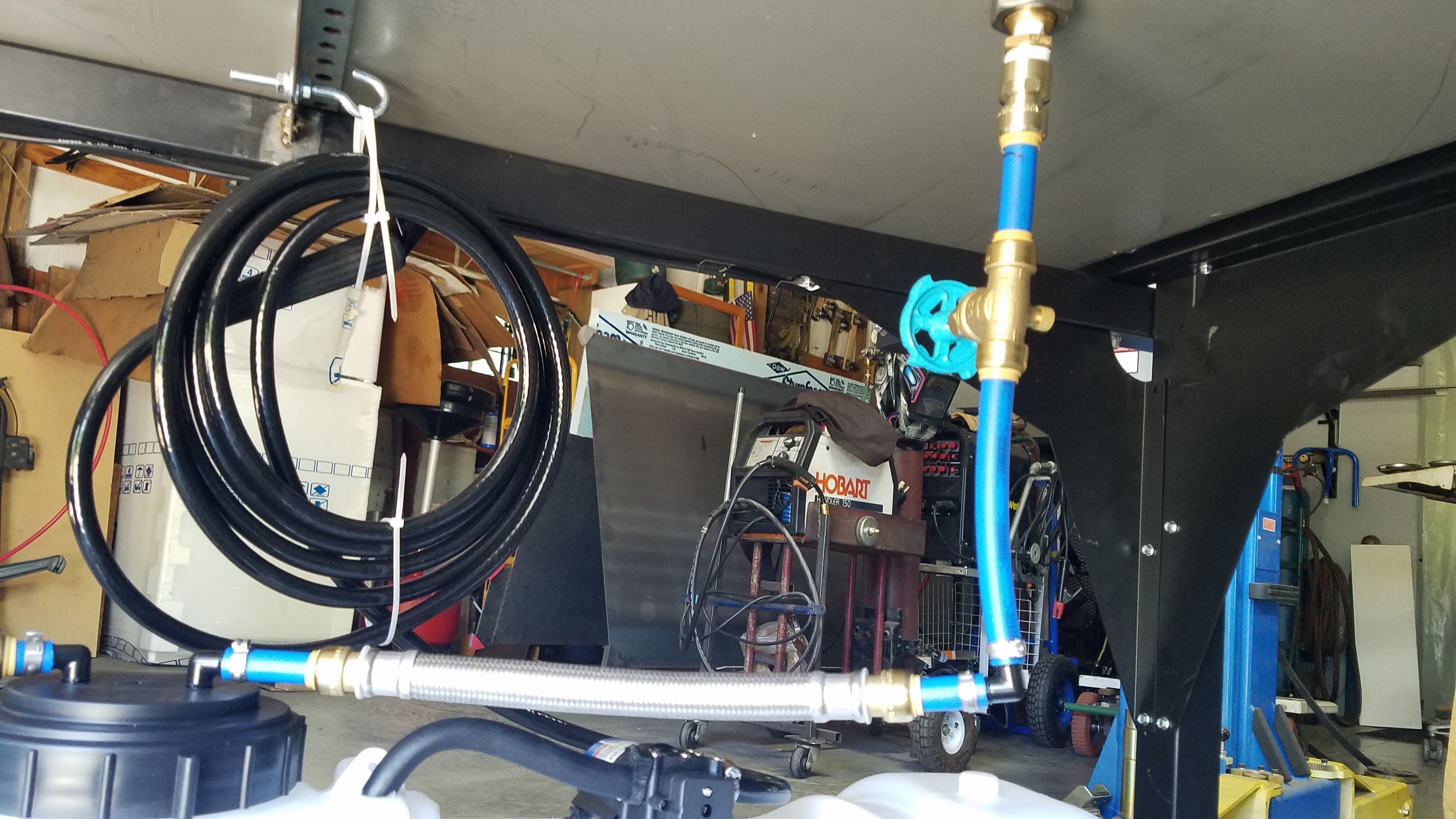

How many gallons is that tank? It looks small, but maybe it’s deceiving with the large table.
It’s a 15 gallon from Rural King Farm Supply store. It is just the right size actually. I filled the table from it once already. That’s when I realized I had a leak on the joint between the two halves.
I used some PEX just because I had it laying around. I could have gone cheaper with some flexible tubing from Lowes or HD. I also used two PEX fitted flex hoses so it would be easy to disconnect form the tank to add fluids. That could have been done cheaper also.
Others may want to “do as I say, not as I do”. :grinning:

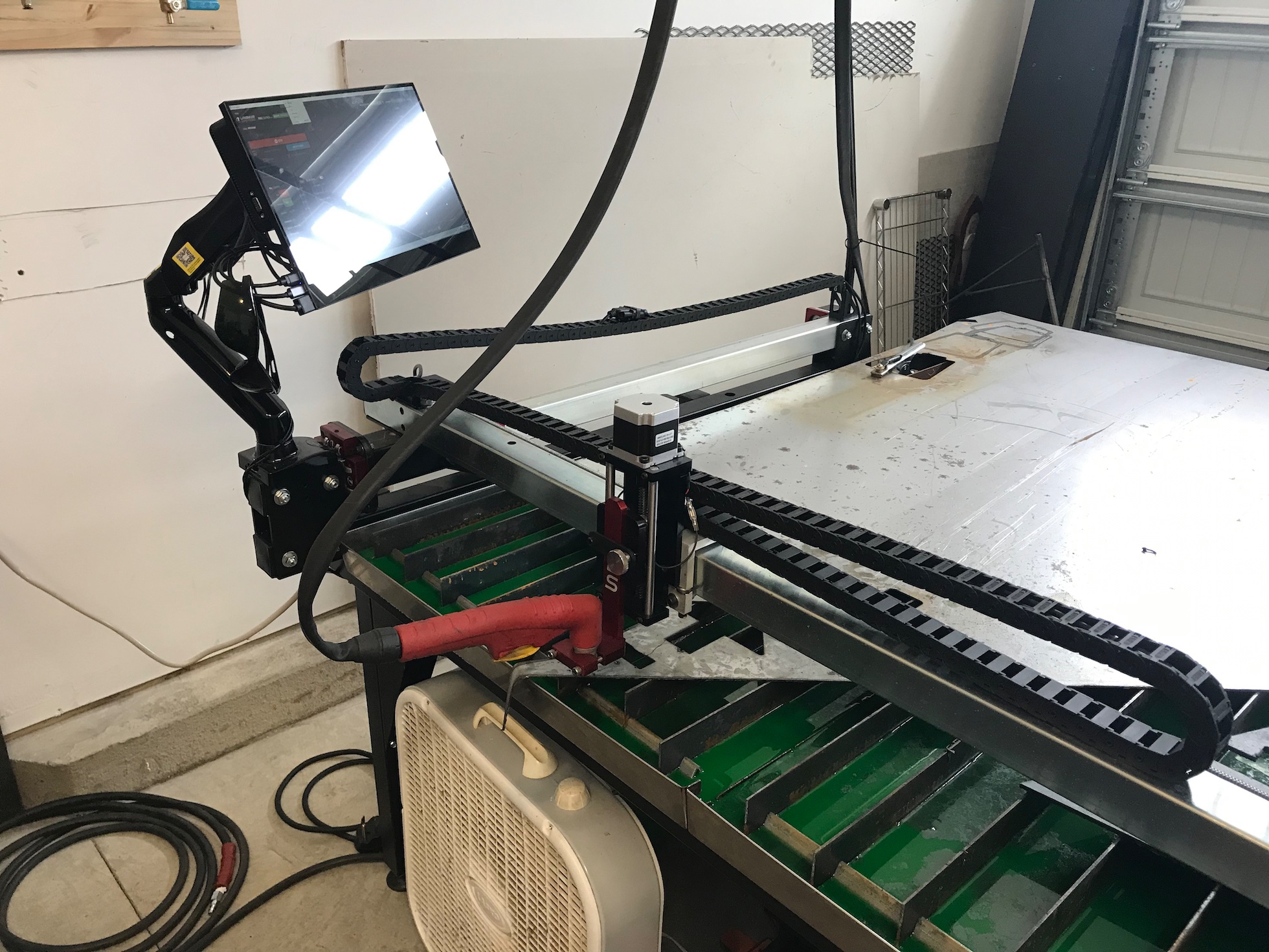

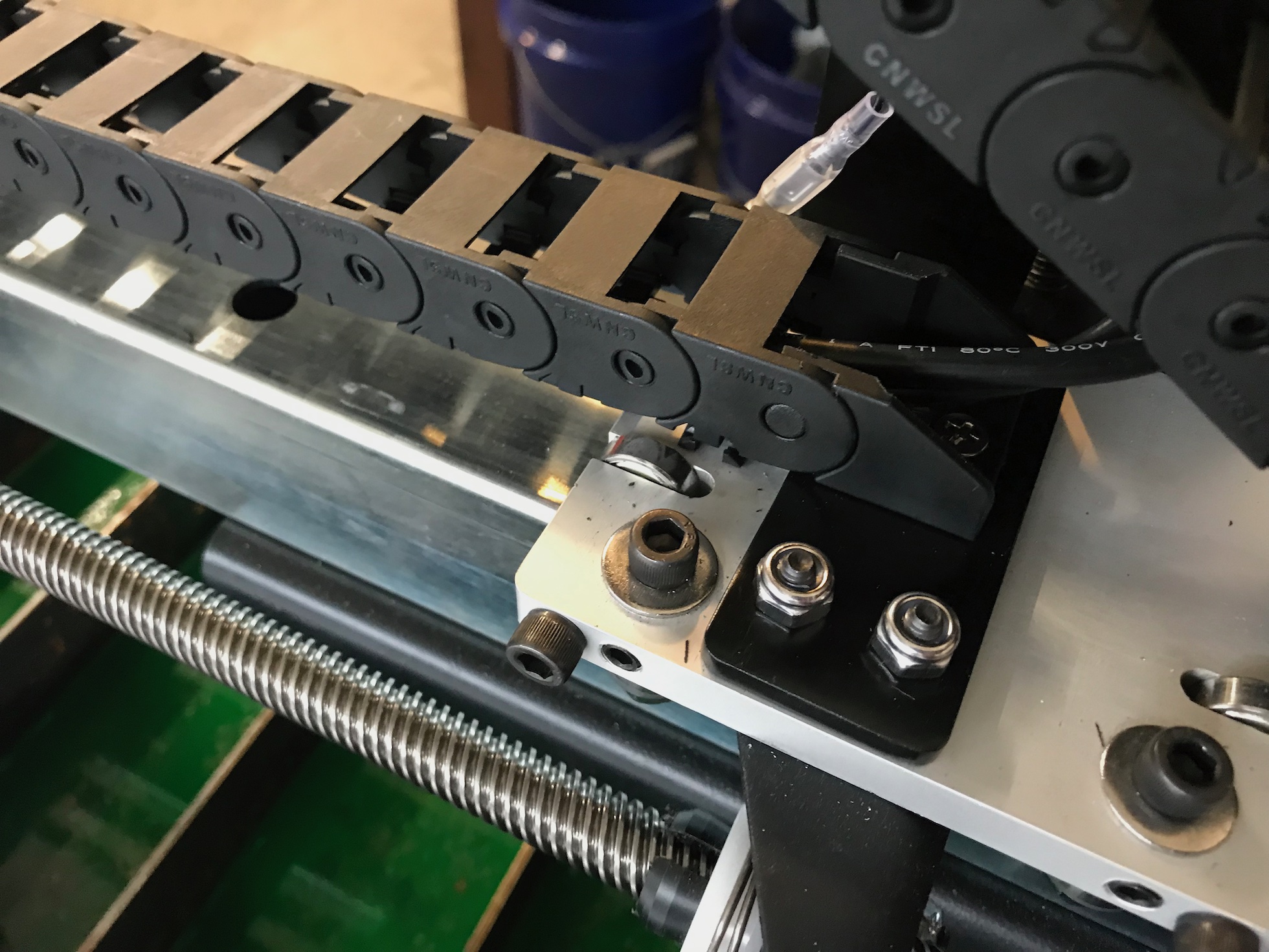

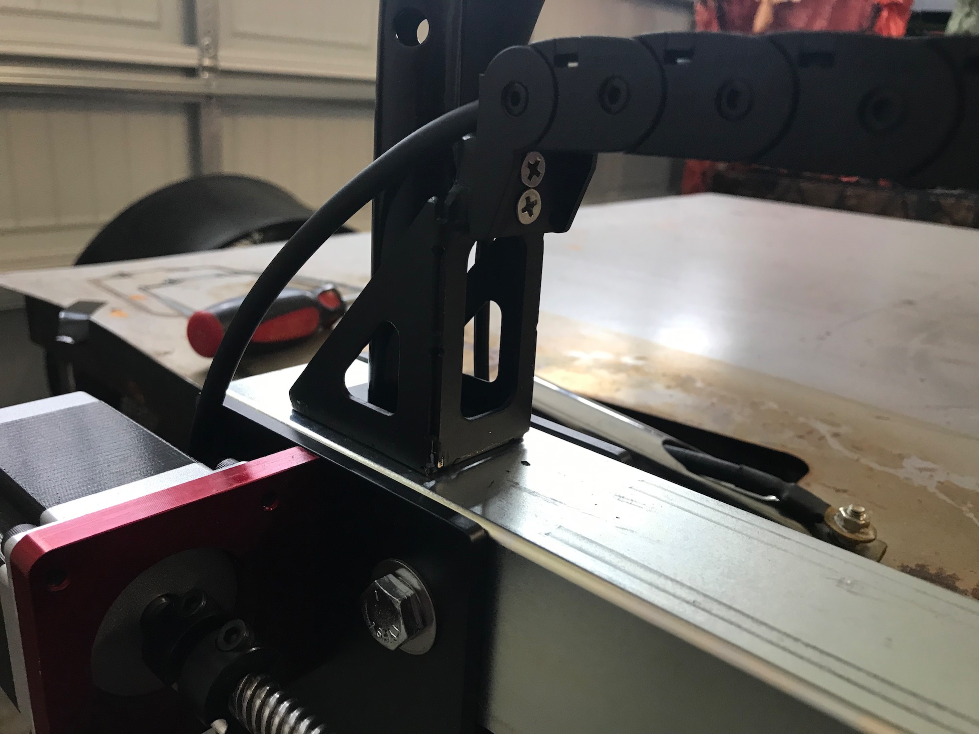

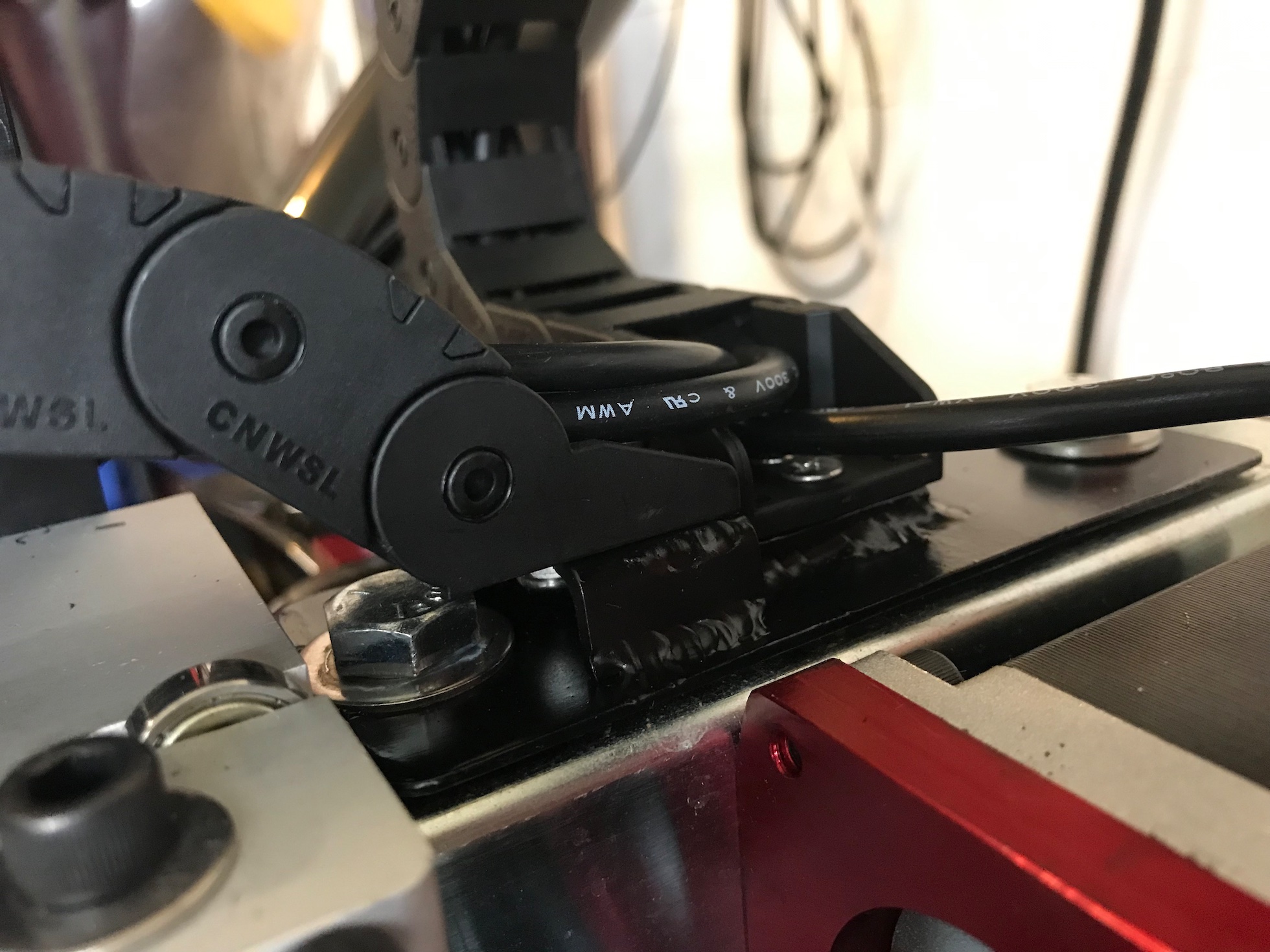

Okay, I have been studying everyone’s pictures of their drag chain setups and I finally finished mine. Thanks to everyone who has posted I managed to sort it out. Other than the drag chains not being able to house the torch cord it was a success. However, I am not too sure of what I have accomplished without the torch cord being housed in the drag chains. I had hoped to eliminate the overhead cords/wires. But, all is well it was only ~$60 or so to complete the project. I was also able to learn how to better use the machine and Fusion 360. I designed the brackets in Fusion 360 and cut them out of 18 gauge steel. A couple parts were 3/16 steel. Just stuff I had laying around. Thank you to everyone who shared.

@dustinlittle I laid out my drag chains laying on the frame tubes as you did. I didn’t see a reason to add “U” channels for the chains to follow. I like the bracketry you made.
Joel, I agree. It is simpler and just as effective. However, I just followed along with most the others from this feed. Thanks to them I was able to accomplish the project.
