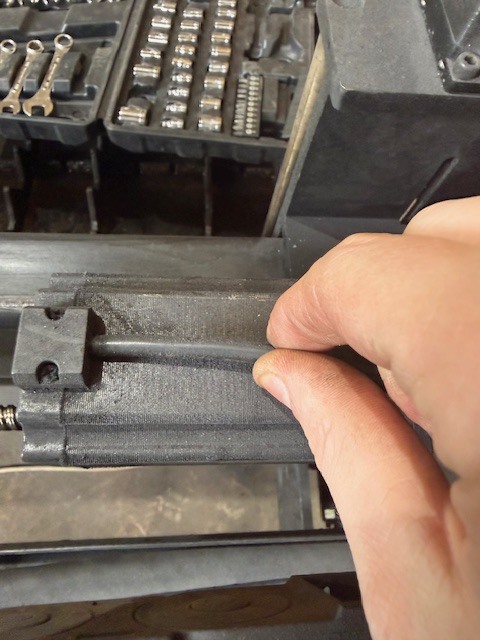

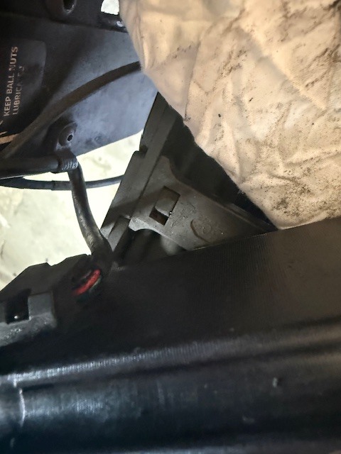

I’ll try to get a photo of the exposed wire. But I’ve been having constant THC Voltage jumping from 10V to 250 V. I’ve noticed every time I press on the Y1 Limit switch the voltage drops to zero. I noticed the motors cables Yellow, Blue.. Cables are showing and now fully sleeved in the little clap. Could that cause the issue? Or am I chasing the wrong path. I know electrical issues are the biggest nightmare but I’m trying to see what happened.
I’ve had Tech support send me new Limit switch cables and motors and Modules for the Electric box.

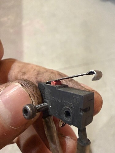

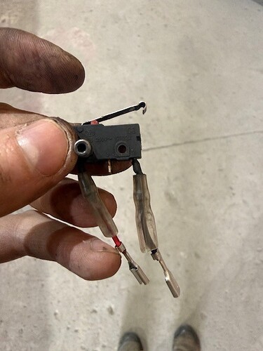

A bad limit switch grounding out to the frame of the machine. Some of the first machines were sent out with limit switches that had no gasket around the switch so water ingress may cause them to fail.
no gasket?
let’s call it a membrane
Also replaced the motor with a clean motor where the cable isn’t showing. I did notice when I press on the Y1 limit switch I instantly drop to 0. When I unscrew the limit cable I goes straight to zero. Is that what you’re talking about?
Oh the little rubber thing where the limit switch connects to?
Around the actual red button part of the limit switch. Some of the older ones did not have a membrane there so water could get in between the red little switch and the body of the limit switch
I had issues with torch rise because of this in the past
I’ll check it out and see if that could be it.

unplug all the limits from your electronics enclosure and see if this drops to 0.
