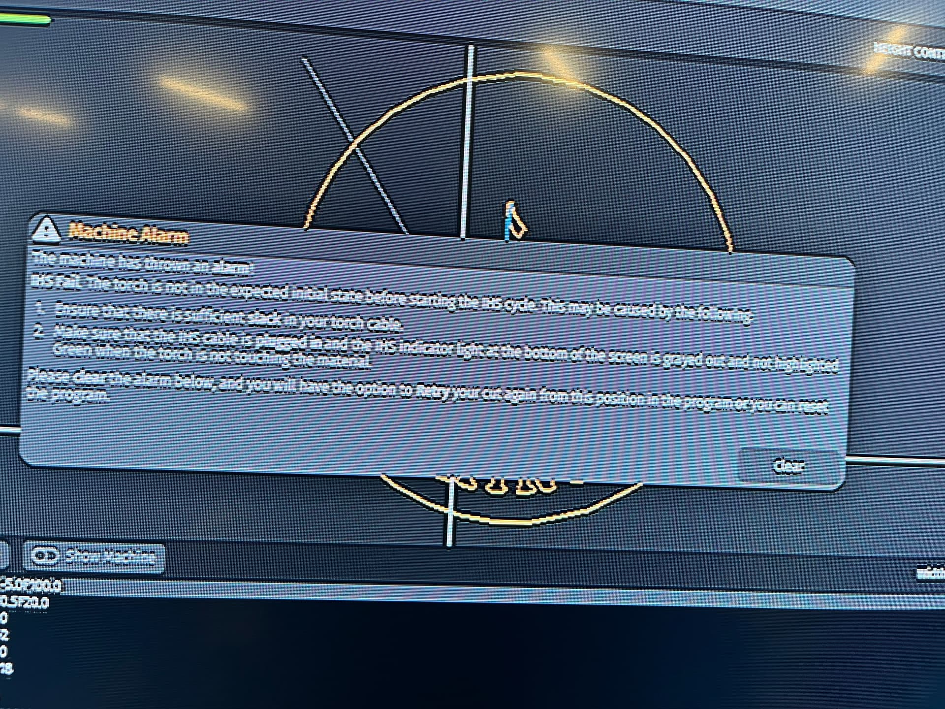

The light functions as it should on the bottom of the firecontrol screen. Here is the error message that keeps popping up but when I clear it I can cut again for a very short time and then the error comes back?
When that error comes up, check the IHS status. The only reason for that error is that the IHS circuit is open(light is green) when the expected state is closed(light is gray).
You have an intermittent connection issue with the IHS circuit. The most likely cause is the two connectors on the back of the Z axis. They can look connected, but not be fully pushed together.

That error message cannot be caused by the plasma cutter or the air supply. It is only related to the IHS circuit.
Thanks, tomorrow I’m going to rewire all my connections to eliminate that as an issue.
