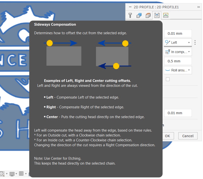

I notice that my cuts are a touch smaller than I designed them. How much larger should i go on design to compensate for what I guess is torch width. thanks
Are you using Fusion? Put in your kerf width and it does it for you.
Are you cutting with the Compensation set correctly? For example, are you cutting on the outside of closed loops (rectangles, circles) and in the center for open loops (lines)?
F360 setting during Tool Path generation:
Like Big Daddy said, you need to enter the correct kerf width, so the CAM software can put the tool path in the right spot.

That really is a fool-proof way to get the kerf width. At first I thought “No…you need to divide by 2 something” but by using center compensation you are basically telling the post processor to ignore the current “kerf width.”
