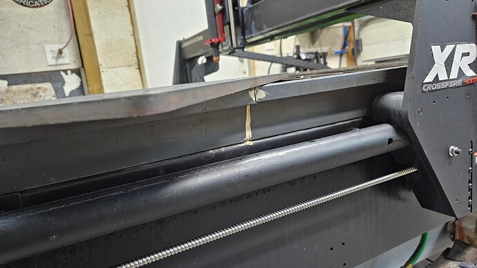

Cuts on 1/2" plates for a crane company. table and torch dialed in…

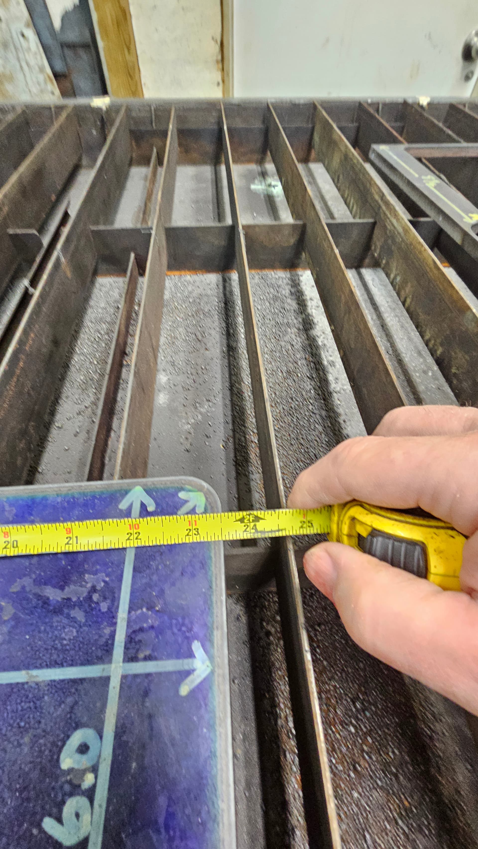

Sorry guys and gals, forgot to add dimensions of plates after cut accuracy…

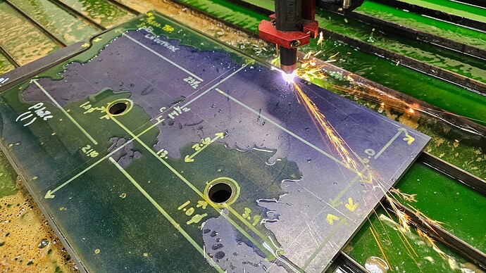

What were your settings? Those cuts look awesome, and I have a bunch of 1/2" coming up to cut. Please share your settings!! Thanks!
If you have the Hypertherm powermax 45 xp plasma cutter here are the settings. 45 amps, 140 volts nominal, pierce delay 1second, 18 ipm., peircehgt.,.15, cut hgt.060, my air psi from compressor to plasma cutter inlet is 120 psi., and torch psi. is 70.
If you don’t have Hypertherm plasma cutter then you will have to do some test cuts to find best settings.

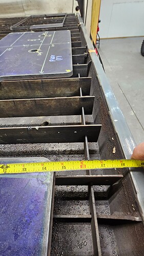

Langmuir XR table has been great and trouble free for 3 years now. After first couple of weeks of cutting on table I readjusted homing switches to re square gantry and readjusted bearings on Z axis,every part cut on this table has been square ever since…
