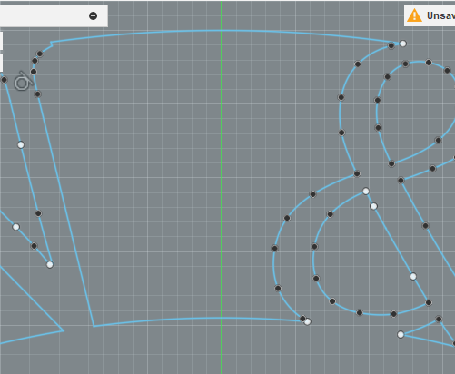

Hi - first post ever from new user. I’ve been working on Monogram and having trouble with a small section not showing cutout. Have not been able to get the area between the “N” and “&” to show a cutout so suspect that metal will remain when I cut on table. I don’t see any opening in perimeter so not sure why or what to do about it. Thx
If you shared your f3d file, it would be easy to say. Not having the file it is likely one of this 4 spots, marked in yellow:
It is either two lines that don’t perfectly coincide or a line that extends past the one point or a double line segment. Double click on a line in that contour and see where it stops. Zoom in on it. You might need to delete a segment on one side or the other of where the segment selection stops. Redraw that deleted segment. Keep repeating the process until a double click selects the entire contour.

Ok but HOW did you do that! Like to know so I don’t have to bug people going forward… Like to be self sufficient. Thx
The issues were depicted in your drawing like @ChelanJim pointed out
The white dots

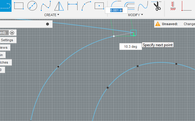

First I deleted this line and redrew it:
Notice the white dots are gone:
Then I deleted and redrew this segment:
White dot gone:
Those were the only two changes. Notice there are still some white dots but they aren’t causing a problem. I just used the double click method to find where the selection of segments stopped.
Great - Thank you. I didn’t realize there was a difference between the color of the dots and their impact.
In more complex drawings the “divide and conquer” method is helpful. You kind of develop your own styles as you encounter and resolve issues. Just to briefly show that, we could use your same example. You draw a line or two across your image then you monitor the profile as you move the line. The profile is good when the line isolates you from the problem area. As soon as you go past a problem area, you will see the profile mess up:
As soon as that line went past that right upper corner of our problem area, the problem is revealed.
