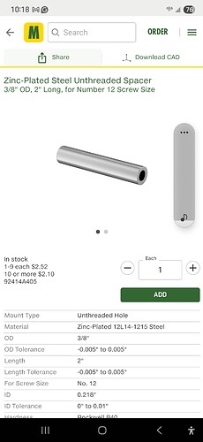

I am assembling my Vulcan 16, and am at the stage of mounting the element. It seems I need some spacers (M5.5 x 51mm) but they don’t seem to be in my kit. Actually the hardware to mount the element was missing too, but I found alternatives to those.
Are there alternatives to the spacers that I can find somewhere like a big box store? Online, I am finding M5 and M6 spacers, not M5.5. I would rather keep building this thing than have to wait a week for a few pieces of hardware.
Email them they will overnight the parts.
Do you have any metal shops near you? I am sure they have hollow rods you can purchase and cut to length needed.

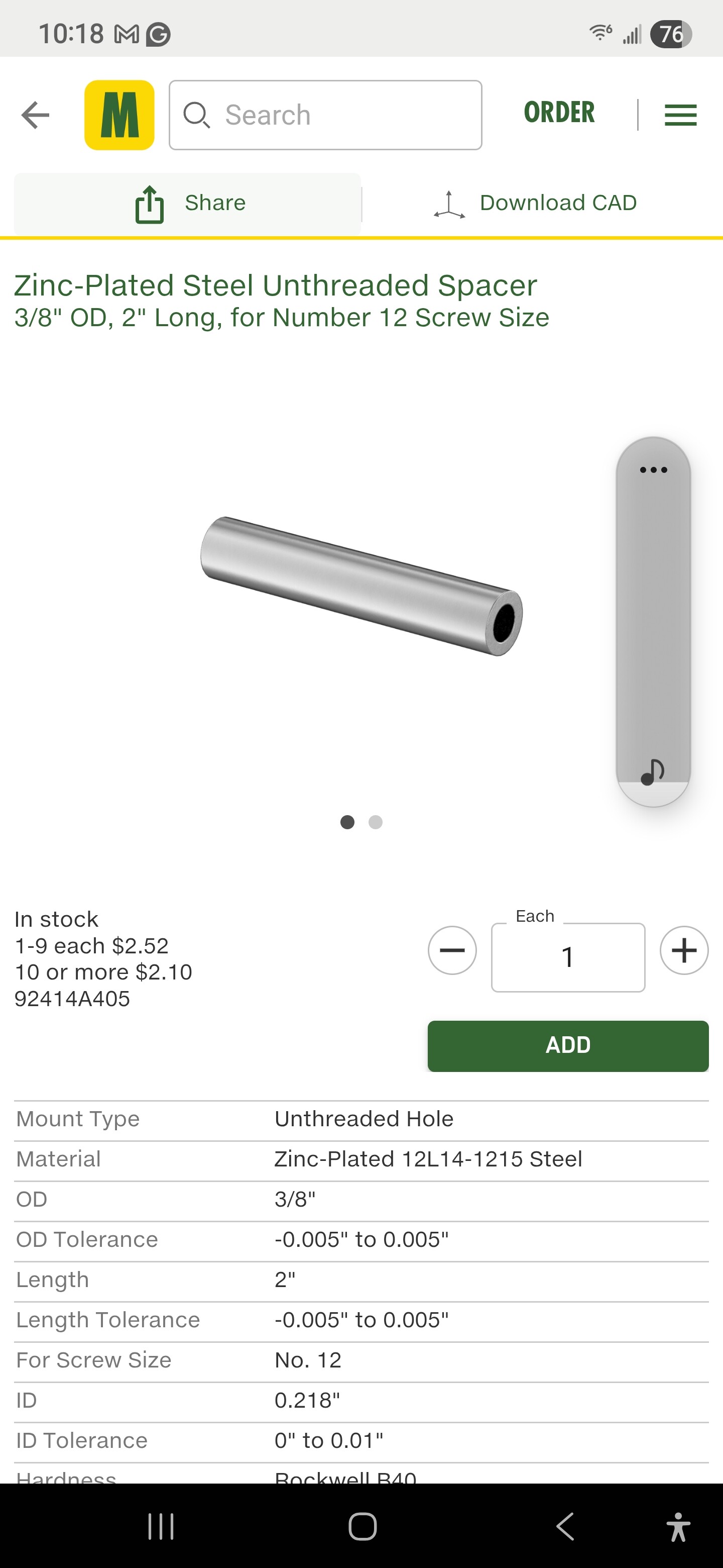

McMaster Carr has them. I believe that the bolts are 10-24 thread. Mine was the prototype, so some things have changed. If you call them, they will overnight them to you.
Just make sure of the ID. They have several choices.
