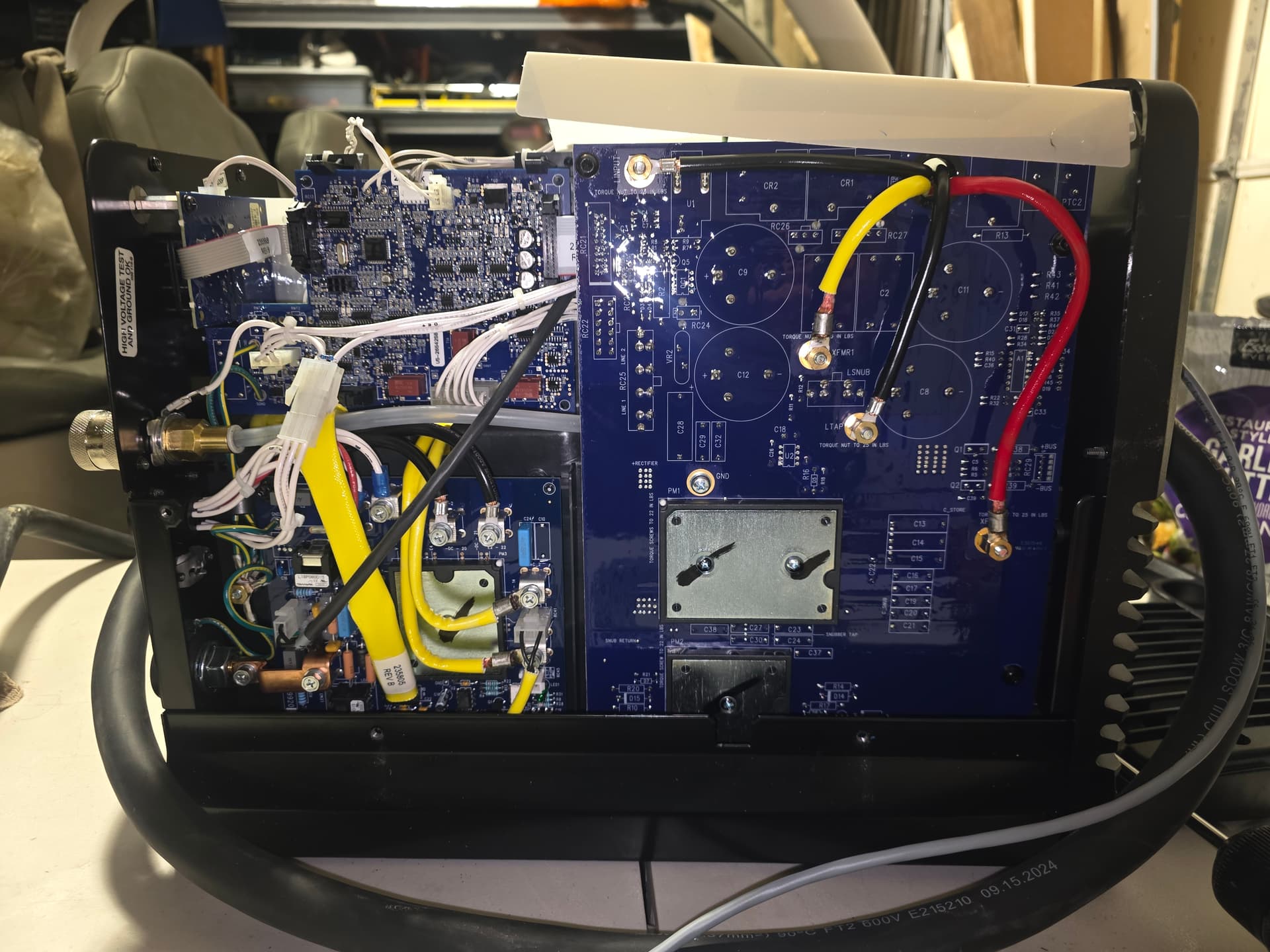

Hi all,
I’m trying to wire my Miller Spectrum 875 (standard model) with the Automation Kit #301157 to my Langmuir Crossfire Pro CNC table, which includes the LS-THC torch height control system. I also have the XT60 machine torch.
I am really trying to wrap my head around the wiring for two functions that I think I can setup:
  1. Torch Trigger/Start Control (Start/Stop Arc)
  • I see CPC port pins 1 and 5 are populated (white and red wires), according to the Miller manual for remote control.
  • Pin 3 is populated, and available for shielding, but not connected to any pins on the CPC cable when connected.
  • Manual states: White and red leads connect to a set of customer-supplied remote contacts to provide a remote trigger input signal to RC1 sockets 1 and 5 for the remote start function.
  • Question: Do I connect these (2 out of 4 wires) directly to the Langmuir control box’s torch ON/OFF port? If so, which pins/wires connect to which cable from the THC kit?
  1. Torch Height Control (Voltage Sensing)
  • This is where I get a little lost with the setup…
  • I see a resistor divider inside the Automation Kit harness, and I have installed it. It appears this is needed for the STANDARD Miller 875. The CNC port is not installed by default.
  • When the cutter is on but idle, I measure ~14V DC between ground and one CPC pins (pin 5, to be precise).
  • Question: Is this a divided voltage (e.g., 50:1), or is it raw voltage? How can I confirm?
  • I want to wire this to the Langmuir VIM box and then to the THC input.
  • Question: Which CPC pins carry the divided voltage, and how do I safely wire them to the VIM?
  • Question: Since I only see two pins on the CPC cable being used, are these two pins all that is needed for both remote control and voltage sensing?
Any diagrams, pinouts, or confirmation from someone who’s done this would be hugely appreciated. I want to make sure I’m not sending raw voltage to the THC by mistake. I am also curious if I need to add the voltage lines somewhere else. There are no instructions from Miller online (and I will contact them as well).
Thanks in advance!
Jordan
* Edits after playing around. I found this youtube video that helped a lot!
…Just note that this is for the Autoline, so some wiring was not the same. But, it at least helped me answer my own questions after staring at it for some time.
In the image below, this is the black cable routing down to R48 (I did not see this port earlier, which was part of my confusion). This one routes straight through the opening below the CPC port on the back. Also note the white harness connector, which is connected differently than in the video. That one connects to the CPC connection in the back.
