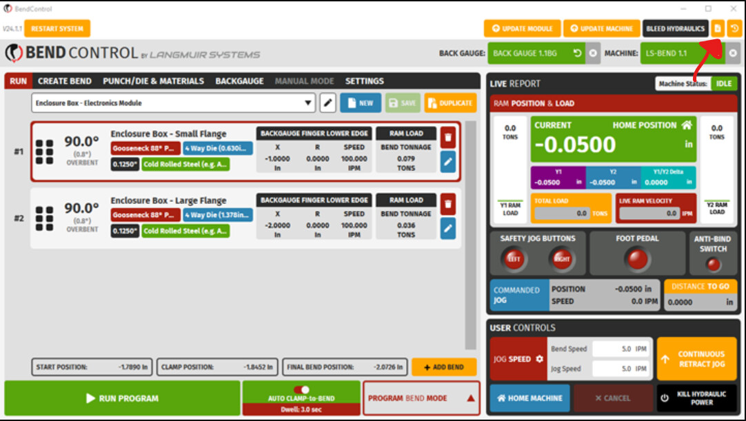

Memory issue for the back gauge setting names
Did Bend Control Patch 24.1.3 Beta fix the issue with memory for the back gauge setting names? I recently lost the names, but the calibrated values in each of the setting positions were still intact.
Yes it should have. Are you on 24.1.3?
I’m having the same issue with the back gauge names disappearing after machine shutdown. I did the new SD card etch and swap update to 24.1.3 a few weeks ago, but 70% of the time I start up the machine to make a bend, the names are all missing along with the settings. I was having this identical issue before the SD card update and now it’s doing the same thing - getting tired of having to start from scratch each and every time I restart the machine. I was under the impression that this was supposed to be fixed with the update, but apparently it was not ? please advise.

This issue was not resolved - I installed both of the two SD cards you sent (one was blank, one has 24.1.3) - same issue - backguage names are all deleted and not saved when the machine is shutdown. This same problem happened when I etched the new card i bought, and the cards you sent - all are running 24.1.3. It doesn’t do it every time, but like every 2nd or 3rd time I shut the machine down. This same exact issue is identical to 24.1.2 - it would save the BG names every 2nd or 3rd random time the machine was shutdown. It was frustrating to have a machine sent out from the factory with known and documented software issues, then more frustrating to jump through all the hoops to buy a new card, download the etcher, etch the card, swap the card 4 times and still have it fail - this is well beyond frustration at this point having to reset all the title and names and setting over and over. Either the software was not fixed or this computer or OS has a memory issue. I’m guessing at this point the names aren’t saved in the SD card?
I think the current name is saved on the SD card and all the other names are saved on the backgauge control board. It is a bit of a mess. I generally recommend for now you just focus on which ā€˜save slot’ you are using (Is it the first, second, third, fourth, fifth, or sixth one in the list), or just keeping to one backgauge reference save and using the coordinates in the bend program to change what positions you need.

That is far more severe than I have ever seen. I’ve seen the name save states get corrupted but not the coordinate values. This might be a hardware issue. I’ll get you a new backgauge control board sent out. For now I recommend just using a single reference frame for the best reliability.
Sam, I installed the new circuit board, reset all the names and settings - same issue, all the BG titles revert to ā€˜ā€˜select to renameā€ at startup. I tried using 3 different SD cards, all running 24.1.3 same identical issue with each. names will not save - same issue that was on 24.1.2 it seems like the bug was not fixed in 24.1.3.

For now: To just stick to using a single reference frame - the top default one. Home the backgauge before turning the machine off and after turning the machine back on. If you do that you should see no memory instability.
