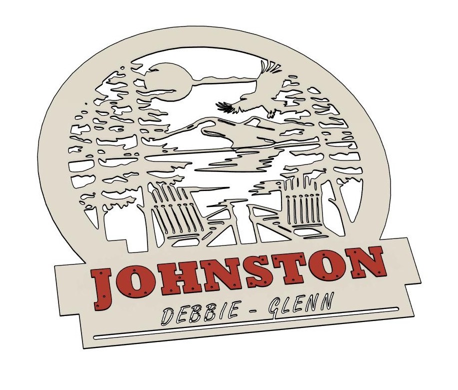

Regarding amount of detail, here is a sign that I am presently designing to give some perspective. Multi-layer red letters screwed onto background via threaded offset spacers (1/2”) welded to back of letters.
Any comments appreciated.

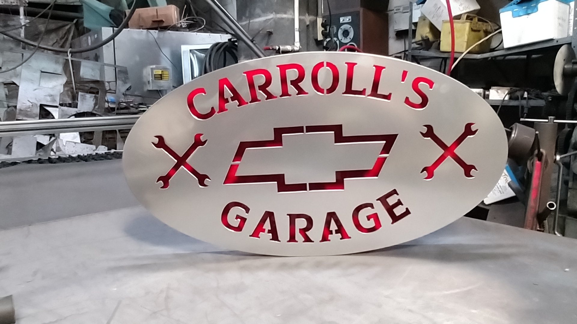

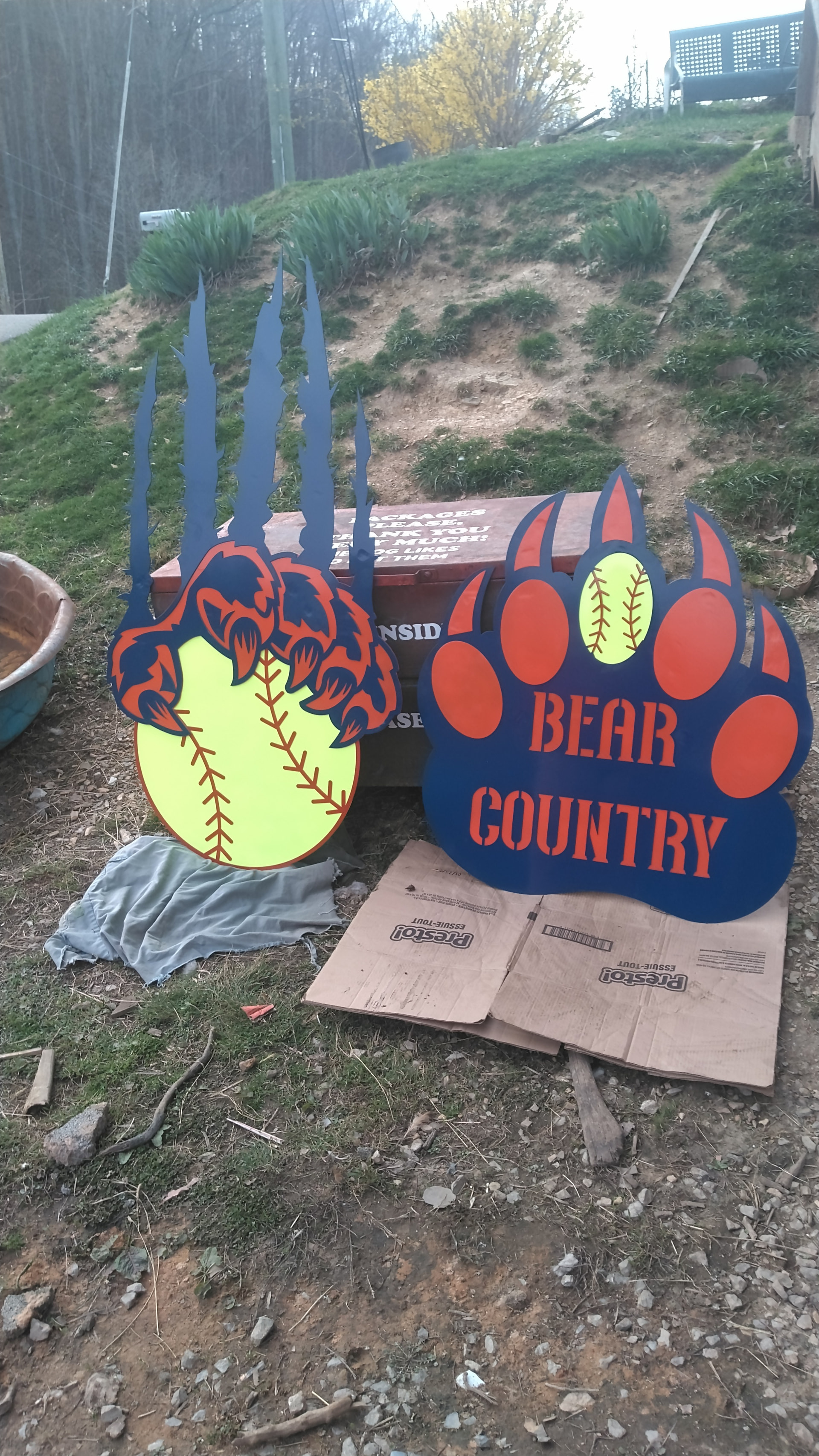

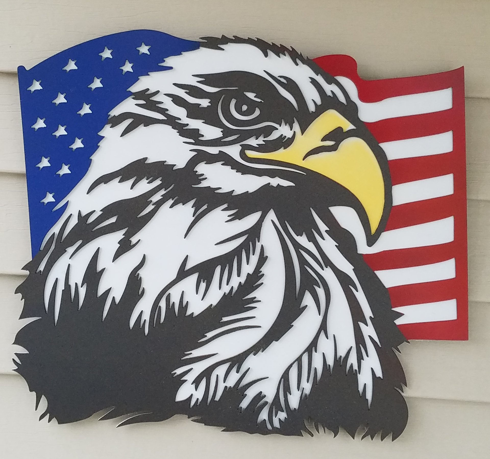

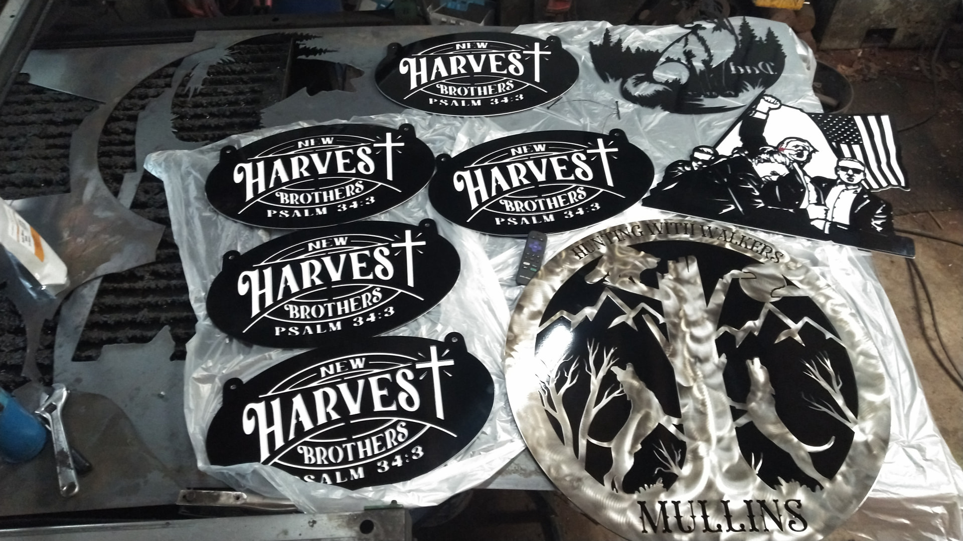

I do a lot of multi layer signs as well. One recommendation is to do a full size back plate so you get good color contrast with the entire sign. You can even do multiple colors. Here are a few I have done. I use mainly 14 gauge as well.
@Phillipw
A fair amount of detail especially in the “Mullins” sign. You get great contrast. Are these painted or powder coated?

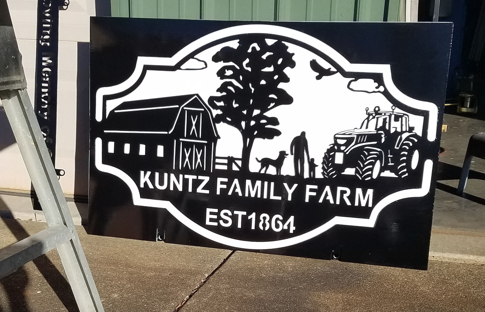

Keep in mind there is only around a half a pound per square foot difference between 14 and 16 gauge a36 sheet metal.
Feel free to change the text and re-use the top portion. I also made a hanging portion for across the bottom. You can see it standing against the garage door. That’s why the loop feature at the bottom were added.
Kuntz Farm Sign.dxf (1003.8 KB)
