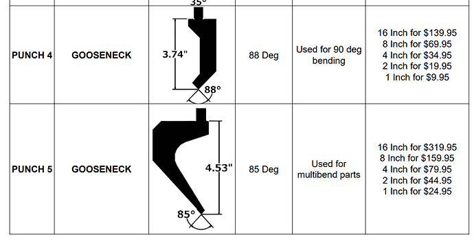

Material capacity of punches 1 thru 5?
What is the Maximum material capacity of the Punches they sell ?

@custommetalmke Does that mean you could bend at 25 tons with a small (~ 1" width) section of the Gooseneck punch (punch #5) without damage to the punch?
Tops are Punches. Bottoms are Dies.

Yes, but you still need to pay attention to the thickness of material you are bending. Always reference the tonnage charts before you begin. 1" bottom with a goose top you could safely bend 10ga anything thicker could over load the die. Also important to set your bottom. You can overload a die and punch just running it past the bottom. I’ll say it now though 25 ton won’t really do much damage to tooling.
Thank you for the information @custommetalmke. I have been going back and forth trying to figure out what punches to get. Going with the 4 way bottom die. I don’t plan on doing any acute bends in the near future. Mostly 90 degree bends for boxes and pans. Some “J” bends too (in thin AL) . I guess I’m not seeing a real reason to get anything other than the Gooseneck die for my needs. Mostly bending .0625 to .125 5052 aluminum and maybe some .125 to .25 steel (very rarely). Any thoughts?

Goose top and the 4 way bottom will get you about 90% of what you’ll ever need. My suggestion is make sure you are think about the flange sizes you plan on bending. You may run into a situation that the 4 way won’t get. Anything small than half the die opening plus 1/32" won’t bend. It’ll slip into the die opening.

Is there a use (or specific example) where the Gooseneck Punch #4 would be better than the Gooseneck punch #5?

Goose 4 is for 90° bends and goose five is for deeper pan bends where the punch can avoid contact. 4 is more useful in my opinion for normal bending.
Do you see any reason why I couldn’t use the Gooseneck Punch #4 in the opposite direction that it is shown? Turned around 180 degrees so the punch points away from the operator. It seems the tip of the punch is aligned with the center of the tang.

You can reverse a goose. The tip is still center of the die. Most of the time the goose does mount in the opposite direction from what the picture shows. The picture shows a reversed goose.
