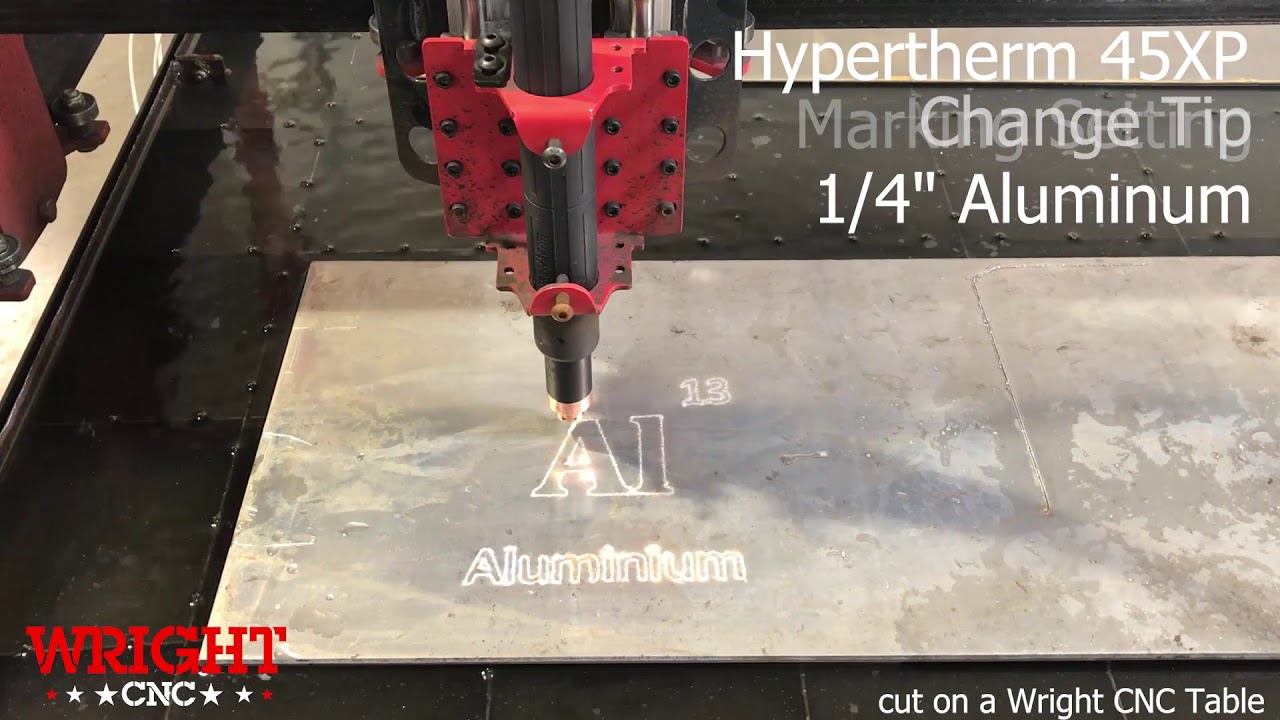

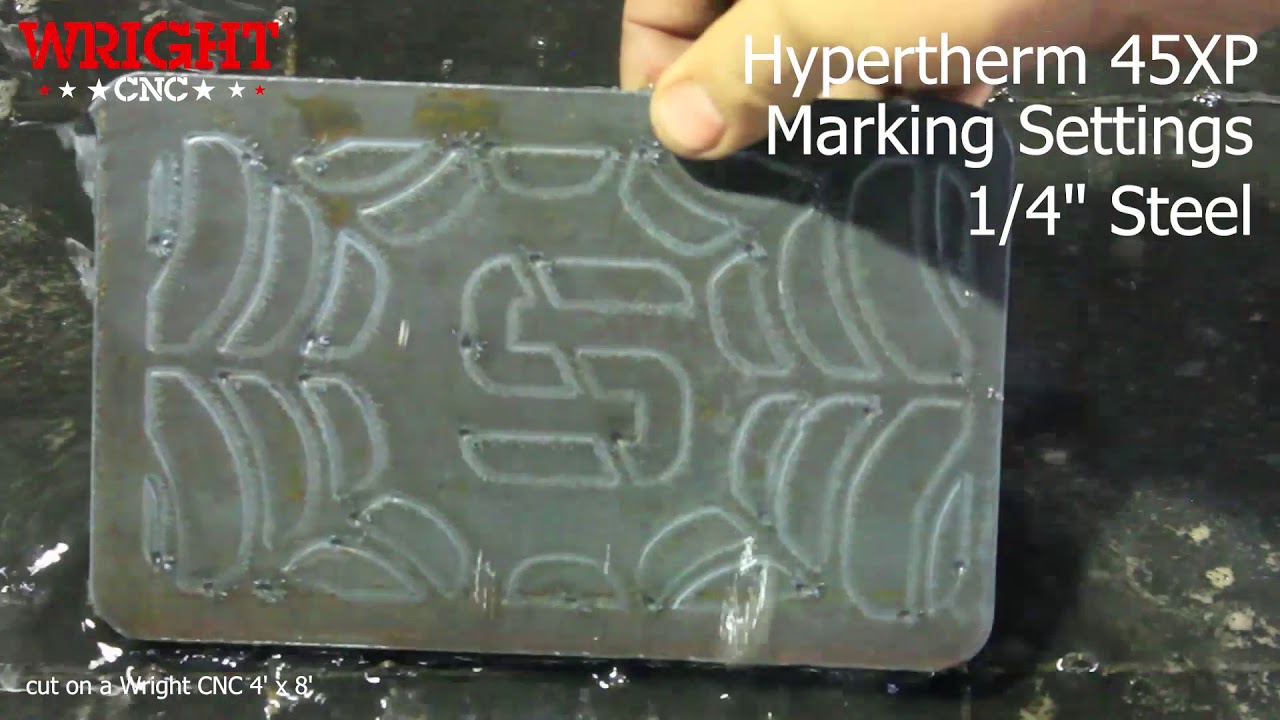

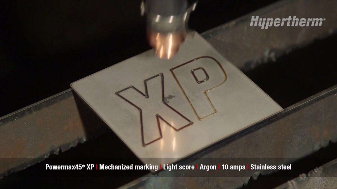

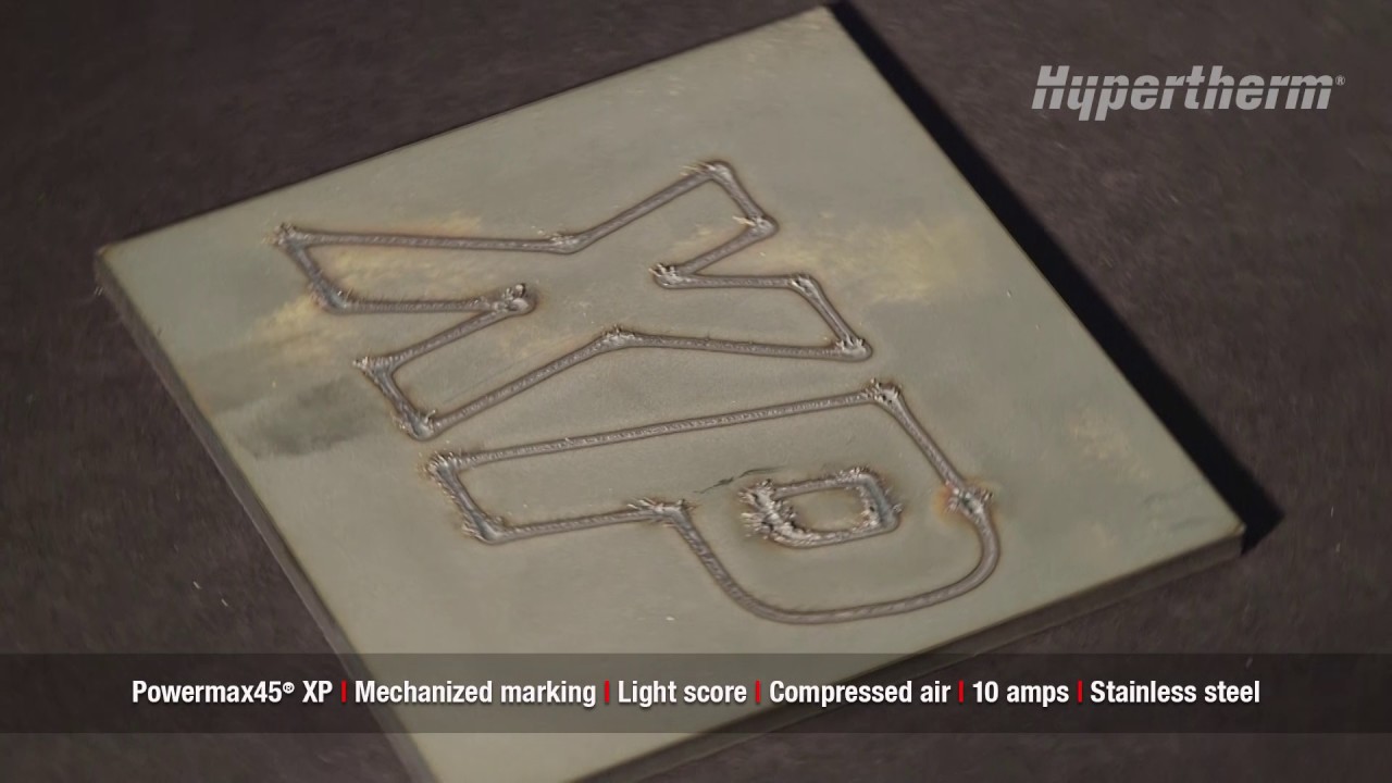

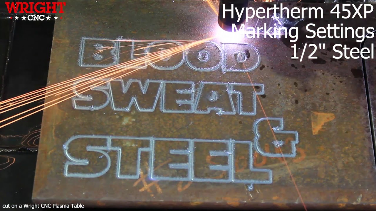

Here’s a couple YouTube videos about marking. @Teknic
Once I get my new hypertherm 45XP in my hands I’d like to start trying to do some of this
That top video, Argon on SS looks gorgeous. I’d love to see Argon on like 14/16g after cleanup to see depth and stuff.

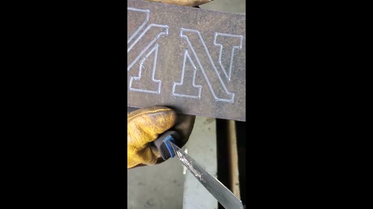

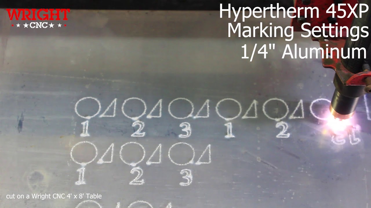

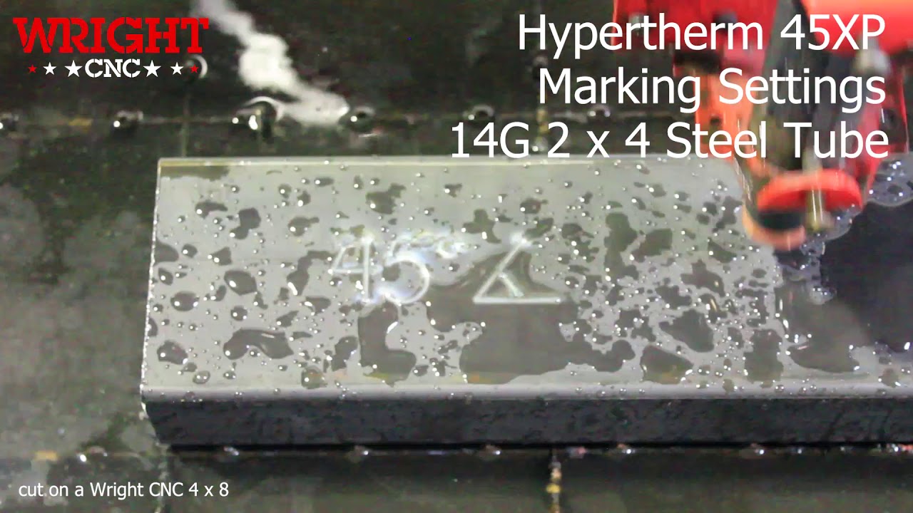

More videos

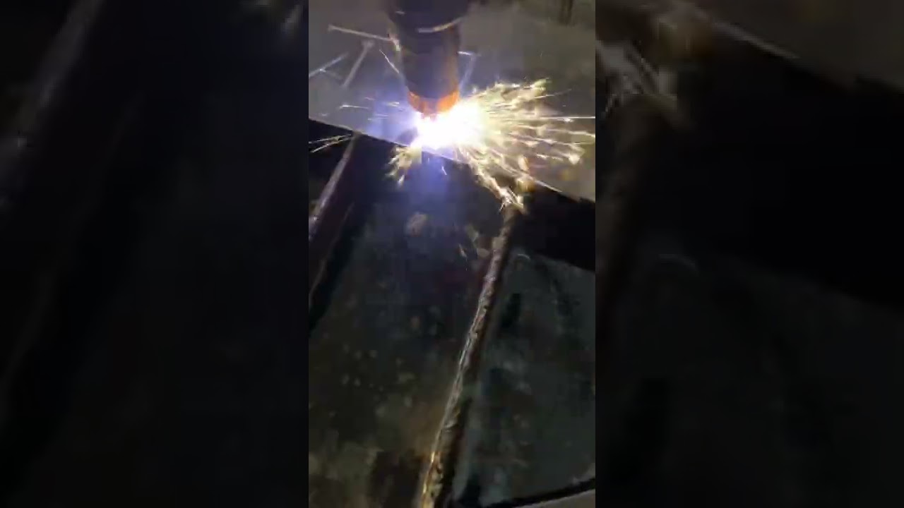

Video of second marking attempt.
.3 Pierce Delay (probably .05-.1 too slow, need to bump slightly, initial pierce makes a large divot now)
slowed to 90ipm and it looks much smoother in the gouge mark
The S is now smooth in my drawing so it cut smoother, and I put the ground directly on the piece (totally forgot last time since I’m just using a scrap piece lol)
I saw previous guy mention he ran at 111V, I just turned THC off so no voltage setting just cut height.
For cleanup I’m going to do my regular procedure, drop in vinegar tonight and take it out tomorrow then I’ll sand. I honestly think it’s gonna be pretty smooth.
This is all with just air NOT argon yet.
