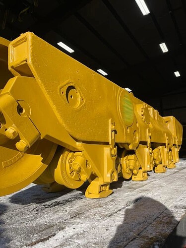

Made a deal with the company to start a new style bracket. Much more satisfying than signage.
Very satisfied with the cuts. This is 3/8 plate cut a 65 amps 35ipm that is 20% under book settings. Now off to the concrete mixer for a quick tumble.
That looks like links to a chain or bucket conveyor. Very cool. That is some heavy plate you are cutting.
It does look similar doesn’t it. The company I work for has a complete rebuild shop for heave equipment. These plates are just temporary tie downs to make transport easier.
When they ship a undercarriage most mechanics on the jobs don’t care if they get sent back.
Here is a picture you can see they hold the bogies on the undercarriage from dropping down.
@ChelanJim it is a little bigger than the bobcat picture you seen oh Erik had to witness that one too. ![]()
